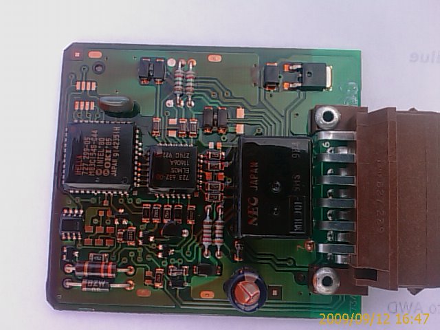

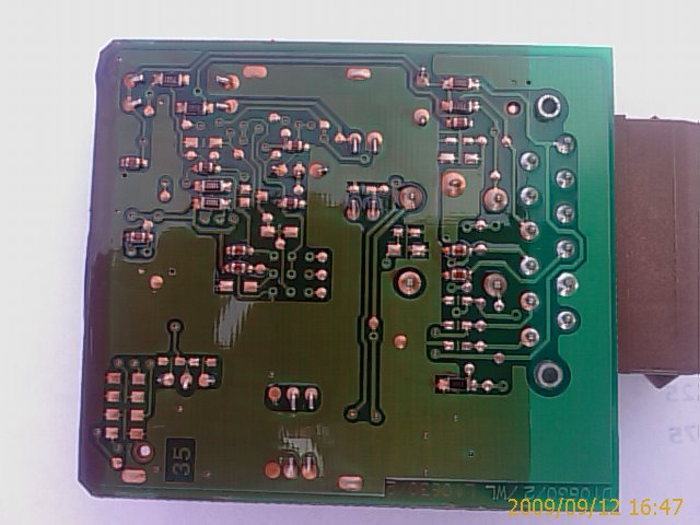

Default Cruise control unit opened
Dear guys, thank you for your participation and discussions. Finally i opened the cruise control unit to check soldering quality. I followed advise on nm3210, i was a little surprised since my unit looks different. Another chips, capacitors, triods etc. Please see pix. I checked thouroughly every line -no damage or smth disconnected. So, i guess my next step should be checking the lever where cruise activation controls/buttons are. I expect your advices or links how to handle this. Thank you.

Yeah, i thought that might have been the case. You can test whether or not the stalk is working from the cables that run to the module there (so you don't have to take anything apart). Obviously if that module isn't getting the right signals - it's not going to work. I don't know which contacts mean what off hand, but I know that there was something about it somewhere, i'll try to look...
