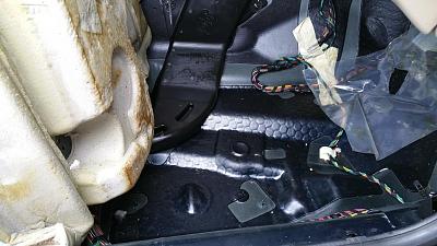

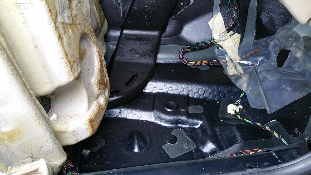

Thanks for the info. I lifted my carpet and didn't find the TCM at all. I have 2004 Audi A6 with tiptronics and from what I read it was suppose to be on the ground under the carpet in a box?

Follow those wires, there should be a black box. Your pictures show where it should be, keep peeling back carpet towards seat. Is your a6 still a c5? The c5 runs up to 04 but halfway through the body was changed. Don't give up its down there,

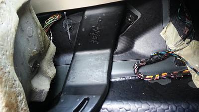

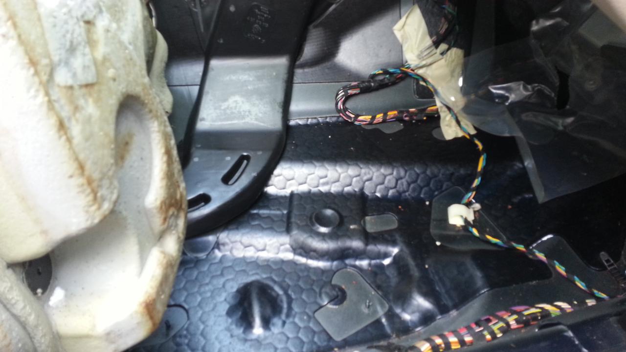

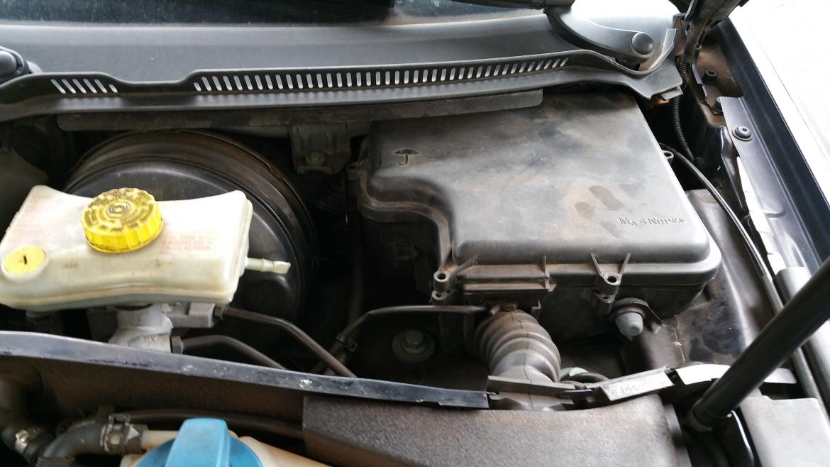

Been out of town for a little bit and now I am back to getting this taken care off. I have still not located the TCM. It wasn't underneath the carpet like I keep hearing. Could it be under the seat and I have to remove it? What is the computer that is on the right side of the engine that I have shown in the picture?
