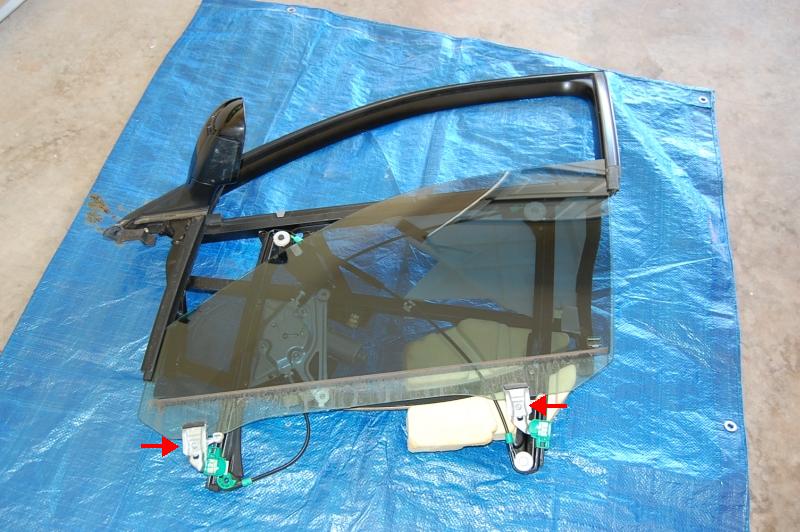

It shouldn't be any mechanical device/part that comes in contact with the glass itself, exactly as the dealer stated.
However, if your plastic guide(s) is (are) broken and the cable doesn't glide through its channel (jumped over), it is the possibility that it may rub against the window.
On older models, the regulator attaches to the window via a big plastic retainer/fastner:
On newer models, the regulator attaches to the window via 2 small plastic "guides":
You be your own judge as far as what mechanical part can rub against the glass.
