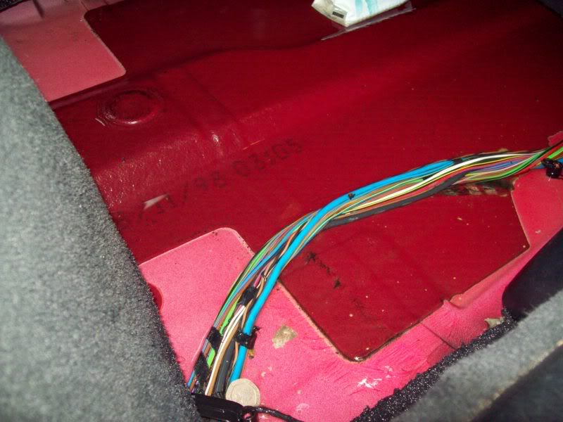

Nothing I do makes any difference to the water leak situation, and the rear of the car is swimming again after rain last night. I had mopped the floor dry last night to check the water ingress and it's still huge.
As such, I haven't got the time or money to start replacing door seals, window seals etc. on a speculative basis in the hope that something might work. I have now decided that the best course of action is to drill some drain holes through the floor, treat them with anti-rust replace the carpets and either: a) Get rid of the car and go back to a Ford or Vauxhall, or b) wait until the spring when hopefully we'll have a bit more cash and fix the leak, then weld up the drain holes.
I think that the floor is double-skinned and so I don't know what's going on between the skins. Does anyone know if there is a safe place to drill through where I won't hit brake lines / cables etc. etc.? I'm thinking about 4x holes at around 6-8mm should be sufficient to drain it, and a darn sight cheaper than having to replace the ECU if it gets wrecked.

Pull up the carpeting and look for the factory drain plugs. They might be under some asphault sound deadening mats. Drill through one of these as they are the low point in the system. You can get a replacement at any body shop supply place. If you have to chip away at the sound deadening to replace the plug, use DynaMat or the equivelent to provide the sound deadening.

Went out to it today and surprise surprise, there's water in there again! I'm really p1ssed off with it now, especially since it has just passed it's MOT test with flying colours, but I'm still considering getting rid of it because of this issue alone. I think I will drill through the drain plugs - any idea where they are, as I can't see any sign of them apart from what looks like one on the top of the bulge in the floor, but that would be a bit of a daft place to put a drain surely??? I thought the audi didn't have drain plugs?
