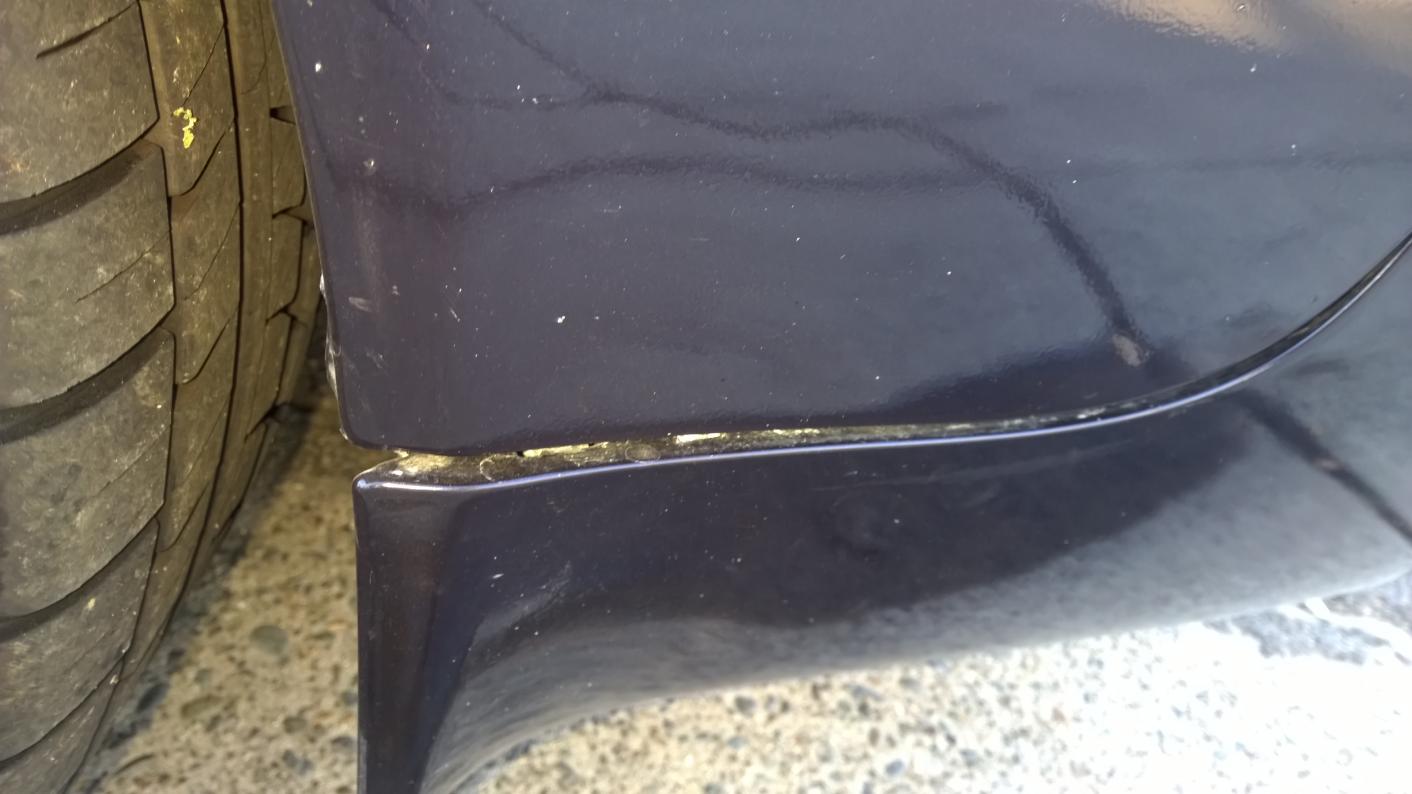

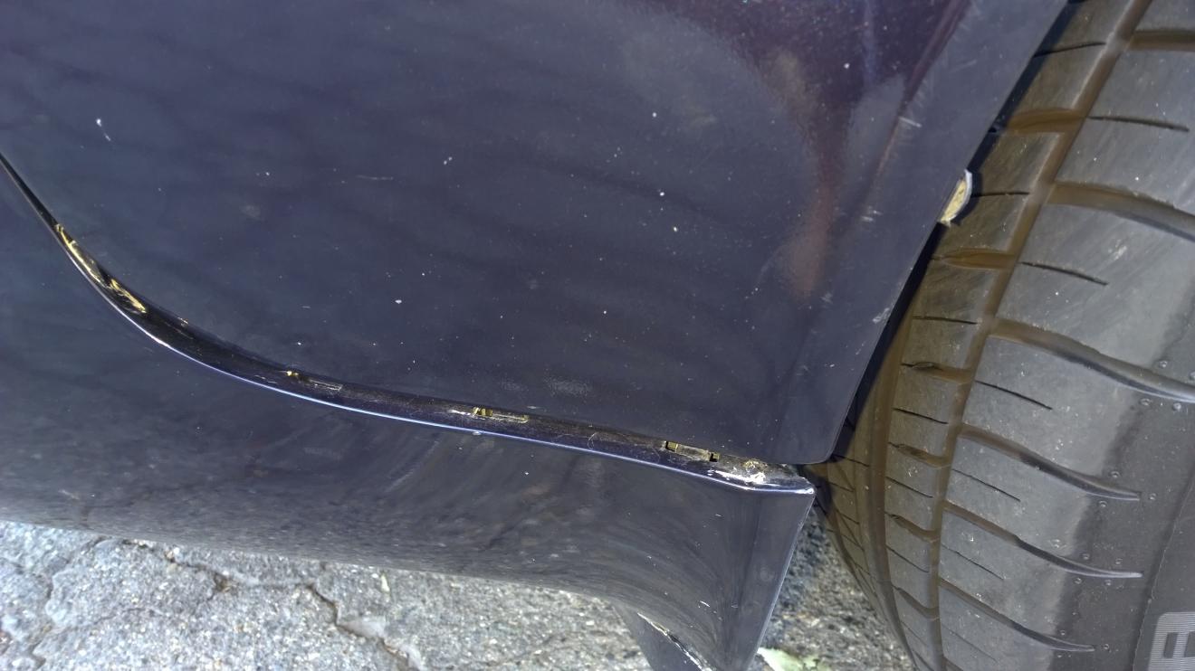

Default pictures of both sides
Can you put up a few pics of the misaligned areas?
I attached two pictures. And mind you, before I brought the car in for the timing belt change, one side was comely flush, and the other had a small area that was not flush (2 inches in length)
Attached Thumbnails timing belt changed... front end not aligned-wp_20140830_08_23_19_pro.jpg   timing belt changed... front end not aligned-wp_20140830_08_23_08_pro.jpg
Old Aug 30, 2014 | 11:37 AM
ImTheDevil's Avatar
Joined: Jul 2006
Posts: 11,670
From: Binghamton, NY
Looks like it's just not clipped in. You may be able to pop those in just as the car sits. Worst case the bumper needs to be unbolted and then remounted. As long as the attachment points aren't broken that's a quick fix.
