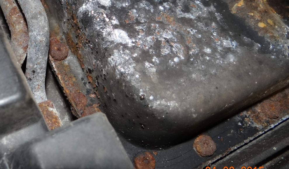

Why did Audi think it was a good idea to use Torx bolts for the transmission pans, when they inevitably rust and end up as a head with a hole in the middle, needing heroic measures with Dremels or Vise Grips to remove. It seems the decision was made mainly for convenience of assembly.
I was all set to replace the filter, but seeing the silly condition of the bolts, decided to hold off and just did the drain and fill, because I surely wasn't going to reuse these. They may as well have used pop rivets to secure the pan, would have been easier to grind off.
Are there clearance issues that required the use of the internal Torx, instead of some run of the mill hex headed bolts?
What are the specifications for length, thread pitch and diameter for the pan bolts?

M6x20- thats the size on my b6 2002 a4 1.8t tiptronic. I just replaced my filter and fluid successfully. About taking the screws off, spray penetrating oil on the heads and the opposite end of the screw(MAKE SURE YOU LET It SOAK IN FOR A WHILE). Idk if i missed something idk what model you have but i noticed on mine the the screws stick out of the hole on the top side. This leaves it exposed and causes rust and it's the worst there since it actually gets into the threads, making it extremely tight. I stripped one of mine, ended up using a screw extractor, but even that wouldnt have worked without penetrating oil(i used liquid wrench). Use the plastic tube from a bottle of penetrating spray to get to the top side of the screw. I ended up spraying excess so the oil would flow onto the threads since it was such a tight space. It makes a whole world of difference. I actually ended up stripping it with the screw extractor too and had to move up a size on it, penetrant on the right spot was the only thing it needed. And if you strip it with t27, hammer in a t30. Also, you might need impact bits. My screws were so tight that my bits broke and the screw was still intact. I ended up buying an impact rated torx set from autozone, about $14, well worth it.

2000 A6 2.7 Quattro; never did bother dropping the pan; still left it alone with just a drain and fill service.
It was such a corroded sight I didn't want to mess with it, and I'm sure it looks no better with 3 more years.
