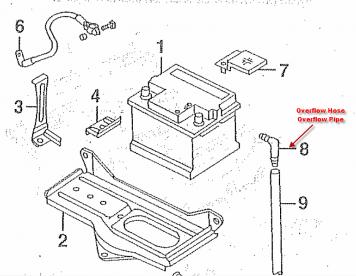

Old 07-24-2011, 05:05 AM
bigdadi's Avatar
Join Date: Sep 2010
Location: Boston MA
Posts: 409
Default Battery Overflow
Old 08-10-2011, 08:36 AM
Ploplen's Avatar
Join Date: Oct 2010
Posts: 17
Where did you get the picture?
