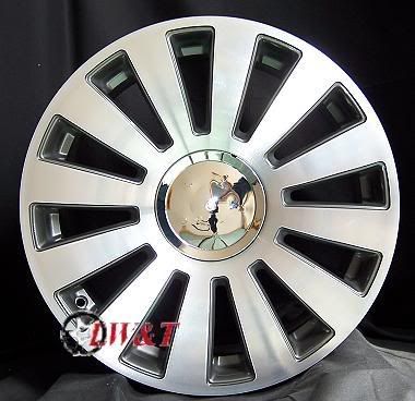

those rims in the first pix are the 17x8 (5x112 bolt patter) with ET35 offset.
If you have a A6 4.2, you should probably be ok with an offset of ET35 or ET30.
