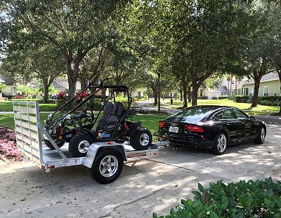

I was a little bit worried using the trailer from U-Haul, plus they look horrible I did attached that trailer to try it and it felt heavy, the card was ok pulling but not sure if is the quality of the trailer or what, but it didn't feel right.
So I went ahead and purchased an aluminum trailer, expensive but really good, see the picture attached. The Aluma trailer is just 390lbs and fits the Buggy perfectly, in total I'm towing 1040lbs, which the car seems to be pulling without issues at all.

Can you share any closer-up pics of your car with the receiver removed? I'm trying to get a feel for what it looks like when you aren't towing.
