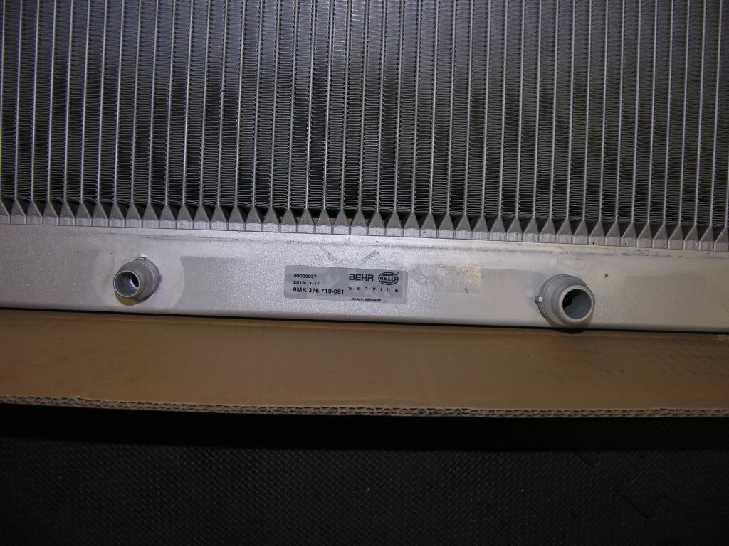

Where are these clips installed? On the top, sides, or bottom of these hoses? I see hex-shaped collars on the radiator side. Perhaps, the clips are hidden under them? If so, do they slide or turn?

Diskman - This pic should help you out. It shows you what the clip looks like and how it pops up. You can also see the residue where mine was leaking. Don't have time to do the write up now but let me know if you have any other questions.

Here is the new one with the part number:
