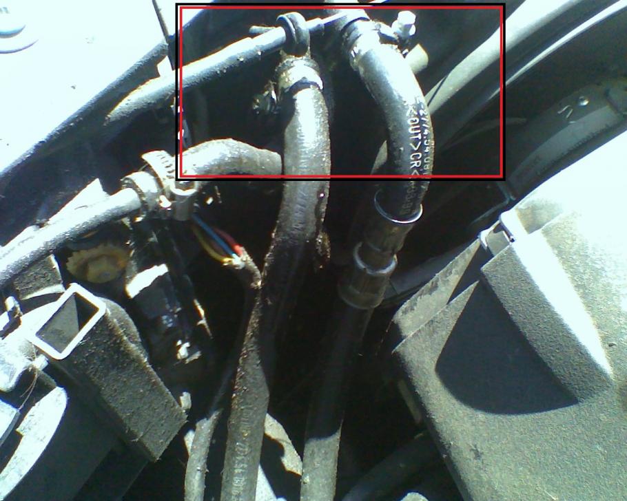

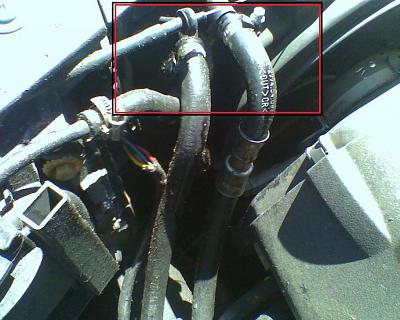

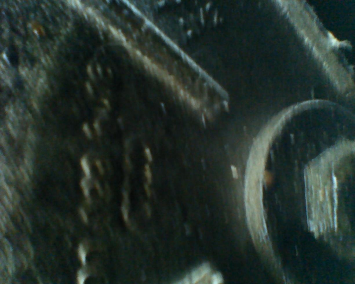

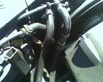

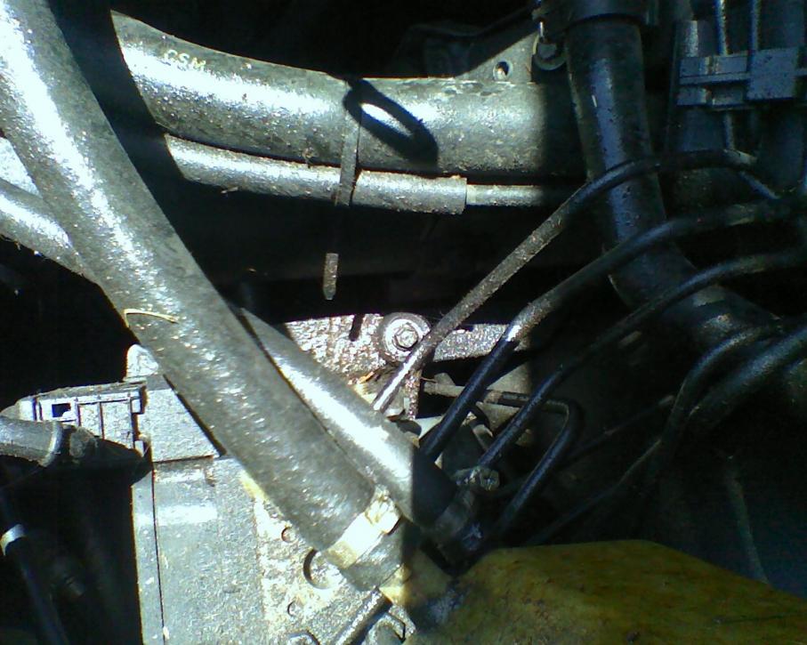

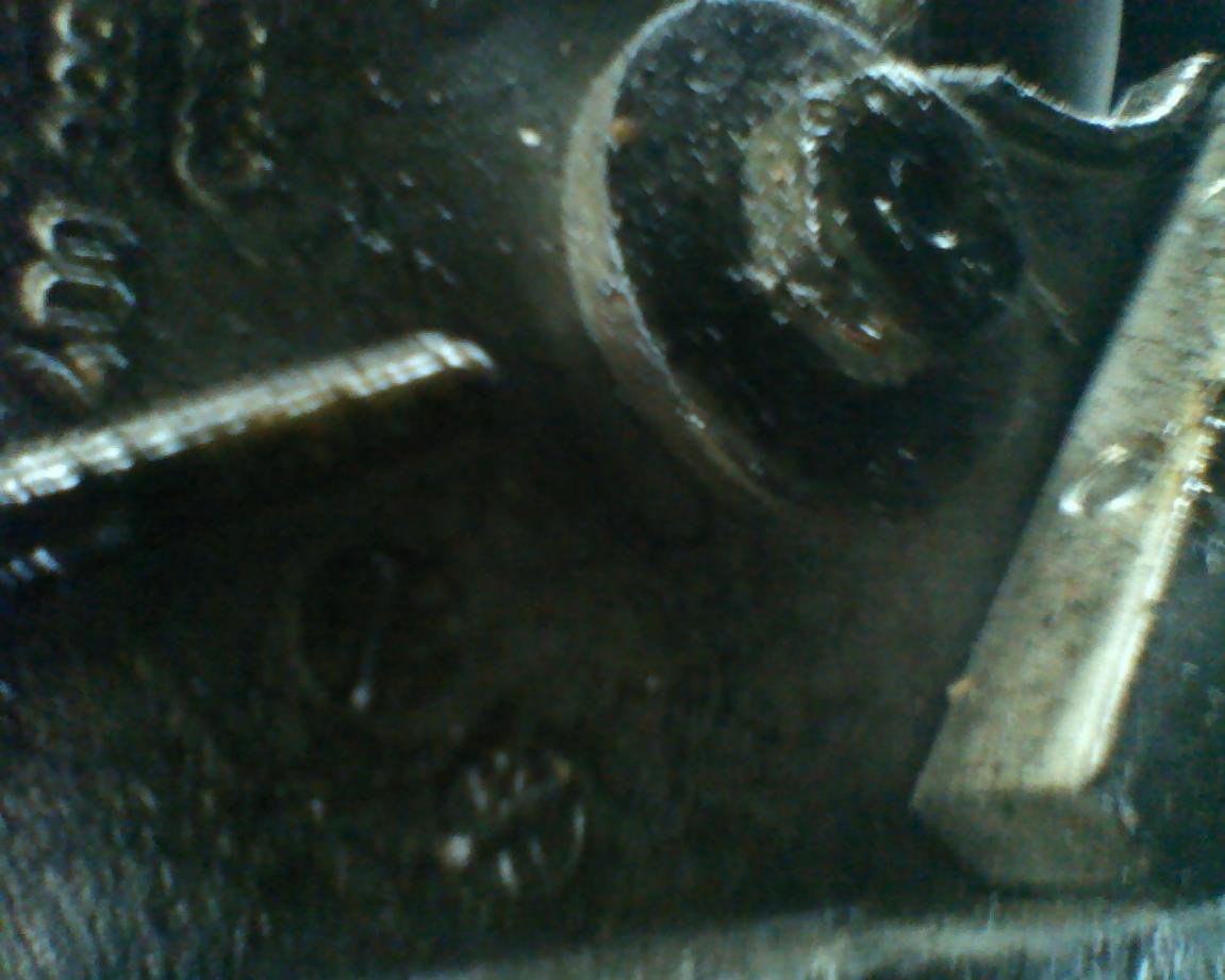

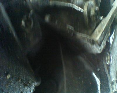

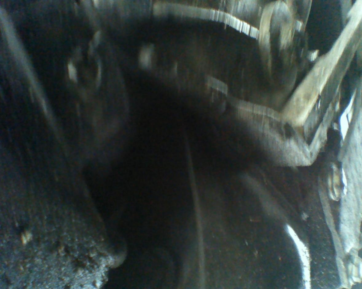

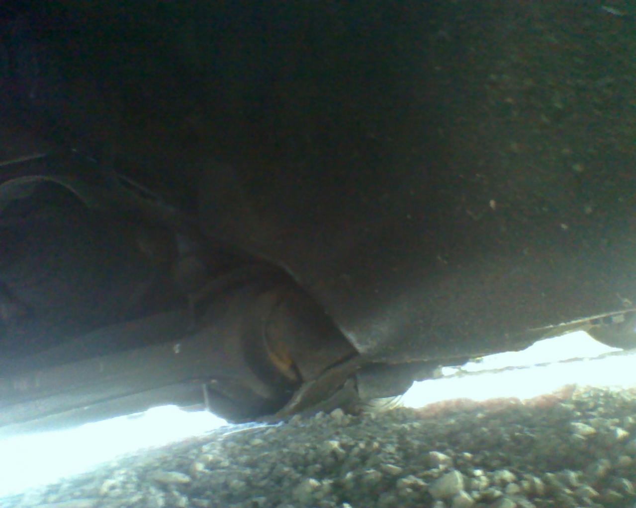

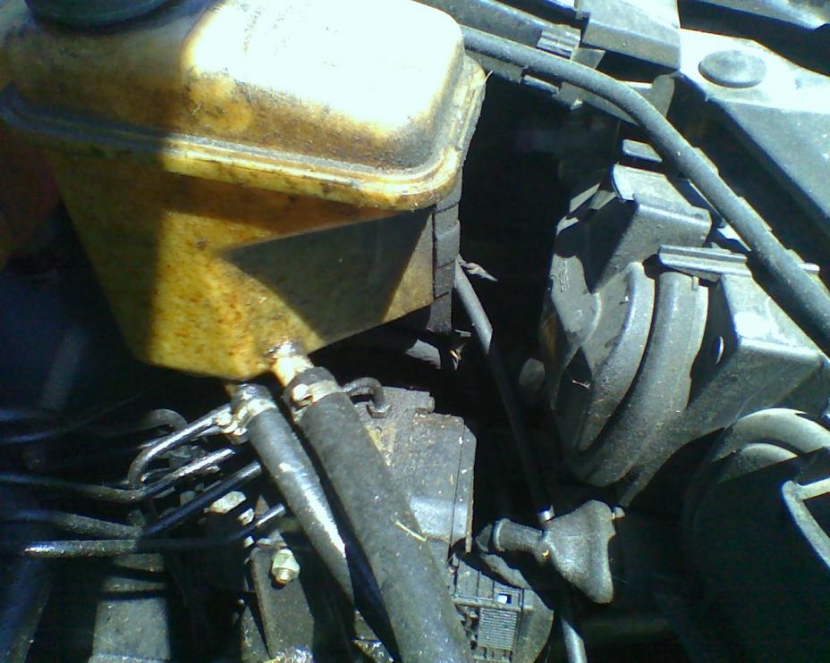

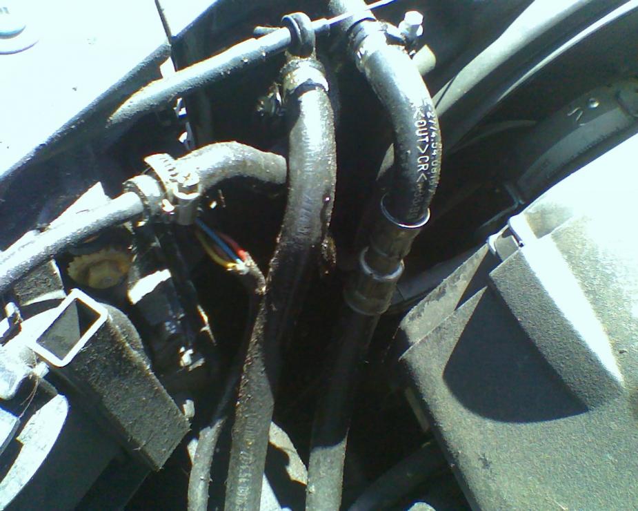

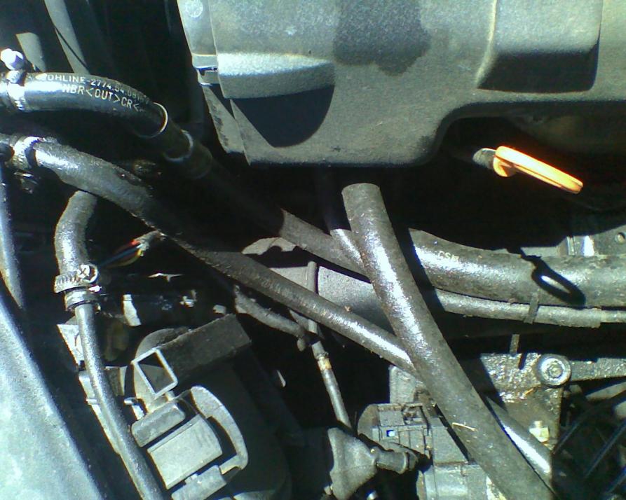

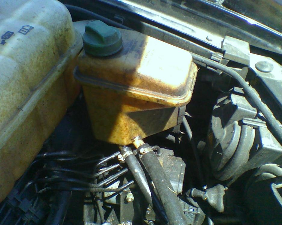

.....also, I noticed that there was some kind of fluid all over the driver's side of the engine, under the car and all the way to the transmission pan......
I took some pics, quality is kinda bad because I took them with my crappy phone...
......it was transmission fluid.....
........continued....
Here are the next pictures, in one of the pictures I selected the hose/hoses where apparently transmission fluid is leaking.....
I took some pictures underneath the car, but pictures suck ( I just put my arm in and snapped away), but at least the transmission fluid can be appreciated all over the engine, and all the way under and to the transmission fluid pan.....
My friend (mechanic, very good one I might add, but doesn't work on vw-audi because he says they are a PITA) said that we can at least lift up the car and check how the fluid level is, and since it was leaking fluid, there has to be fluid missing inside the transmission.....how much???? well, I we will find out as soon as we do it....... will try to do that tomorrow....
...........could it be just low transmission fluid??? (I am on my knees, (praying, I might ad, hehe))
know........waht kind of fluid should I use to top off?????
Can I use some cheap stuff or any comparable fluid??
"I will only test the transmission by adding fluid, and if by some miracle the car runs good, if it does and its only a low fluid problem, I will then immediately take out the oil, remove the pan, change the filter and ad new oil (as explained on audipages) and get the leaks figured out........"
All your input is greatly appreciated...
cheers!!!
......or just find out for sure the transmission is blown and need a new one and/or a repair
ALSO, I would like to add, that I took the car for a spin, and the reverse is slipping as well, not much but you can definitely fell it just a tad..........and you can hear a very very soft grind under the car where the transmission is......it lasts for about 2 seconds 3 max and then goes away...
cheers!!!
I haven't studied this trans yet, I have studied the 4L60E from GM, and often when you see a problem in D but not R it is one of the 2 planetary gearsets broken.
Problem with an automatic, if something is broke, it quickly sends metal fragments everywhere, and with the very very thin clutches it often destroys the trans is very short order.
GM had some issues with the sun shell on the main planetary set breaking. The 4L65E got a 5 gear planetary gearset. Where the 4L60E got a 4. This helped a lot distribute the load and were much less common to cause issues.
So does it need to be rebuilt, probably, I hate to stay it. Check for metal fragments on the dipstick.
If you have easy access to the cooler lines, insert a clear fuel filter inline and run it for a couple min, then take it out and cut open the filter and inspect for metal shavings.
