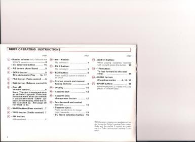

The center volume button is the on/off switch. Make sure the mode button is not lit. When lit, it plays your CD player. If it still does not work, you will need the code which can only be gotten from Audi.
See Attached.
