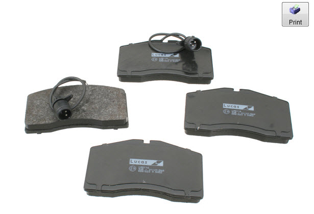

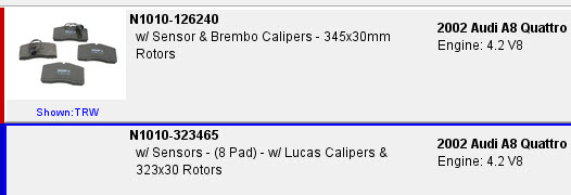

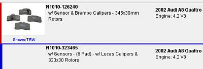

here u go
Attached Thumbnails Which brake sensors does my 2002 audi a8 have-frntpads.jpg   Which brake sensors does my 2002 audi a8 have-frntpads2.jpg

pads and sensors are one piece (you should have the top set in the pic based on what your dealer said) and they should run you $120-150 for oem
hope that helps

I have the 8 pad set. I am going to play it by ear. I might have to go to the junkyard to get a caliper (see new thread) and may see if I can find the other end to the cable.
