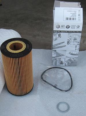

Parts:
1. Oil Filter *SEE NOTE*
2. Crush Ring
3. 9 quarts of Full Synthetic Oil (0W30, 5W30, 5W40)
**NOTE** I went to my local Audi dealer to pick up the oil filter from their parts department. This turned out to have been a very good thing, since, at least on the 2004 model year; there is more than one part number for the oil filter. You need to give your dealer your A8's VIN number, so they can give you the correct oil filter.

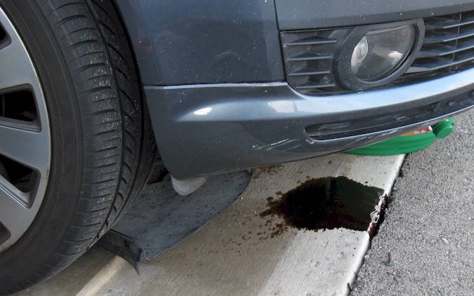

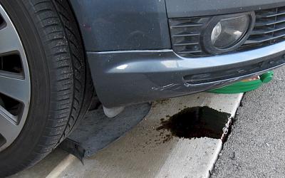

** NOTE ** if you have a garage with a small lip and down sloping drive way, all you have to do to prepare for the oil change is to back the car into your garage and go into the MMI to raise your suspension to its maximum height. This provided me with ample clearance to work with. (see pic below)

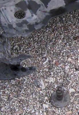

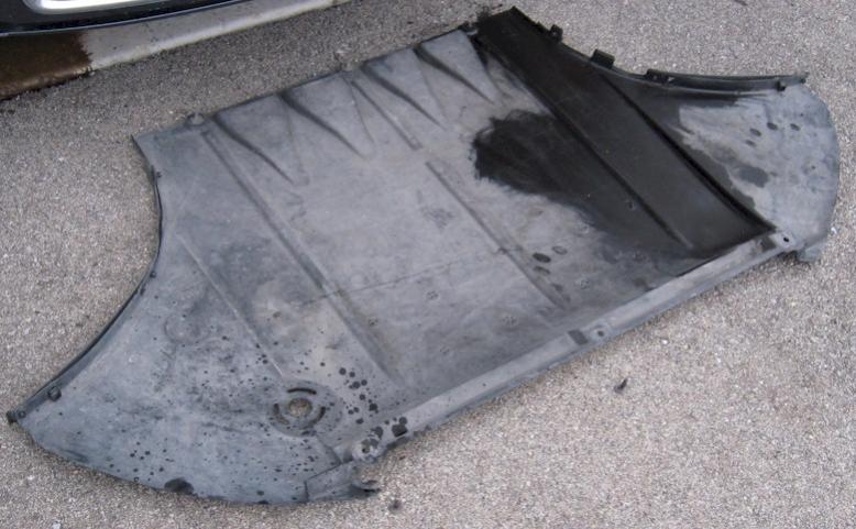

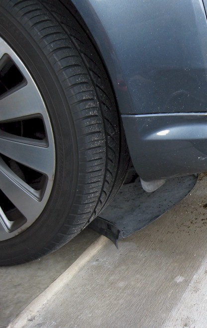

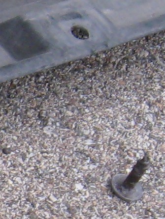

1. Remove the undertray by unbolting the six (6) quick release screws from the tray, using a stubby flathead screwdriver.
Undertray removed from car:
Undertray screw close-ups:

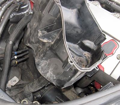

2. Remove air intake box cover, using a Phillips head screwdriver to remove the bolts that secure the cover.
3. Remove air filter
4. Remove bottom half of air intake box:
__a. Using a 4mm Allen wrench (hex key) to remove the bolts that hold it in place.
__b. Leave the snorkel/drain connected to the bottom of the air box, but disconnect it under the car
__c. Remove the bottom half of the air intake box and move it out of the way
Bottom of air intake box with 'snorkel':
Attached Thumbnails How-to: 2004 A8 Oil Change Procedure-img_1897_air_filter_airbox_cover_off_sm.jpg   How-to: 2004 A8 Oil Change Procedure-img_1883_oil_filter_location_sm.jpg   How-to: 2004 A8 Oil Change Procedure-img_1883_oil_filter_location_closeup.jpg   How-to: 2004 A8 Oil Change Procedure-img_1886_oil_filter_location_closeup.jpg
