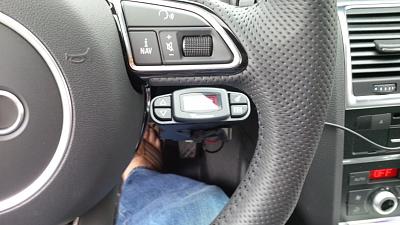

My next project is the removable mount for the Brake Controller itself. I found the connector I need, now just need to mount.
Wish me luck.

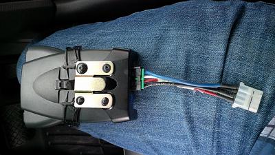

One step closer. I've wired a connector (plug you'd find on a computer power supply that connects to an old hard drive) so now I can easily disconnect my brake controller when not in use.
Wish me luck.
Wish me luck.

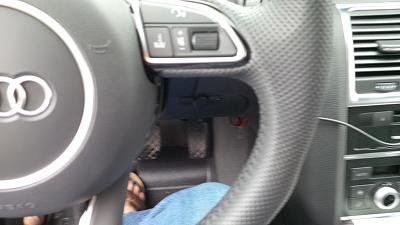

the reason I wanted this is I didn't want to damage the car and I don't keep the controller on all the time, only when needed.
Sorry about the poor quality pics ... if anyone is interested in the way I did this, I can take better or more detailed ones.
Cost of connections, $0.60
I painted it flat black for looks. $12 in paint
and I had liquid plastic to secure the second part to my break controller. $0.00
Oh and I also wired a computer power supply male/female connector (taken out of a dead computer) for easy connection ... seen in the last pic. $0.00
the wire running across from left to right if my dash cam power cord. Still need to wire that thing in also.
