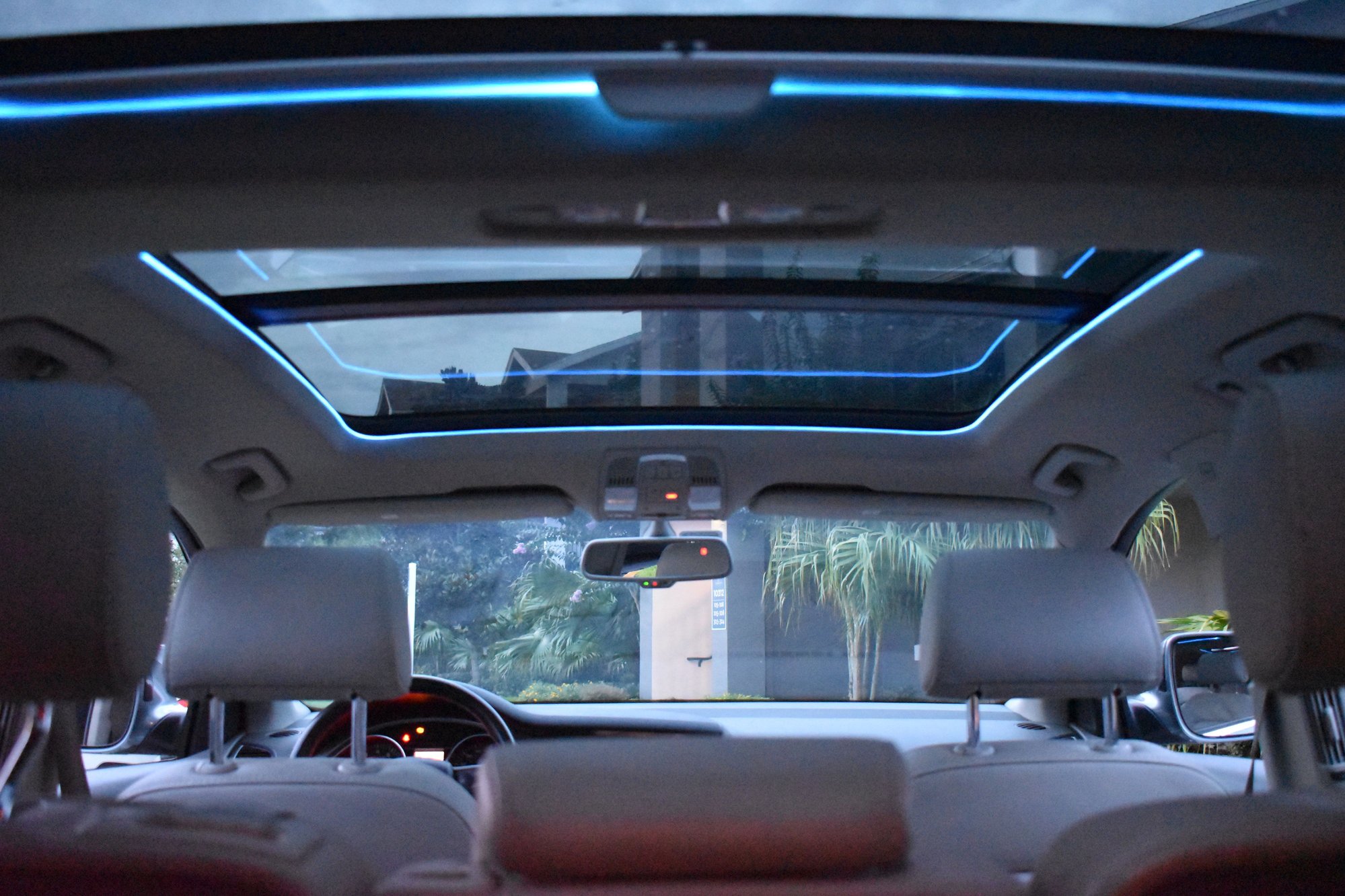

LED driven - optical line around both sunroofs (1 controller so always the same color) Bluetooth app controlled
Non invasive - snaps right between the sunroof support and the healiner - no glue or cutting

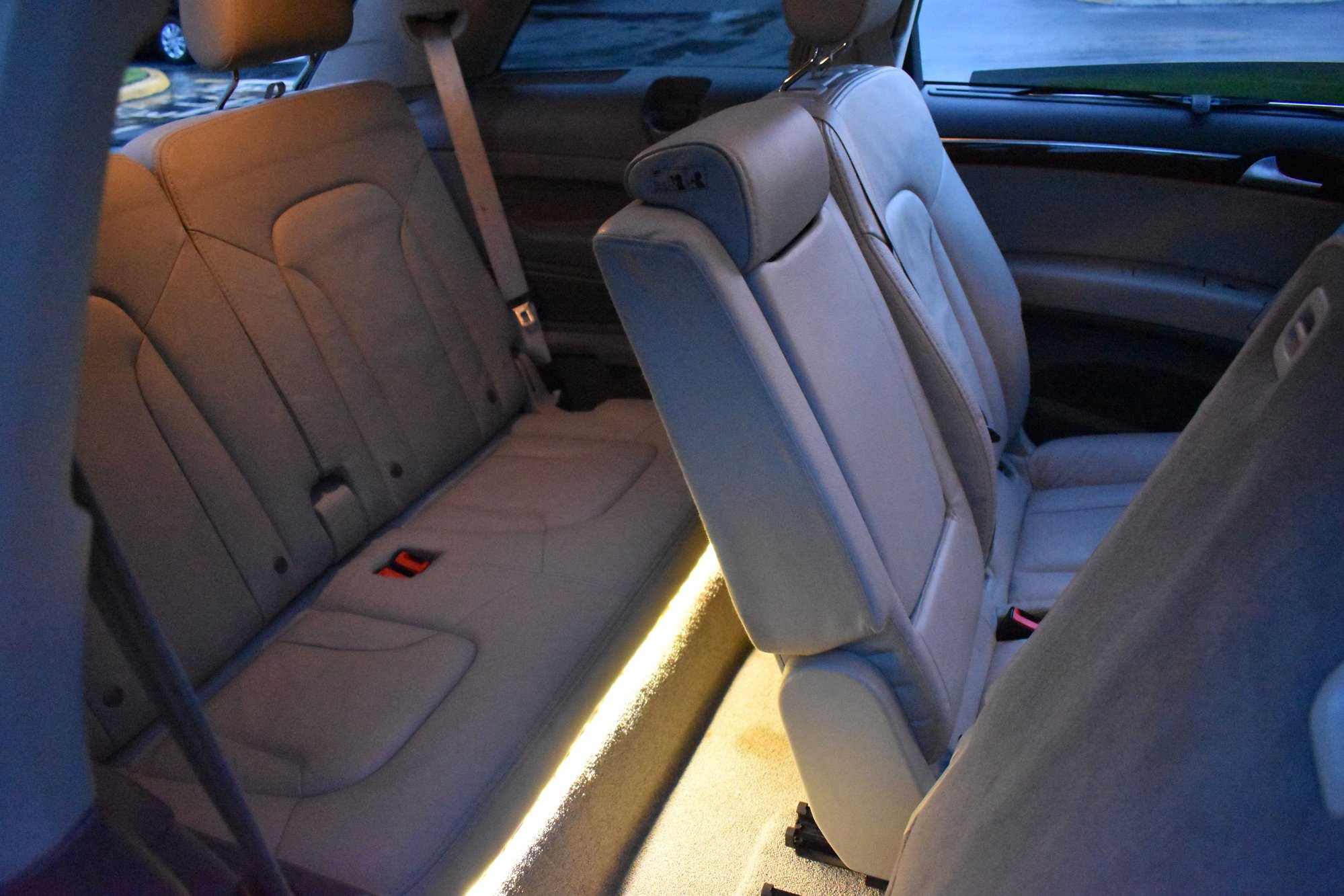

RGBW led strips under the 2nd and 3rd row, linked to the dome light output - so fade on and off with doors
3rd row has continuous strip.

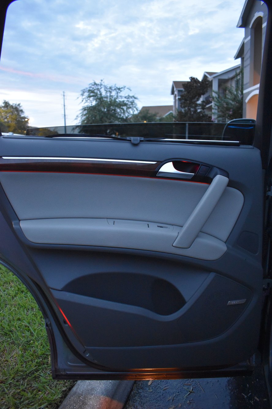

Door with EL wire on trim + LED in bin - lights off, wired to interior illumination circuit from door control module
Door with EL wire on + LED in bin - lights on - dim with dash illumination dimmer
Door with EL wire on + LED in bin = door closed

Headliner lighting when off - visible plastic tube but no lighting or color - fits nicely at edge of headliner.
2nd row - LED strip glued to support rail under seat cushion - Purple (colored LEDs) shown here, white LEDs are off but glowing from reflection.
2nd row - LED strip glued to support rail under seat cushion - White LEDs active (door open) but colored LEDs still on dim (circuit on with key, off with key)

The "fiber optic" strip around the pano roof is this one - https://www.ebay.com/itm/6M-RGB-LED-...NA2:rk:10:pf:0
It can be cut to any length (plastic tube) and comes with 4 LEDs to put at the ends. I found that the larger roof opening benefited from a light on both the beginning and end of the plastic tube while the smaller sunroof at the rear only needed one to appear at the same brightness level as the front one. I left the 4th led unused. The control box and LED's were all easily tucked behind the rear maplight unit which just pops out by prying. As for the strip around the opening - it actually tucks perfectly in the gap between the sunroof housing and the headliner - some pulling, pushing, wiggling and cursing required.
The footwell lighting is a special blend of this RGBWW strip - https://www.ebay.com/itm/DC12V-5M-SM...Kccg:rk:7:pf:0
And this control box - https://www.ebay.com/itm/WiFi-Blueto...XouQ:rk:3:pf:0
(cut at custom lengths per footwell, 5 wires soldered to each strip for R, G, B, W, +) The strips have constant 12v down the +, the W lead was fed from the negative output at the rear maplight unit (grounds when doors open) so they are tied to the dome lights, and the RGB wires were fed to the control box which was given +12v from the fuse block that comes on / off with the key.
If you're happy with the factory footwell lighting that comes on per door, then you can stick to a much easier version that's just RGB and comes with these premade strips - https://www.ebay.com/itm/9LED-Car-In...1dic:rk:8:pf:0
Either way, i mounted the control box in the spare tire well and ran leftover cat5 cable under the carpet to each footwell (since I needed 5 wires for mine and did the third row) but if you're doing the simple version, the drivers fuse panel has enough room to hide the control box and switched / constant power is easily found there.
The door upper "neon" looking strips are simple monochrome EL strips - https://www.ebay.com/itm/DC-12V-Car-...:rk:1:pf:0&var
The door bin lighting is a simple monochrome LED strip - https://www.ebay.com/itm/6-Pack-DC-1...r=431388524541
Pick whatever color combo you'd like, and both of these are wired to any of the 12v illumination wires feeding the door switches (meaning they dim with dash illumination and are "auto on/ off" )
For my rear doors i was able to use the 2 wires feeding the ash tray LED (just had to find which was + and which was - )
For the front two doors i used the lock/unlock switch wires (it has 4) but 2 of them are for illumination so there's your + and - (I forget the colors of the wires sorry )
