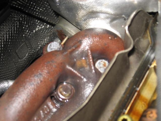

to take the head off with manifold do I just undo the three bolts? I have a pic I will attach.

here is a pic

yeah. Just the tree bolts from exhaust manifold to turbo and 10 head bolts and your head with the exhaust manifold comes out.

I just finished up repairs from my timing belt failure. Agree, easiest way to remove head is to remove the 3 bolts from the turbo, as shown in photo. These are external Torx style and they will be TIGHT.
