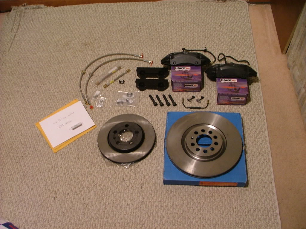

Here is what I'm bolting on next weekend:
* Mk1 Porsche Boxster (986) front calipers, Porsche parts numbers 986.351.421, 986.351.422 - they are Brembo 1pc 4-piston aluminum calipers, as opposed to the stock steel 2pc 2-piston calipers. I got them from German Auto Parts Distributors, an awesome source - 706-865-5200. Ask for Joe. I received the calipers in that condition
* (optional) 986 replacement hardlines and bleeder valves - Pelicanparts.com
* Pure Motorsports 986 carriers (with carrier to steering knuckle bolts)
* Hawk HPS pads (or whichever you like)
- Boxster front pad #: HB289F.610
- Audi 225TT rear pad #: HB364F.587
* (optional) SS front/rear brake lines (with spring clips) - ECS
* Boxster caliper-specific banjo bolts (different thread pitch than VAG) - ECS
* New plain, vented replacement rotors for 225 - I will have to see about braking bias, if I need more rear I'll get slotted rotors or a proportioning valve - MJM Autohaus (cheapest I could find)
* Brake fluid - I'm going to use Motul RBF600...I was going to use ATE Superblue, but that will eat up seals - I'll also remember to bleed the clutch!
Its way cheaper to go this way then to use the Neuspeed kit, because after you spend $470 you'll still need the calipers ($400+ for worthwhile ones). With my upgrade the only necessities are the ($400) calipers, the $175 PureMS adapters, and the $10 ECS banjo bolts. I'd argue for getting new front rotors too, but it depends on how budget you want to be...

* Mk1 Porsche Boxster (986) front calipers - $415
* PureMS 986 carriers - $175
* Hawk HPS pads:
-- Boxster front pad - $95
-- Audi 225TT rear pad - $50
* SS front/rear brake lines - $150
* ECS banjo bolts - $25
* F/R rotors - $160
* Motul RBF600 - got 3 half-liters for $40
* (optional) 986 replacement hardlines and bleeder valves - ($180)
Total: $1110 (or $1290) for F/R brakes
I'd say thats fair, and if you subtract the rears, you'd save rotors ($90), pads ($50), lines ($60), or $200, which puts the my front upgrade, equivalent to the Wilwood kit, at $910. The price difference is negligible, and I get a single-piece caliper instead of the 4(?) piece Wilwood, and I'm fine with the stock 12.3" plain rotors. I know the Wilwood is billet, but Porsche is known for its brakes, and they will be easier to source parts for. I'd say its a toss-up...I'll let you know once I brake the Hawks in

Yea, the 986s have a retainer spring/pin that makes changing pads very easy as well...I wanted to get a nice DD set-up for now, and plan to upgrade to the ECS 2pc (or similar) once I start tracking the car
