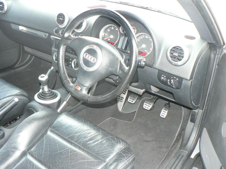

Default up dated photos for the TT

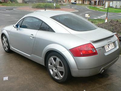

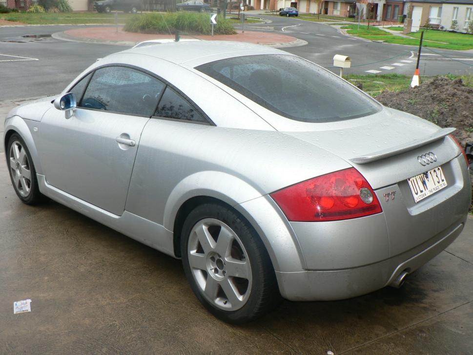

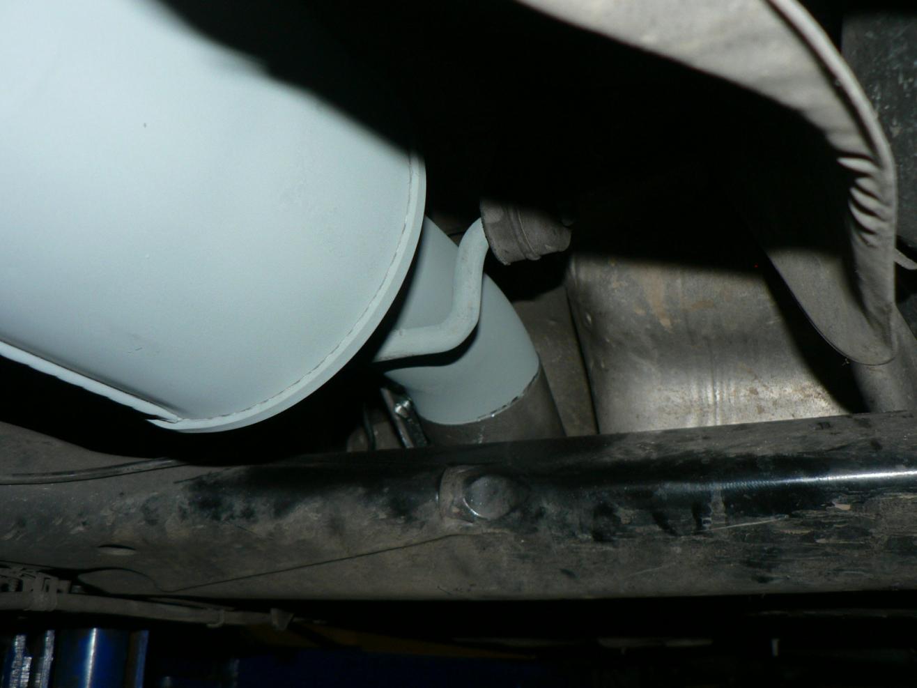

Good find.
Its so weird seeing all the controls on the right side.

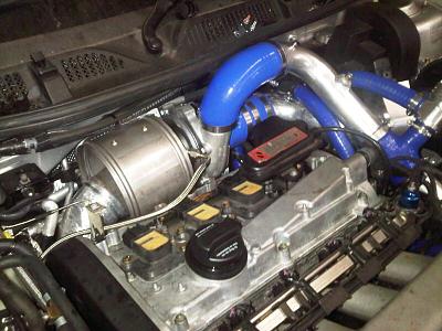

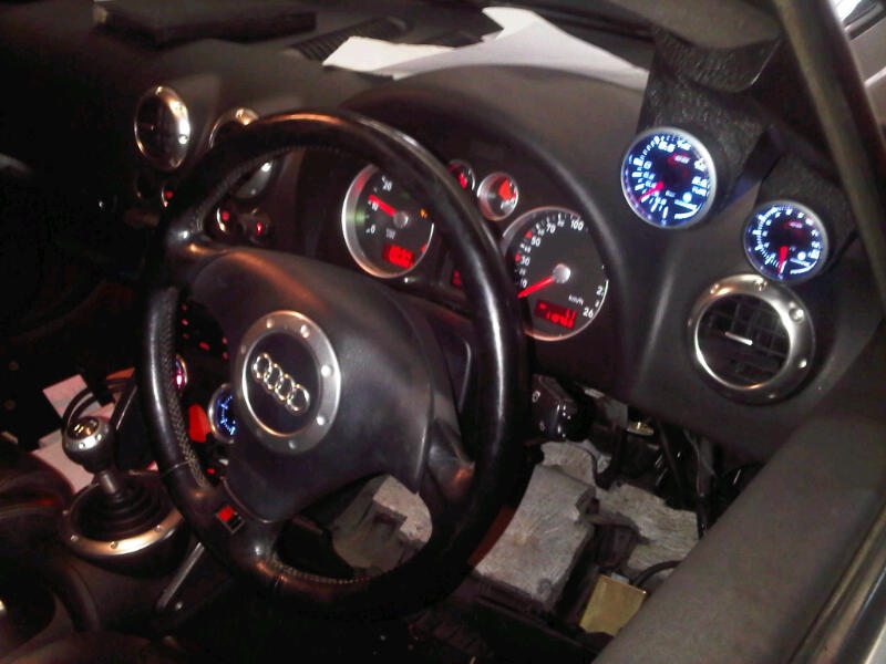

Hi All

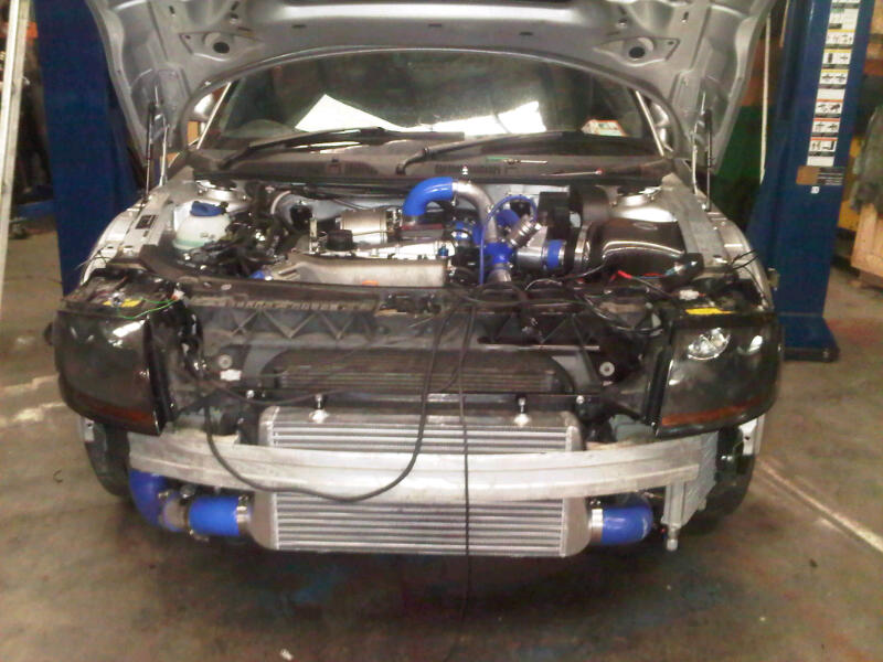

Just posting some photos of the rebuild im doing on my Audi
should have around 400 + HP after the revo tune and dyno
Have listed the engine goodies so far
Je forged pistons
scat rods
Gt3071R garrett turbo
Hi flow exhaust manifold
Big FMIC 3" piping
19 row remote oil cooler
Coolingmist water meth system
Ported head on the exhaust only, and flow benched
supertec racing valve spring set with titauim retainers
ralco allow pulley set
Stage 3 solid clutch kit
walbro 225 fuel pump and adustale 5 bar fpr
3" down pipe and 3" system turbo mufflers
Rc 660cc injectors
Gizzmo boost controller
3" turbo intake and 3" maf Simoto carbon aircleaner
Forge bov
Revo stage 3 tune on the ecu
vibra technics engine mounts
Cheers Bruce

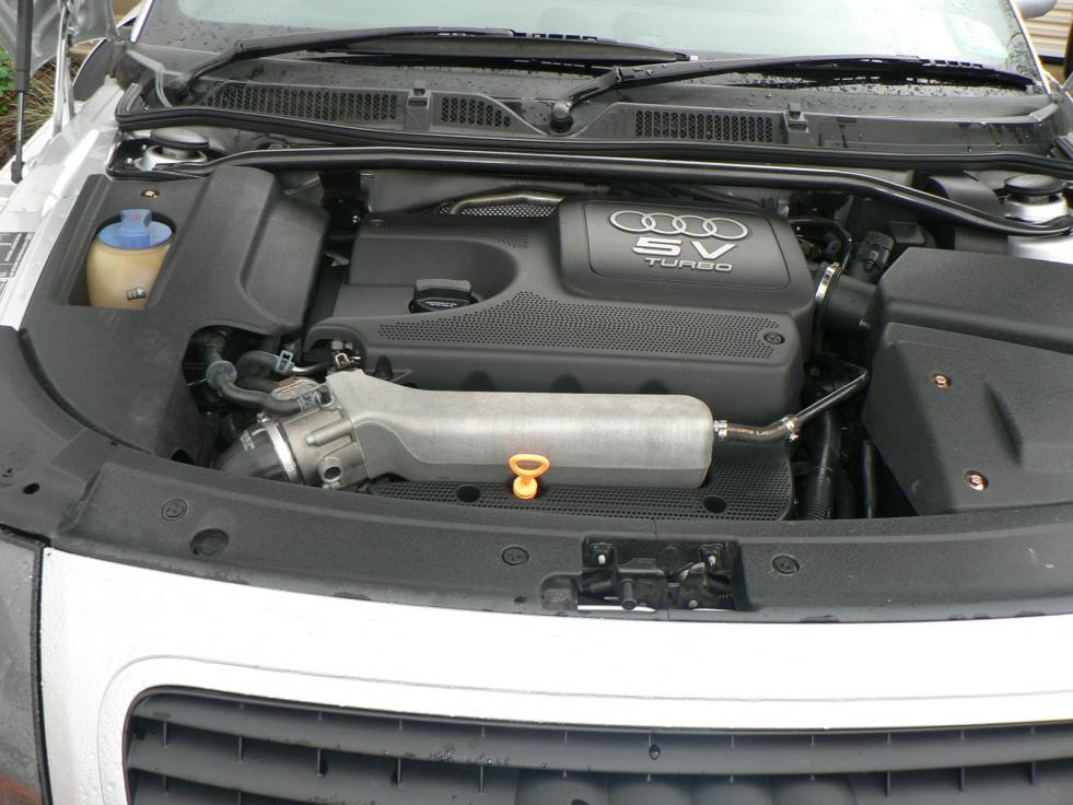

Attached Thumbnails Audi tt acquired cheap-tt1.jpg   Audi tt acquired cheap-tt2.jpg   Audi tt acquired cheap-tt3.jpg   Audi tt acquired cheap-p1020535.jpg

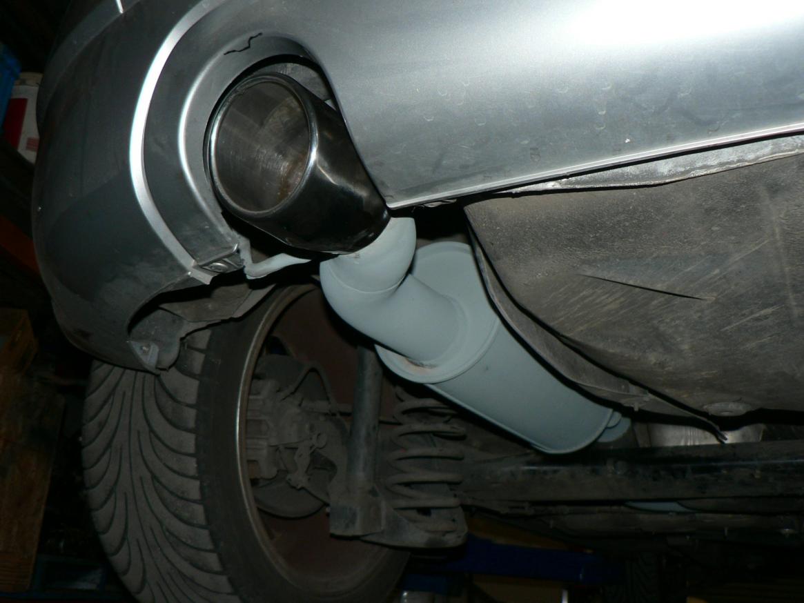

what downpipe did you use ???
running 2 tips out back ?
Old Jun 13, 2012 | 08:13 AM
sgtbilco's Avatar
Joined: Apr 2012
Posts: 8
From: Tullamarine Victoria Australia
Hi North D
I got the down pipe for USA a company called Top Speed Pro -1 Performance
they have a ebay store

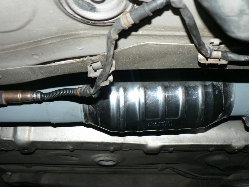

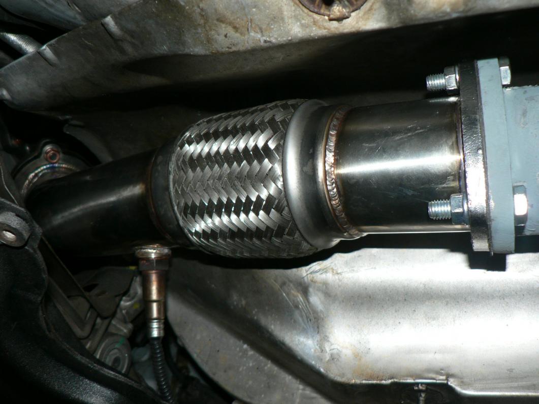

I purchased off them a hi flow manifold and the down pipe
the rest of the system i fabricated myself
3' all the way thru turbo flow front and rear mufflers and a magnaflow hi flow cat total cost for all the bits about $900.00 AU
Sound s deep and not to noisy
Cheers
Bruce
Attached Thumbnails Audi tt acquired cheap-exhaust-3.jpg   Audi tt acquired cheap-ehaust-1.jpg   Audi tt acquired cheap-exhaust-2.jpg
