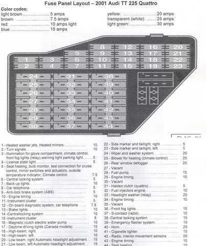

There's two fuses for the cluster, I think one's for the backlight and the other's for the needles and warning lights. Check em.

already checked em. nothin.
actually checked about 9 of them. lol
