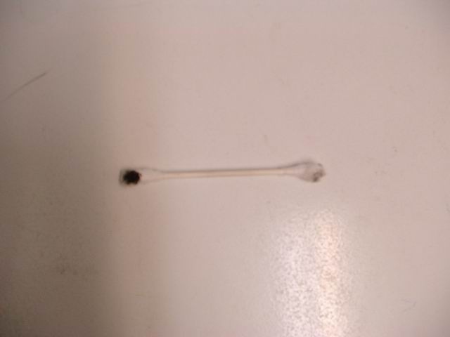

I got me an Actron Pocketscan code reader cheap ($40) off ebay and cleared the code after cleaning MAF sensor.
After driving about 20 miles it appears to be staying off.
Here is a picture of the cue tip I used to see how dirty it was.
Left side was wiped across metal grill between sensor and filter.
Right side was used on actual sensor.
So does this pretty much prove that this was caused by the K&N Filter I got about 3 months ago? It seems this is a common occurrance. If not proof , it's certainly some heavy duty circumstantial evidence.

Usually after so many engine starts (75-150 usually) a fixed cel well clear itself, if the problem is fixed.
If you have the guts to ignore CEL for 75 starts and believe it's the same problem every time and not a different one, sure go for it.
Let me clear this up:
First you fix the problem without clearing the code
Seccond, you drive the car for a bit
Not really sure how running a car without a problem is risky.
