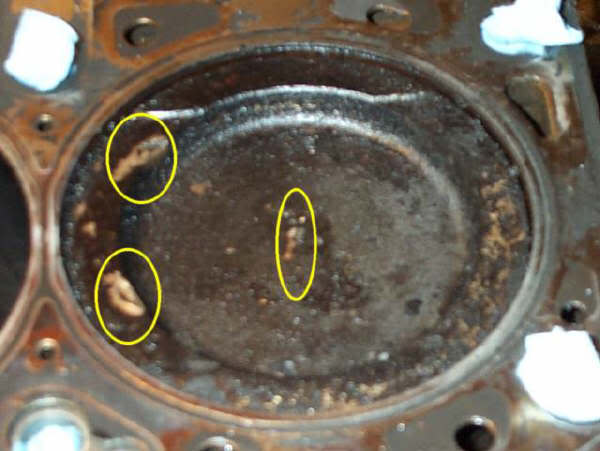

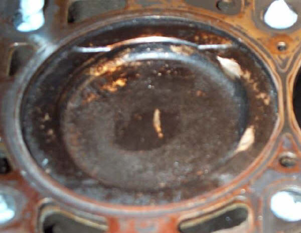

Don't ever expect your pistons to be sparkling. I believe it may remove some of the carbon build up, but water is not going to "steam clean" the inside of your engine. Here's the top of some pistons that had water injection (and also some valve contact unrelated to the water injection).

hmmm but i have seen what the pistions look like after 50k miles and then watermeth the last 5k miles....so i dont know what the hell went on with the pics above but most pistions dont look that way....mine look almost brand new without water/meth....thats not normal wear and tear in the above pics...
