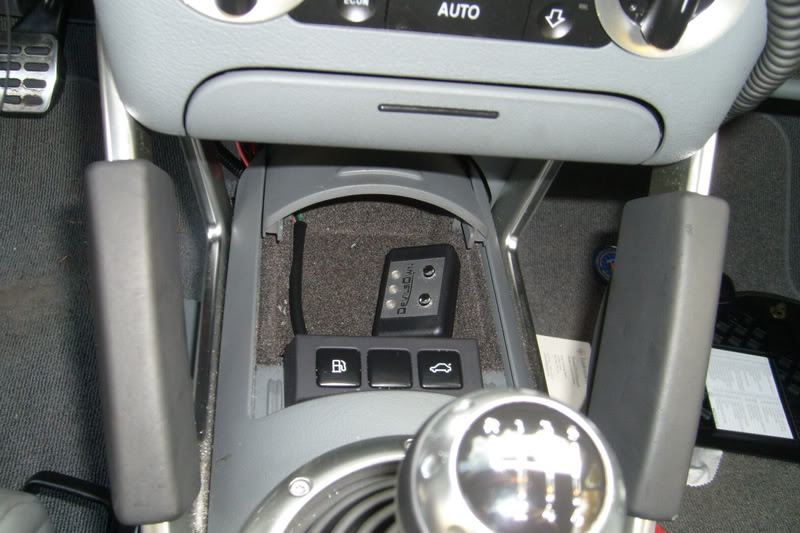

Final pics.
Placed the controller in the little storage area under the ash tray.

How big is that controller in relation to the radio/can the controls be remounted ona DIN sizedaluminum plate?
Since I never change my radio station, I was thinking of moving the radio to the cd changer location, and using the radio location for the controller, and eventually a gauge.

i doubt it...its like 1in by 2.4 in

Pretty small. I'd leave your radio alone. I drilled a hole in the back of the storage area for the wires.
