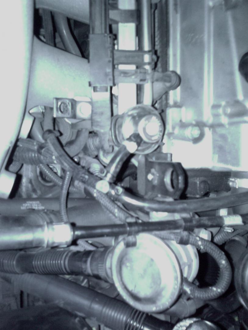

I put silicon on the shaft of the FPR valve and double zip tied it, I also swaped the 3bar with a 4bar FPR. Same symptoms occur at 20psi....I remmber I cleaned my K&N air filter with the K&N cleaning kit the same day I installed the boost gauge...maybe the MAF sensor is dirty from excess oil from the airfilter??
I have attached a picture of splice, its just a T adapter with silicon hosing. There were no restrictors, is that something I should get maybe?

Get rid of the 4bar, no need for that. Tap the gauge into the dv and not the fpr and see what happens

Yes, you have more than enough fuel with the stock fpr, upping it will only make you run rich losing performance and killing mpg.
The T is for if your gauge buzzes when your psi is maxed out. The T that came with your gauge should have a restrictor on it already

I see, I will take out the 4bar tonight, I bought gauge used so the T has no restrictor. Maybe that is the culprit?

that would most likely cause buzzing. Move to the dv line first and if it still has issues, get the T from there
