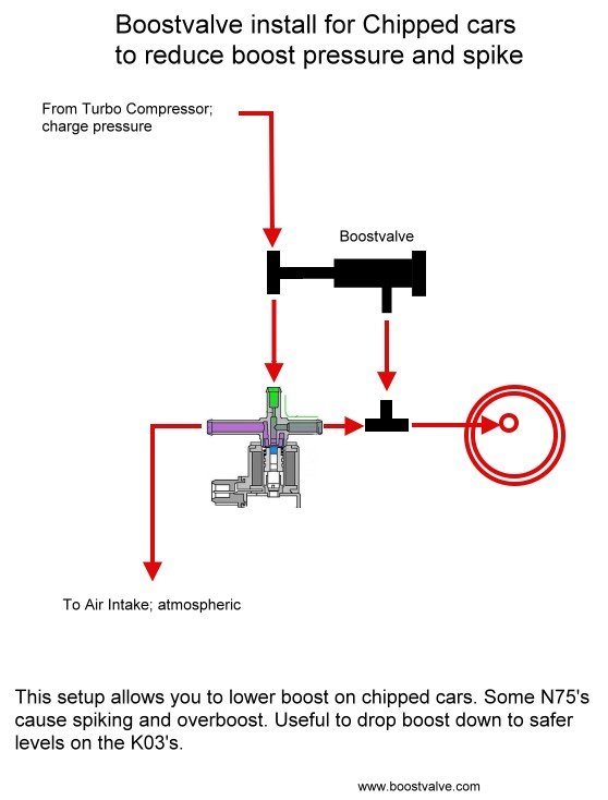

ok I found this setup online to counter act the overboost
whats the Red Circle in the diagram?
