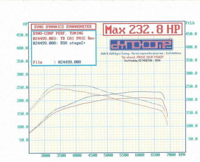

Anyway, +30whp is very possbile.
Running watermeth means you can run your 93 octane like it's 103 octane. So, you get cooler air + running more boost + more timing. You can even add the nitro booster from SnowPerformance into your w/m mix for a little more kick. And on a big turbo...the gains can be even bigger.
ORIGINAL: TurboGTi222 on Vortex
My first dyno pull on the 28rs was 249whp, untuned, 93 octane. THEN on the same dyno session, i engaged the meth, cranked up the boost, and advanced the timing 13*, and saw 292whp. You do the math. This was with zero fuel tweaks, just timing and boost+meth. I'd say that with more tuning,i could have picked up considerably more by getting the fuel right. 60whp is not far fetched at all.
More evidence, dyno from an A3, before and after watermeth. They didn't run any more boost, just more timing:
About +20whp on the same amount of boost.
Believe me yet?
