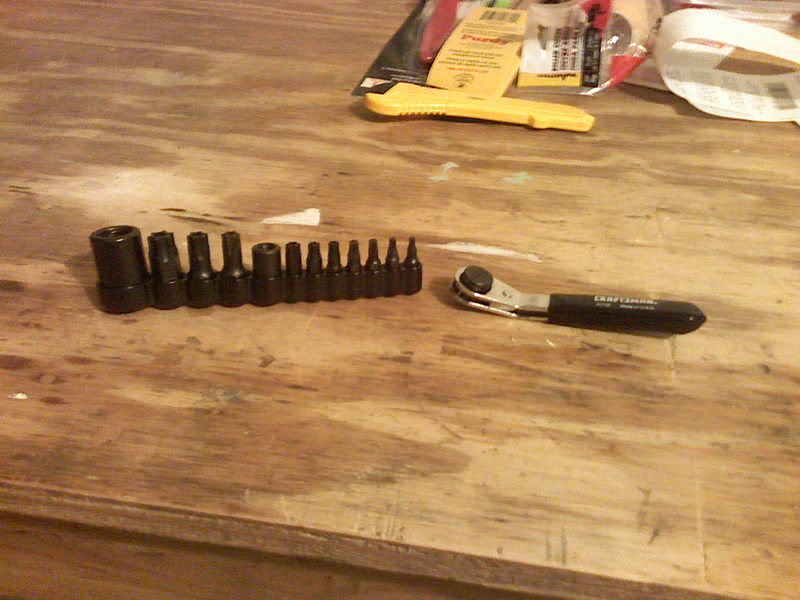

Also I picked up a set of tamper proof torx bits from Sears for somewhere between $10 and $20.They were 6point which worked on the original MAF housing but would not on the new maf housing I purchased which were 5point torx.
