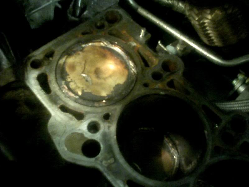

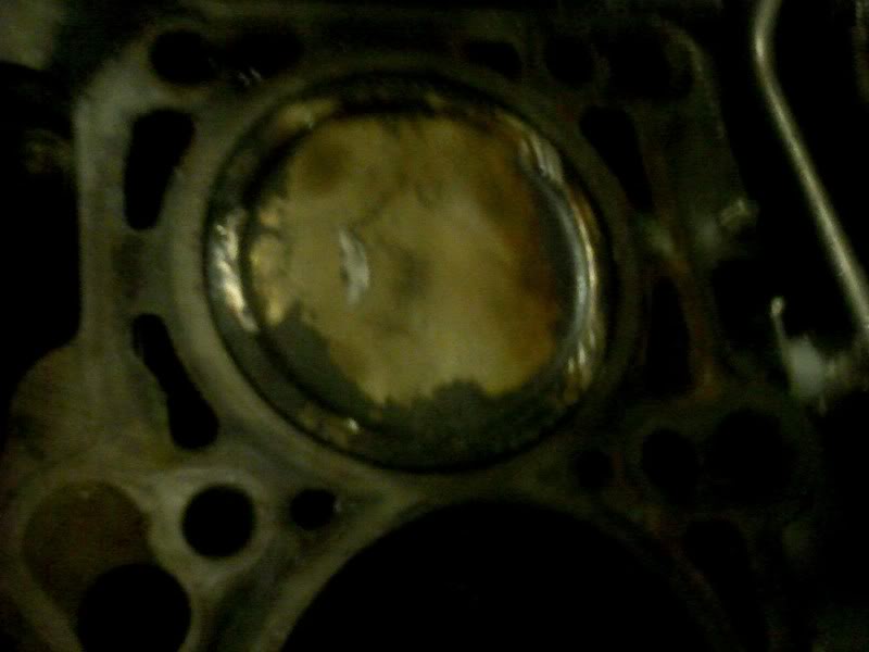

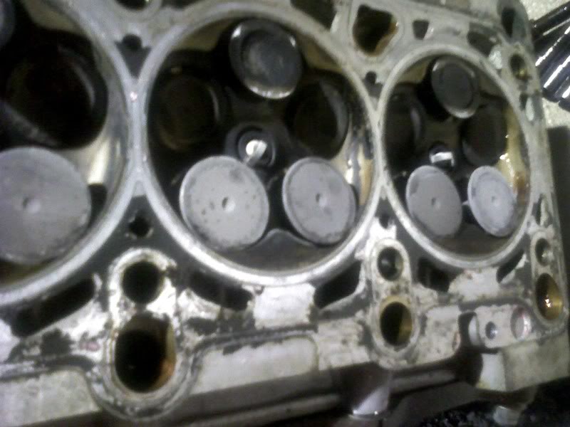

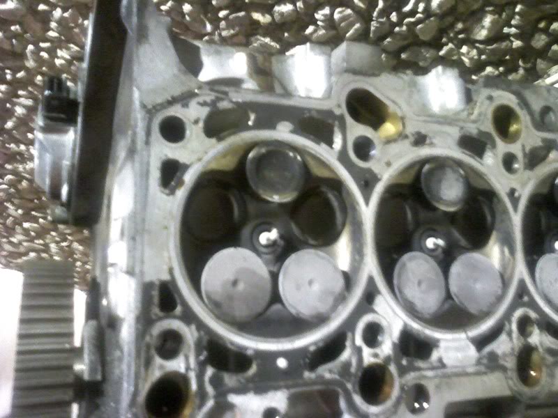

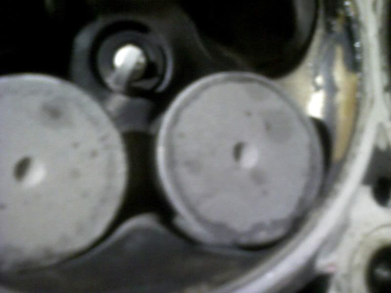

So I went to go look at the damage... it's bad. Nice semicircle dents in the pistons and the edges are all torn up. What really worried the guy was there was cylinder wall damage around the topfrom the bent valves. There's a lot of damage to the side of the top of the pistons. I don't know if it can be repaired or not. I took a few pics:

I don't know if it's worth repairing or not... Should I just throw a rebuilt longblock in it? Or should I repair it and if it doesn't run well then run it into a tree :-/

Default RE: I think my timing belt broke
You will either need to buy a bare block and rebuild or just install a used 1.8t from any other transverse car

Could you give specifics on how the damage was done? You were at idle? Did you try to restart the car? I'm just wondering what situation causes the most damage.

doesn't look as bad as I expected, the pistons can be cleaned up and cant see any damage to the cylinder walls though picture is not that good and poor lighting, main damage is valves and as none broke off you might get away with new valves and re-seat them,
quick edit: I don't see any damage to the cylinders because it mainly on the edge of the pistons and will polish up okonly time the cylinders are damaged is if the valves break off and that's nasty to see repairable I would say but consider a the cost of a used or refurbished cylinder head and the cost of new valves you might just be surprised at the savings and the time to put it back together, if you remove the cams you will see how many valves you need to change because the damaged ones wont go back up into their places so the cost of repair could be dramatically reduced
