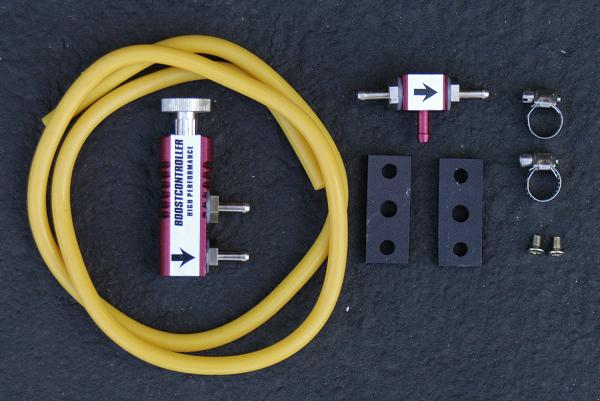

you arent using those $10 ebay turbosmart knock off are you? Those things suck *****

its not a nice one, today i was doing a pull and it hit 7-10 psi and would stay that in any geart till i turned the ignition off and then back on then it was back to normal, ya i think i need a diff boost controller.

its not one of these is it?

no, actually that one looks nicer then the one i have haha
