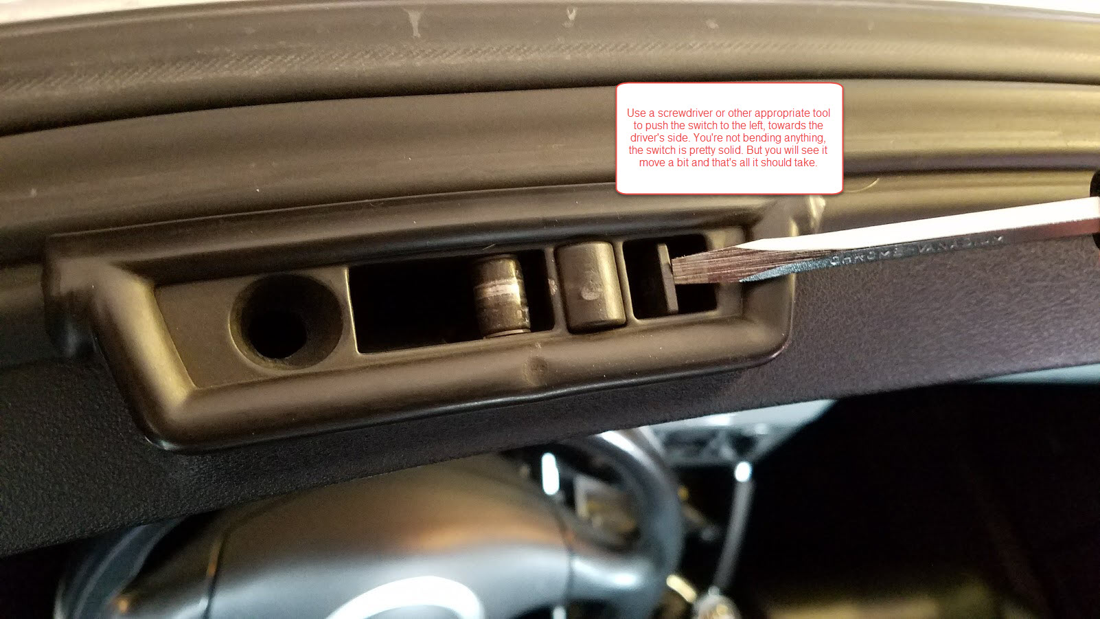

I just started having this problem with my '01 Quattro Roadster. At first I tried what others have suggested and put a firm piece of cardboard in the gap. That didn't work so I tried punching the handle. That worked. I've now refined my technique a bit and just push on the handle firmly, just below the "push" button, and that triggers the switch. Wish there was something better, but this will work for now.
Edit:
I tried a trick I read about on AudiWorld. On the driver's side of the windshield, where the top latches, is a small metal tab that is the actuator switch for the convertible top. This actuates the windows and if it isn't actuated, the "top open" warning light comes on. If you push the tab to the right with your finger, it should actuate the windows. When it isn't being actuated consistently by the top closing, the tab may be pushed too far to the right. You can push it back to the left a bit with a screwdriver and that should fix the problem.

Default TT top warning light
thanks for the tip, I used a screwdriver to slightly shift the actuator to the left and that is all it took, no window problems and the dash light is out
