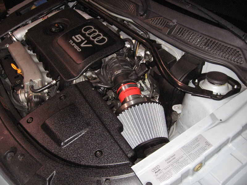

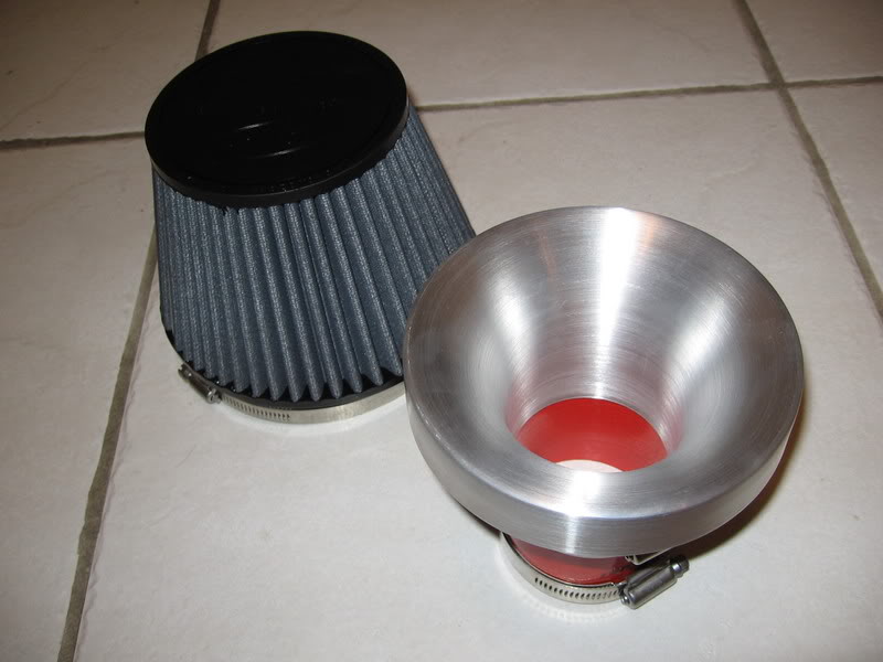

Originally Posted by IndyTTom
I have a BPi Flowstack along with an AEM dryflow filter and it works really well with the TT. Here are the links to those two items: http://www.bpinitiatives.com/stacks.php
you will need the 3inch to 3inch flow stack.
http://www.aempower.com/ViewProduct.aspx?ProductID=961
It's an excellent set up and less expensive than some of the custom intakes sold.
Is this setup the same for 180 / 225? Is it recommended to run some sort of heatshield? And by any chance do you have any pics of the setup? Thanks man!

the only difference between 180 and 225 will be you will need a 2.75-3" reducer coupler for the 180. A heat sheild isnt needed, but wont hurt if you really want to make one

Thanks Cincy!
edit, I remember reading somewhere that there is a sensor of some sort that goes into the stock airbox... Do you re route that, let it hang... Or am I mistaken on what I read?

you need a filter for the sai line thats attached to the airbox
