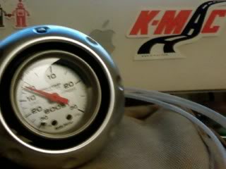

Same Autometer boost gauge. The only difference is the air flow.

52mm (2 1/16) will allow airflow
60mm (2 5/8) will block all flow

I made my own vent ring out of 1/8" alum sheet.Just just Dremel and drill press time involved. Left side vent works well, very little blockage. The toughest part is getting the vent assembly apart.
