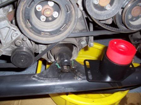

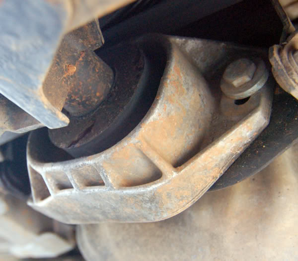

Here's what my snub looks like in there... that's not a crack, it's me wiping the dirt off with my finger.
I don't think purems has the same snub that I had anymore. The one i have is (was) red and had a rounded side on it. the stern mount seems to be a new design.

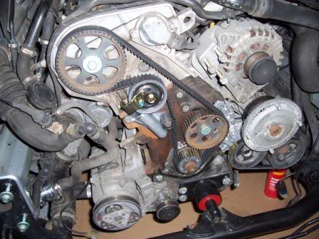

I think they were a little different for my year than yours. Here's a pic with it uninstalled next to the old snub. Not sure if it's in "all the way", but certainly enough to get the (metal intake tube/radiator support) back to it's normal position.
I microwaved it for maybe 20 seconds and used some leftover silicone spray that came with the coilovers to spray on the coilover shock threads.Pushing really hard, I gotthemount (red part) to goonto the "finger". Tight as hell... and to get the red part of the mount to go into the 034 bracket, I had to get it started all the way around using a small flat head screwdriver. I had to sit on the garage floor, facing the front of the engine, while holding each of the bumper supports with my arms stretched out, and my feet on the (metal intake tube/radiator support), kicking at it to get it to go in all the way. So Ithink it's in all the way?
The vibration is more tolerable and I've probably just gotten more used to it, but I really notice the cupholder vibrate at idle.
