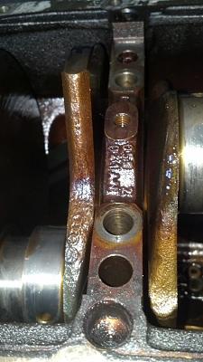

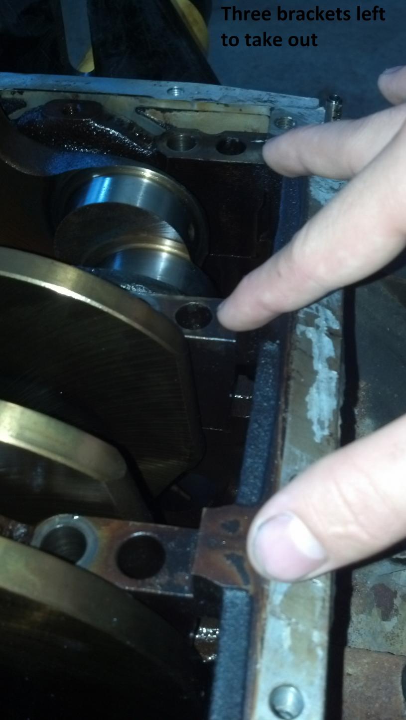

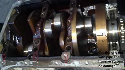

Thanks redline380, I got the heads off as well as the camshafts from the head, but i have yet another problem. I am doing a complete rebuild of the block (not so much the head which by the way, would it be important to rebuild the head if i rebuild the rest of the motor?), so replacing all the bearings for the rods and crank, gaskets, seals, the whole thing. But Im not sure if anyone has had this problem, but the brackets holding down the crankshaft are like STUCK. i got one out, but the remaining three seem as though they have been pressed into the block with a gear pusher of sorts. i have really looked at the brackets with a fine tooth comb and i cant see any more bolts that could possibly be holding any of the other brackets down. why are they SO stuck? i mean i tried putting a pipe with a few towels on the end and positioning it as perpendicular to the bracket as i could and tapping (hitting) it with a hammer. it moved like maybe 1 or 2 mm but almost not visible. re there any tools that i need to do this? any ghetto rig style formulas for this problem?

i've taken apart a 2.8 before and i know what you mean. i rebuilt my 1.8t and it wasnt nearly as bad. it seem like the main caps are slightly larger than they need to be, hence your issues.
what i would do is stick the bolts back in the cap, but not far enough to the threads. just in the caps and pound the bolt at different angles. do it lightly, but sternly. you dont want to damage the crank journals. and dont worry about damaging the bolts. you cant reuse them anyways.
a etter way to do it is stick both bolts into the cap as described above but only use your hands. pull and push on the bolts while trying to lift the cap up at the same time. hope you understand what i'm getting at.
if all else fails, pound on the end of the crank with a dead blow hammer. or you could try prying on the counter weights of the crank, just dont damge the journals

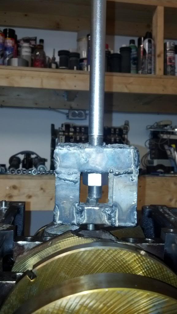

I actually welded a small box type deal with materials from rona. there was a hole in the bottom for a bolt to screw into the crankshaft cap and a hole in the top where i put a slide hammer through. It was a little ridiculous but it worked.

There was actually threading on the middle-top (bottom if motor if flipped upright) of each cap where there were no pre-existing bolts from the engine. I screwed the bolt that was fed through the box into it and then used the slide hammer to whack the cap straight up. The treading stood up to it no problem! This was surprising especially with the force i was creating with the slider hammer because the bolt diameter was not that big but really strong especially since there were bolts still in the cap holding it in.

Got the caps out as well as the crank and boxed it up to send to the shop for cleaning! But yeah be careful with the caps because there are bolts that screw in from the top (when motor in inverted) as well as from the outside of the block into the side of the caps.
