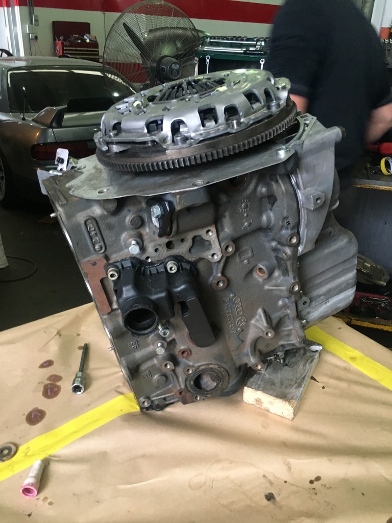

In the mean time as ecs are sorting the rods out, I find out that the crank will not be compatible with my block, I have read that aeb is excluded for kit fitment and done research on my block only to find out that the kit is literaly not compatible with like 2 engines of the b5 and it happens to be mine, my heart sank finding out the news and was right away investigating my options. I was lucky that I came across a video made by integrated engineering on youtube describing the diff between the 058 and 06 blocks and they happen to mention that a stroker crank can fit on058 but will require machine work on it. Some cmall life of hope I felt.

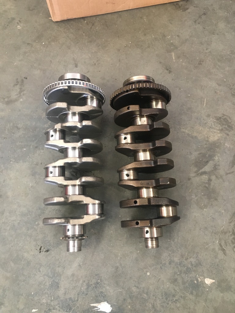

Here is a comparison on stock and fsi crank.
You can see the difference at the bottom, the fsi crank has the gear and is slightly fatter base. I took the crank to mechanic and the news i was waiting to hear "yeah I can easily do that" I release that this is no convenient job and that pretty much no shop would do something and my mechanic telling me with confidence that he can do it no problems gave the life back in me. I have dodged a bullet with this crank and fitment but I guess my engine will be few with the fsi crank on 058 block making it unique.

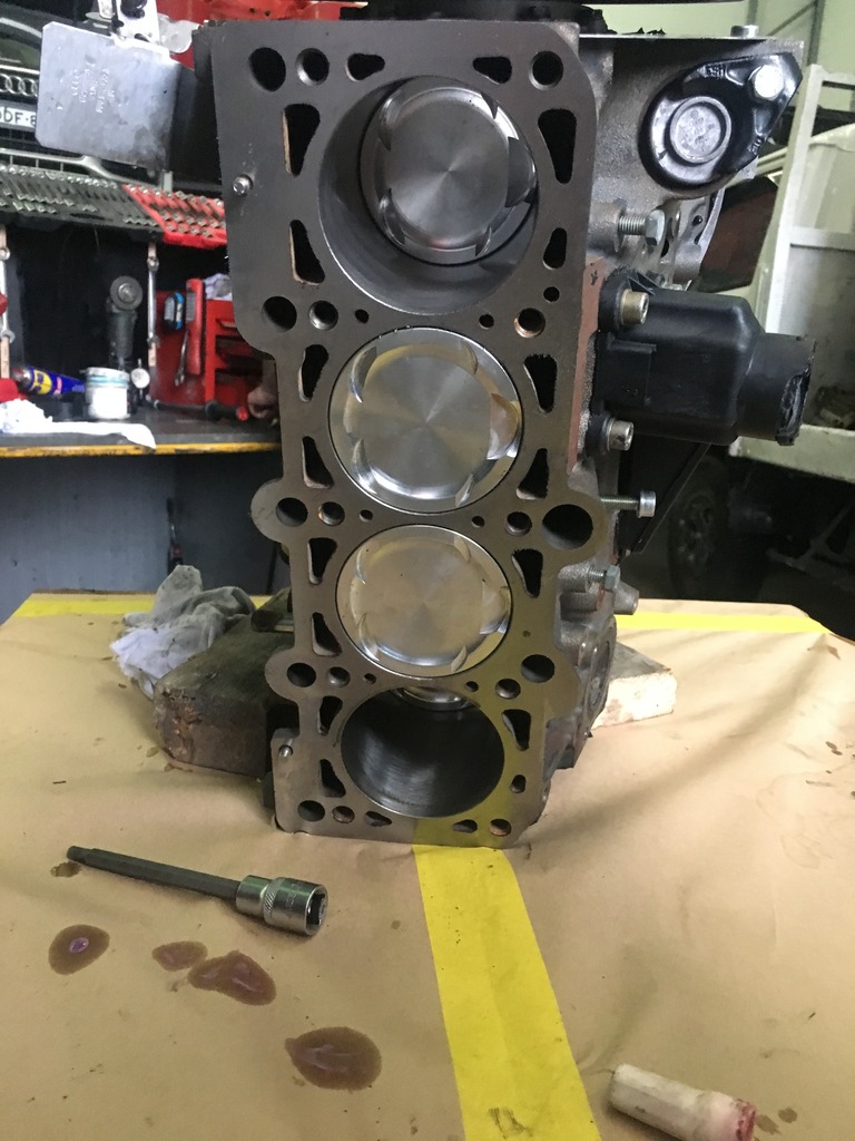

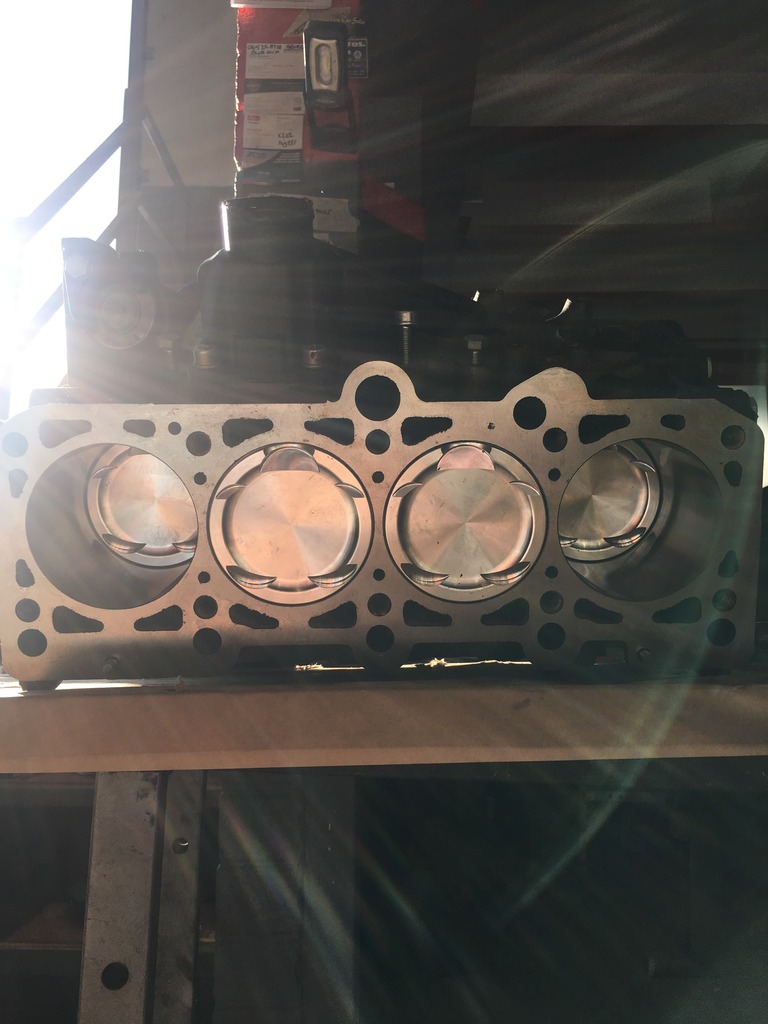

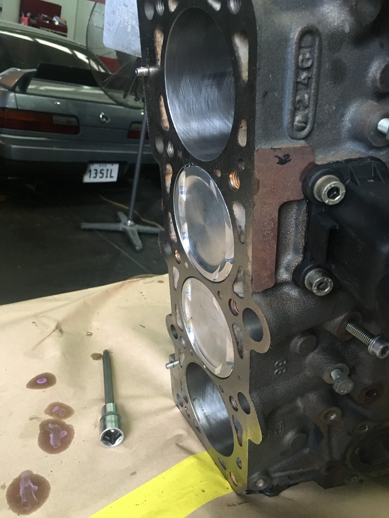

A shot of the pistons assembled...

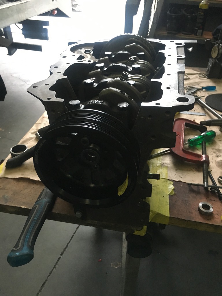

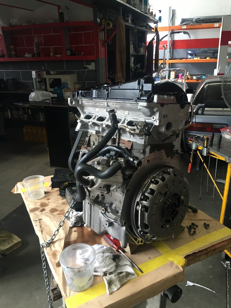

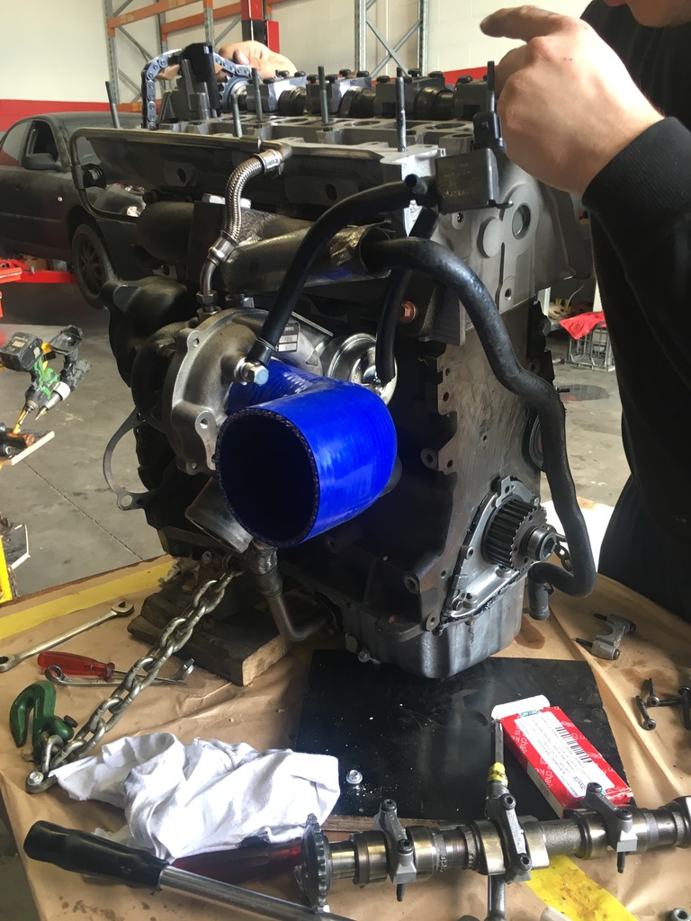

As mentioned before the main issue or hurdle now was to fit the crank. We came across two issues. The first been fitting the end of the crank to the crank pulley as the crank needed the gear removed (easily done) as well as machining. We needed to machine the crank end to the thickness specs of the original crank which was successfully done, now all that was left was to shorted that end to the length of original crank which a little tricky as it needed to be perfectly straight and smooth as the crank pulley would attach to it. Even the slightest of errors in smoothing it you could see once you spin the crank, the pulley was not spinning in a clean circle but more of an oval.
However before this issue was sorted the other issue which was the crank hitting the insides of the block when rotating had to be sorted. The insides of the block were machined down to provide clearance for the crank to spin without rubbing on anything.
From here on thank fully was much smoother as the fitment and more delicate issues had been sorted and assembly of the engine can finally begin.

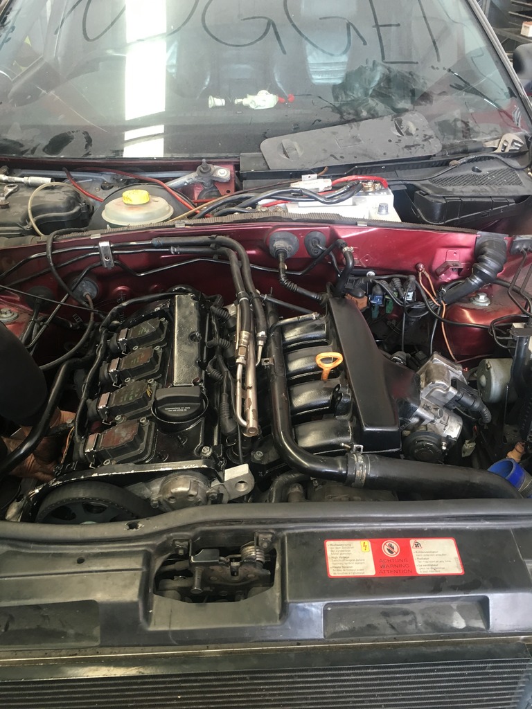

I haven't got any photos to show on progress on installation but have got some shots of the first time in a while that engine meets body once again..
(yes that is nugget written hahah)

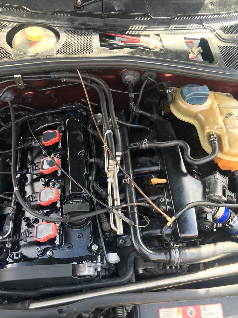

later down the track the red coils and icm delete kit fitted
Shorty after the final bits and pieces of assembly had finished, coolant topped, oil topped. The car had finally had its first start up in more than 2 months. I was not their for the first start up unfortunately but I had come about an hour after it had first fired and came to see it idling. I was told it fired first go after a few cranks. it didn't have the exhaust attached nor many of the hoses around the turbo etc. Throughout the day the rest of the bits and pieces were assembled and soon the car was ready for its first drive on the fresh engine. it was finally ready!!!!! Telling the mechanic do not floor the car nor push it as its running a stage 1 tune ecu for a k03 turbo. I had warned him that it will most likely boost spike if he gives it a little. He took it for a drive and yep confirmed the car was most certainly over boosting (as expected) Car was hitting 30psi! Hood opened, wired the turbo to run on waste gate pressure at 7psi. the car ran perfectly! not a hitch, smooth acceleration, that was the mechanic driving, soon it will be my turn. As I had initially drive a different car to the mechanics, I had told a fried to drive my audi and follow me home while I return the car I came to mechanics, then ill drive my audi back to mechanics with friend as a test run.

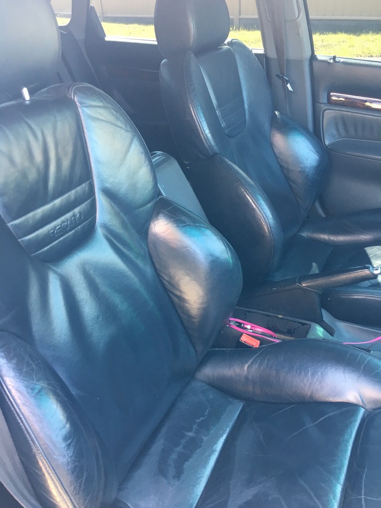

Shot of the S4 seats, rears are on as well..
Need to make a custom bracket to hold the rear seats locked in place as stock a4 seats lock up differently than the s4 so at this time the seats can be pulled down at any time if wanted. A hard and sudden brake can also at times cause the seats to come down, have my 2 amps mounted on the back of the seats so I have to be careful and make sure it doesn't happen until a proper bracket is placed. Must say the seats are a fair amount more comfortable than the stock a4, they are also fully motorized other than sliding the seat forward and back and finally they look so much better!!

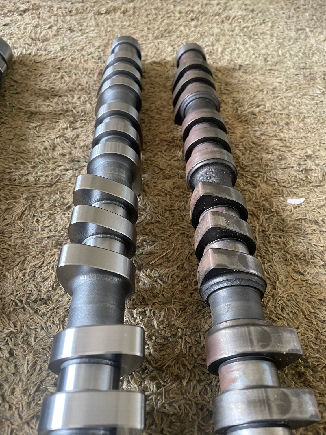

have just ordered a set of race ie intake and exhaust cams as they are back in stock. My boost controller had died so boost is running 7psi atm. When the car goes back to the tuner, he will have the controller replaced and will also install the cams and retune the car.
There will be finally an apples to apples comparison to my tune on an f21 with stock cams verses exact same setup with race cams. I chose the race cams as I will be one day hopefully be pushing 500+Hp and I don’t mind the idle.
I am very interested in how the power band will shift on the current setup and will hopefully put some questions to rest. I have read and most people say you will lose on everything due to the size of the turbo but at least I can show through the results through the dyno.
The bigger turbo will eventually be put in and will utilise the cams as they were meant to be.
The car also now has a catch can setup along with removing all the hosing and piping running on the intake hose to clean up the engine bay. The maf sensor will also be moved to the cold side when the cams get installed.
