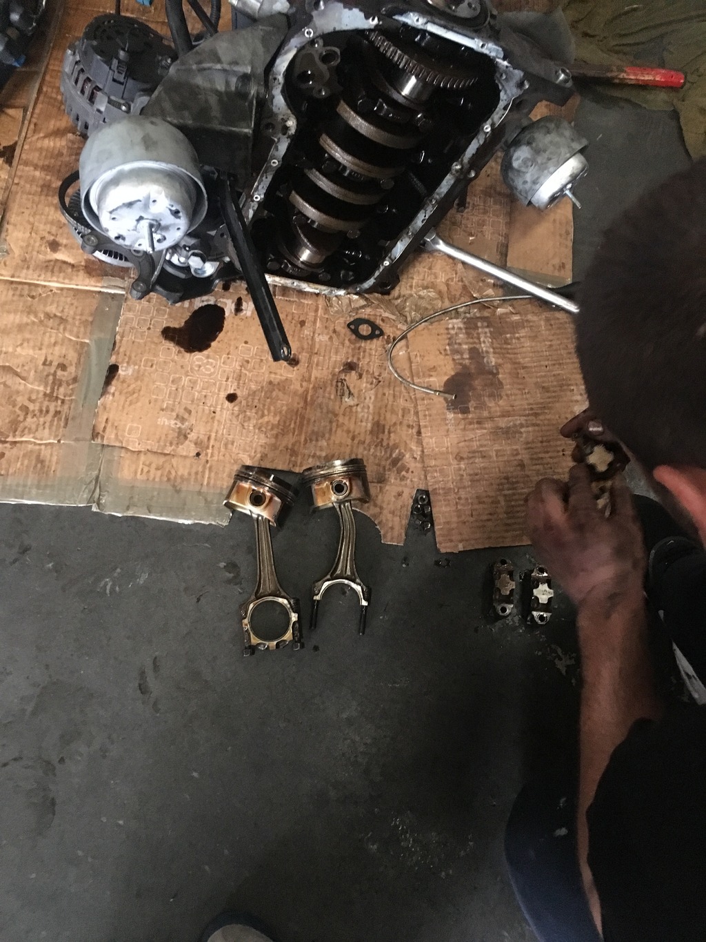

I give it a little and around 4-4.5k I hear a pop in the engine, the call stalls. I turn it back on to here a loud ticking which appears to be right in the engine.
The more throttle the faster the tick. At the same time my clutch pedal was heavily vibrating and I had no idea what to think. Driving it slowly back and to the mechanics house at night he suspected a clutch as there was loud vibration coming from clutch area and giving that he just drove it around and seemed fine. The clutch still engaged just fine besides the vibration at idle.

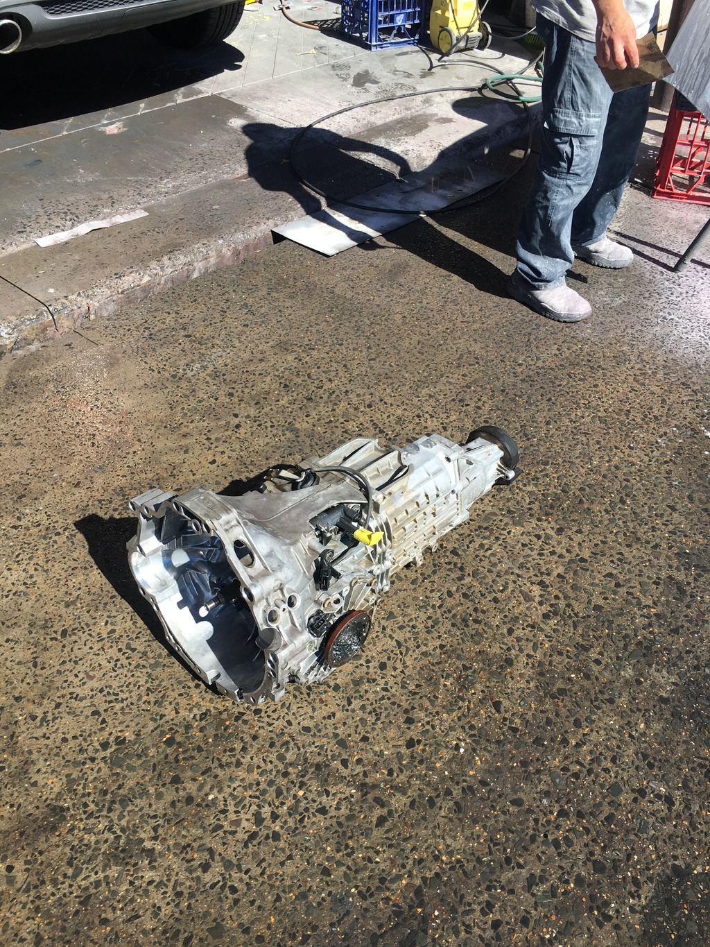

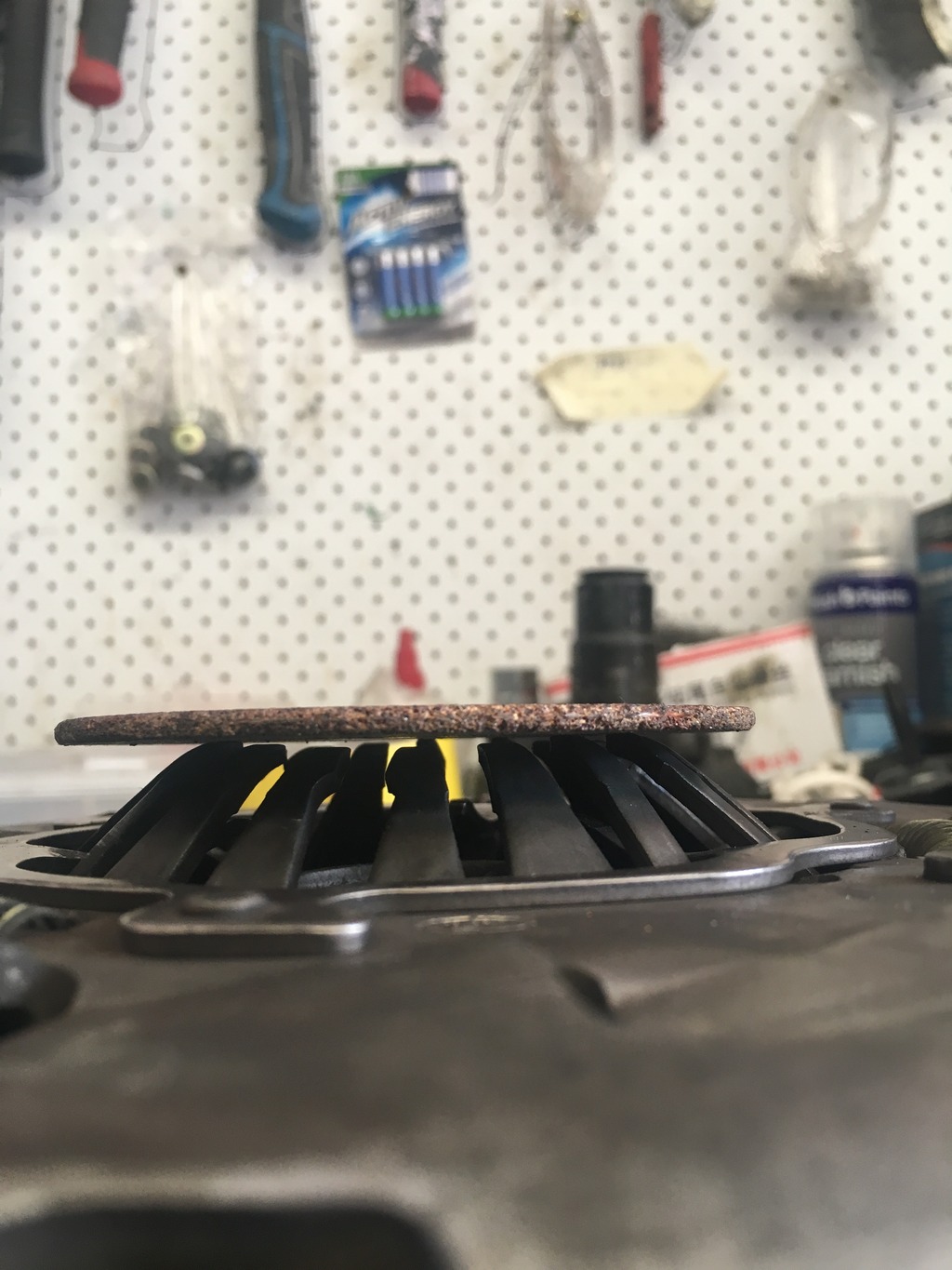

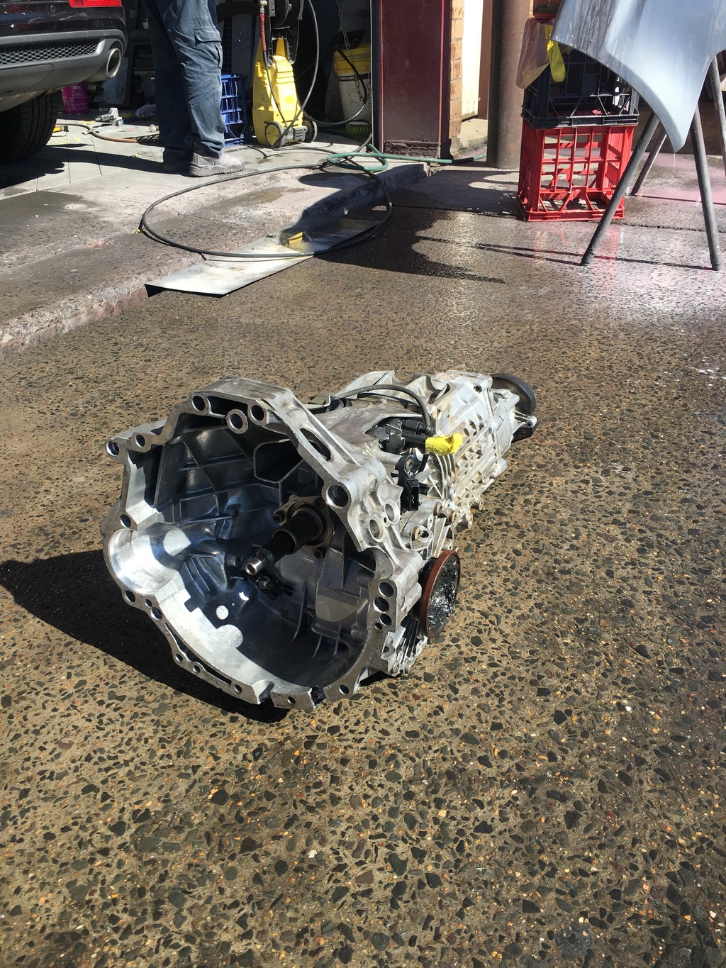

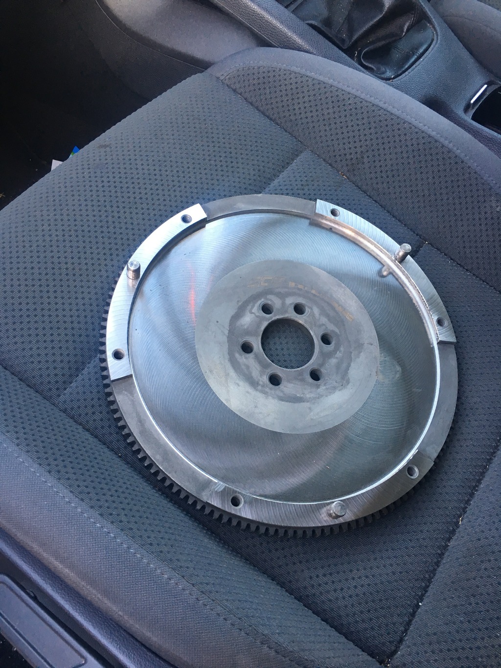

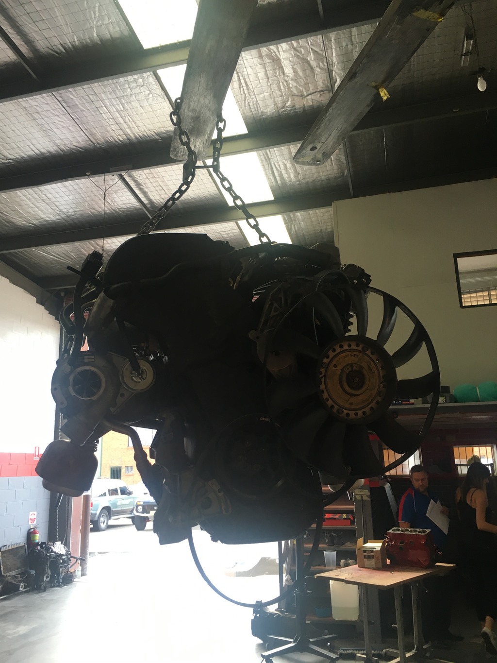

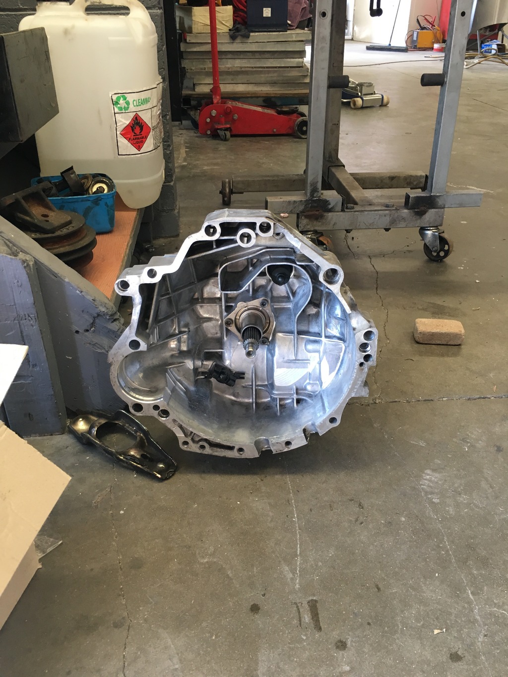

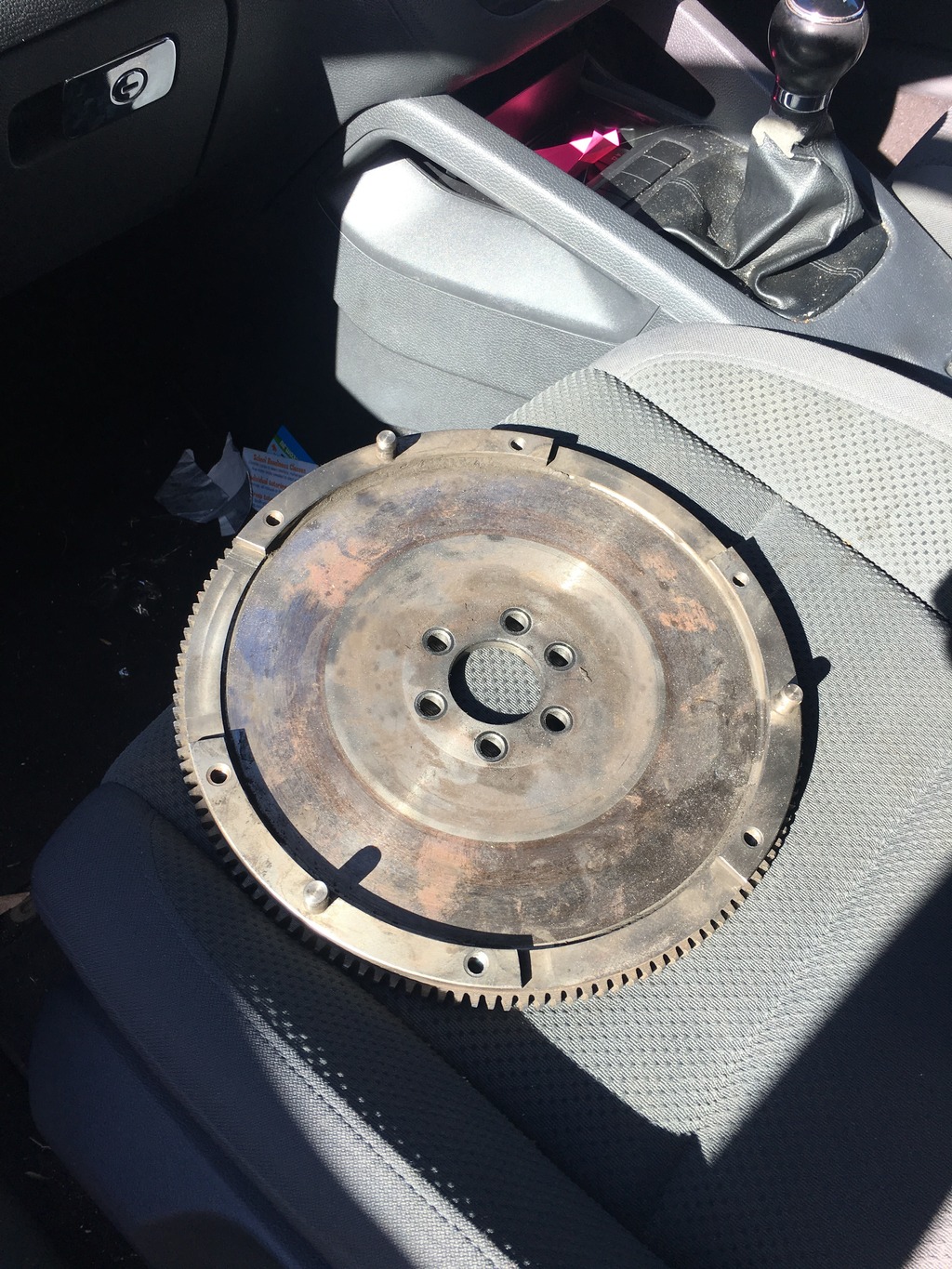

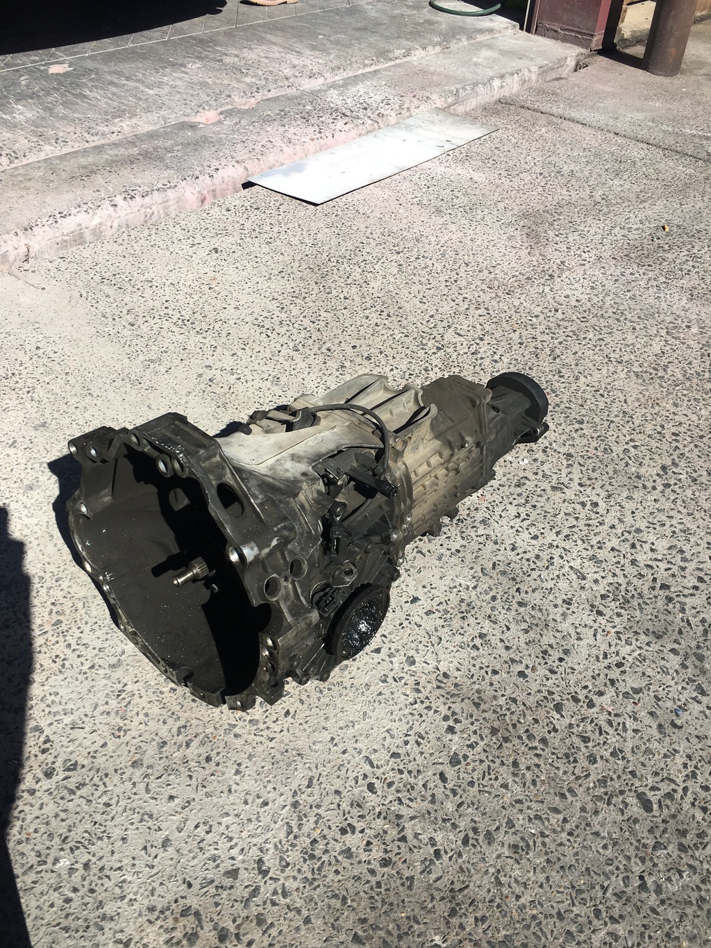

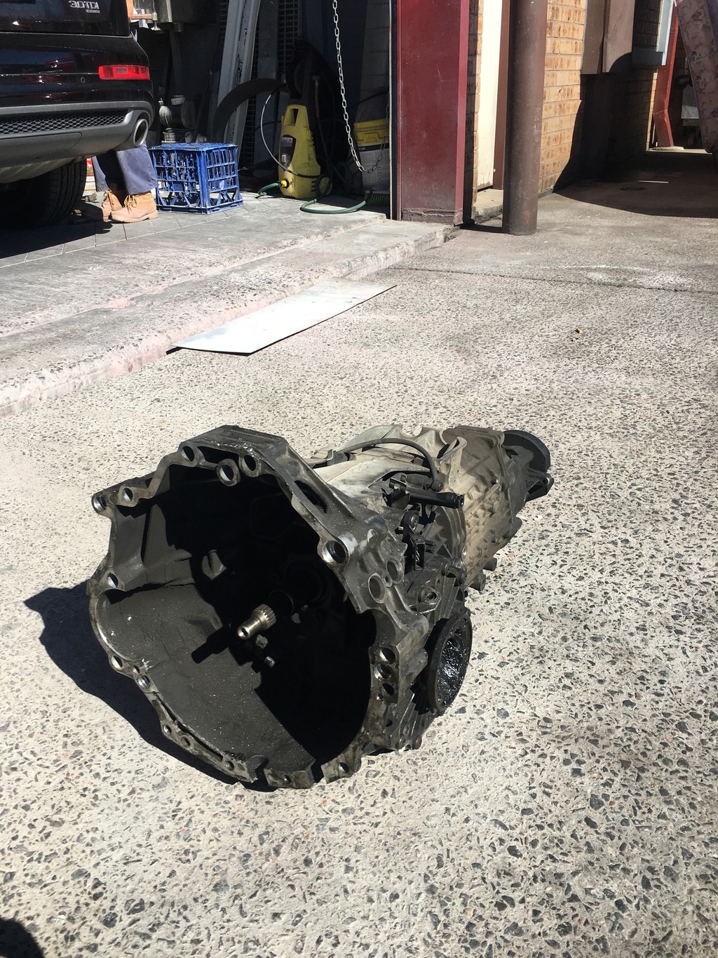

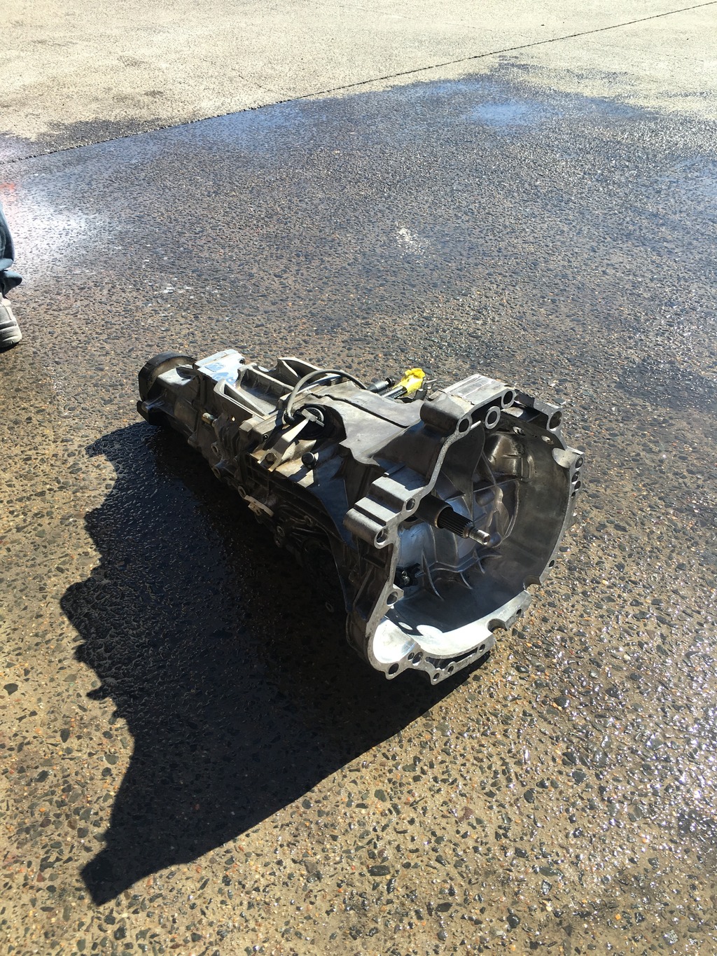

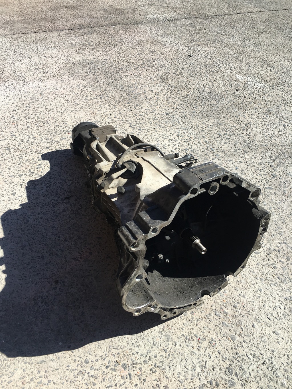

The next day was a big day. Early in the morn the car at the mechanics, time to start tripping gearbox and check the clutch. Gearbox apart, clutch out. The clutch looked good and didnt show signs of wear or heavy damage as the clutch is a fairly new s4 clutch with lightweight flywheel. here is a photo
This explains the clutch vibration however not the ticking. The mechanic also had difficulty spinning the flywheel of the gearbox and suspected there was a resistance in the engine. Time to strip the engine.

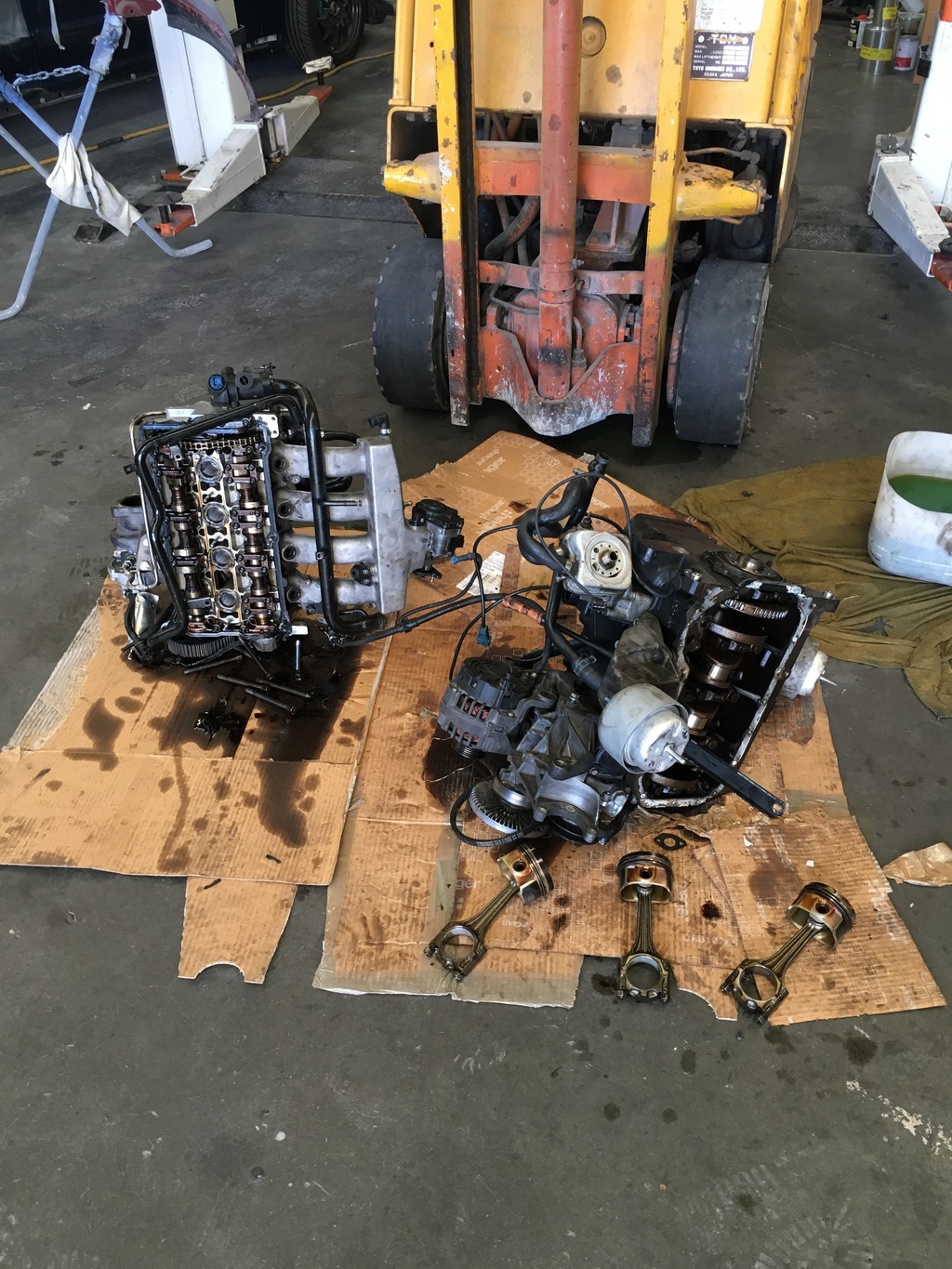

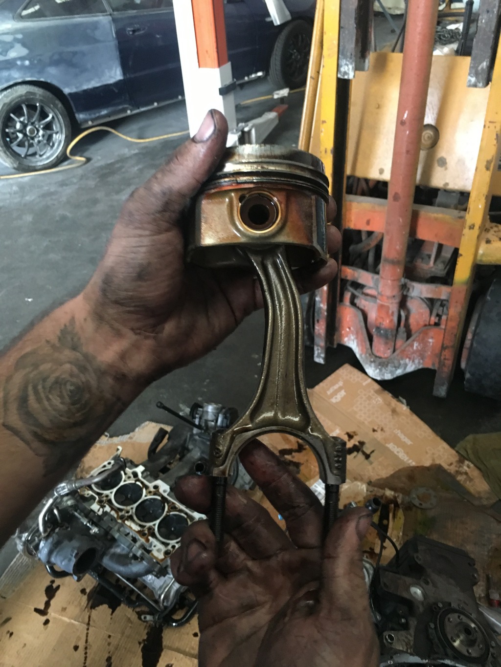

and here is the problem
No clue how this can happen but the conclusion was that its on the tuner as the car was perfect before and now this. Contacting him right away obviously the tuner does not want to claim responsibility and I was left with a huge $ to fix the car and get it running. The tuner attempted to prove that his ecu was not the cause by placing it in a stock k03 with 520cc injectors LOL. For some reason it worked, his car my ecu and injectors... im like why would that even work and in no way is that even a legit test lol
I am left there asking why did this work, a f21 tune with 520c injectors on your k03??? he is like the ecu is adjusting lol. In short you cant argue with him as he is determined he isn't the cause, he cannot even tell me what the tune on the ecu is. That fact that it worked on his car led me to believe that the tune is actually for a k03 98/e85 and that the injectors are to match a k03 but he gave that to me.
I would like some professional advice to, what would happen to a car with a k03 tune running a f21, is this possibly?

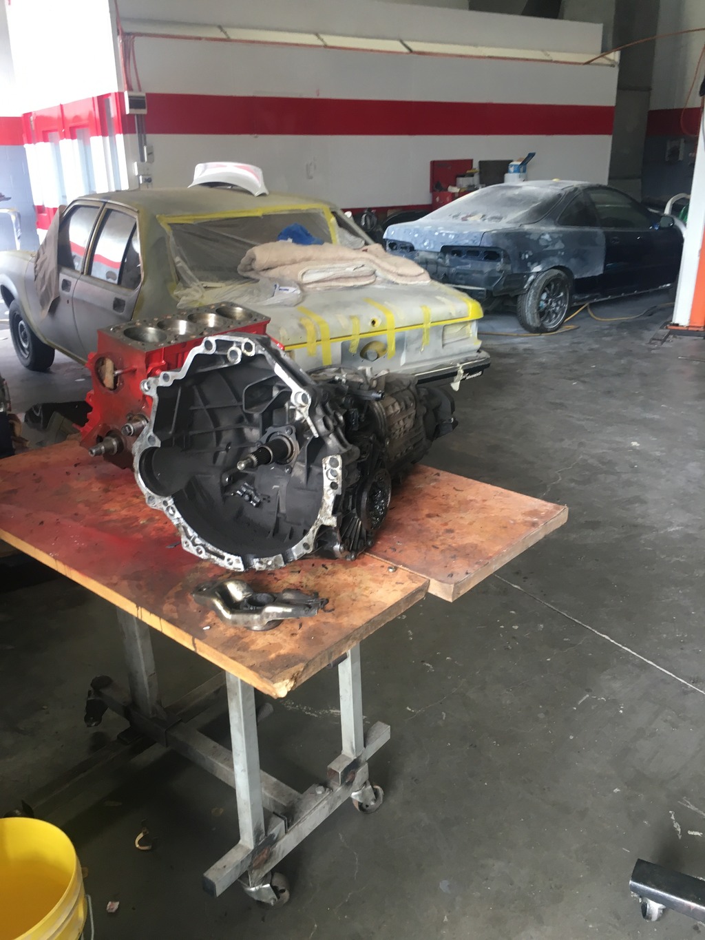

After some thinking and research I have decided to build the head a little as well. It has been rebuilt/refurbished however still same springs, valves etc.
I have decided to go with supertech, have ordered
Exhaust valve set, +1mm Oversized Inconel Single Groove (IE)
Intake valve set, +1mm Oversized Single Groove (IE)
Springs, retainers and valve seats (ECS)
I figured I will future proof the engine a little better as I deff intend on running a much bigger turbo within a year of sorting all this out now, those extra few revs will help.
Bigger cams will also go in once they become available;e, all back ordered.
At this stage im still waiting on the rods, pistons and crank to arrive which will be in a few weeks, the valvetrain stuff will arrive within a week so when the stroker kit arrives, the whole engine can be built and put together at once.
