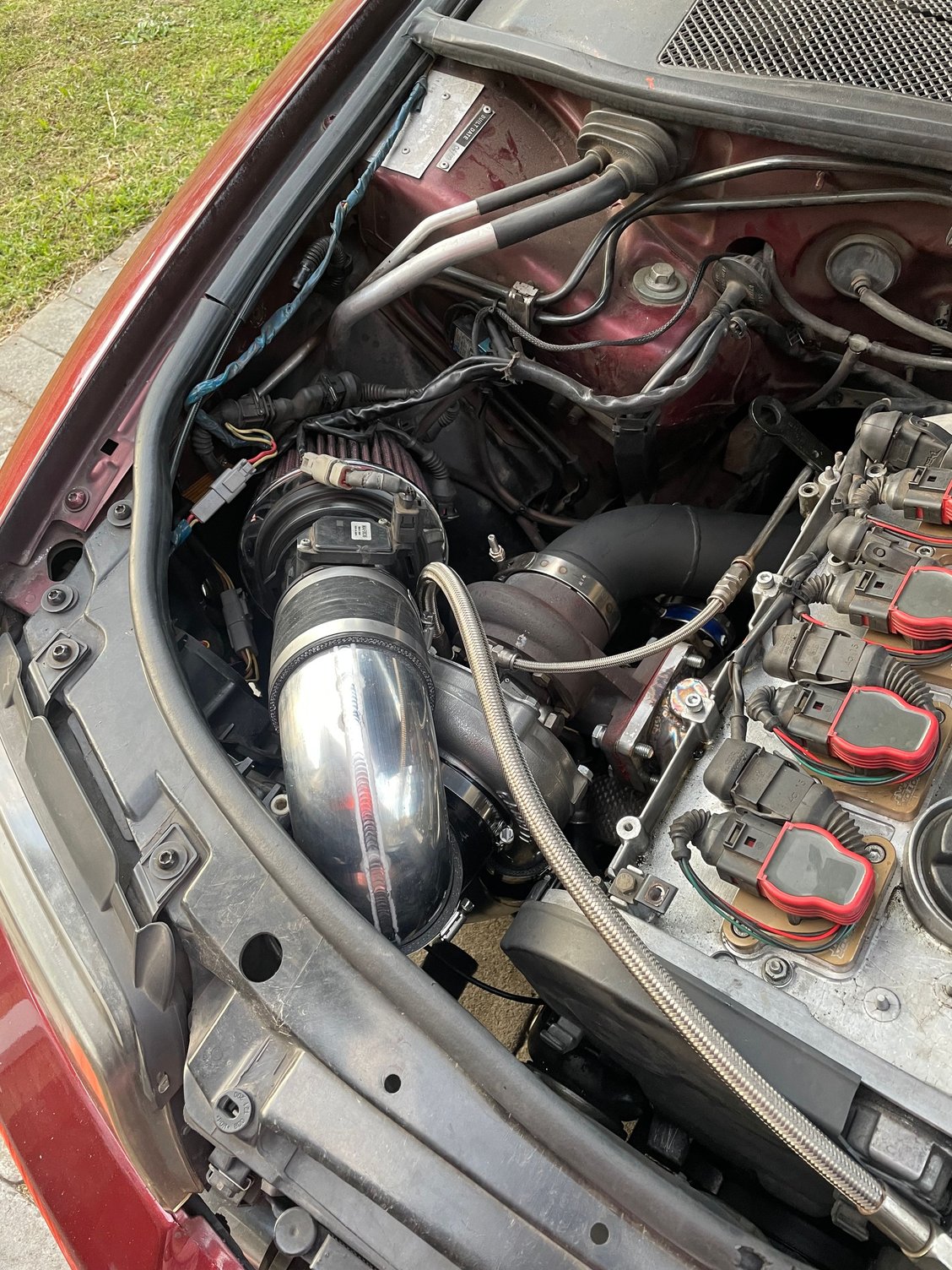

Change of plans with the cams, decided to just have the turbo manifold and Intercooler piping sorted and have it tuned and install cams all in one go.
At 21psi made 267kw but then detuned to 17psi to make 233kw as fuel pump couldn’t keep up. Turbo is good for about 30+ psi so hopefully should see 320-330kw at wheels.
need to get a bigger fuel pump and then turn up the boost.
