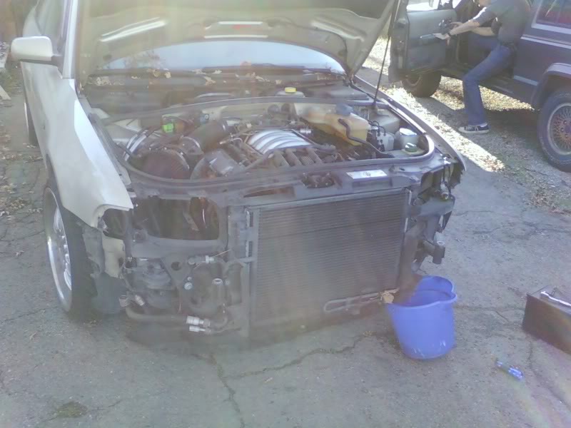

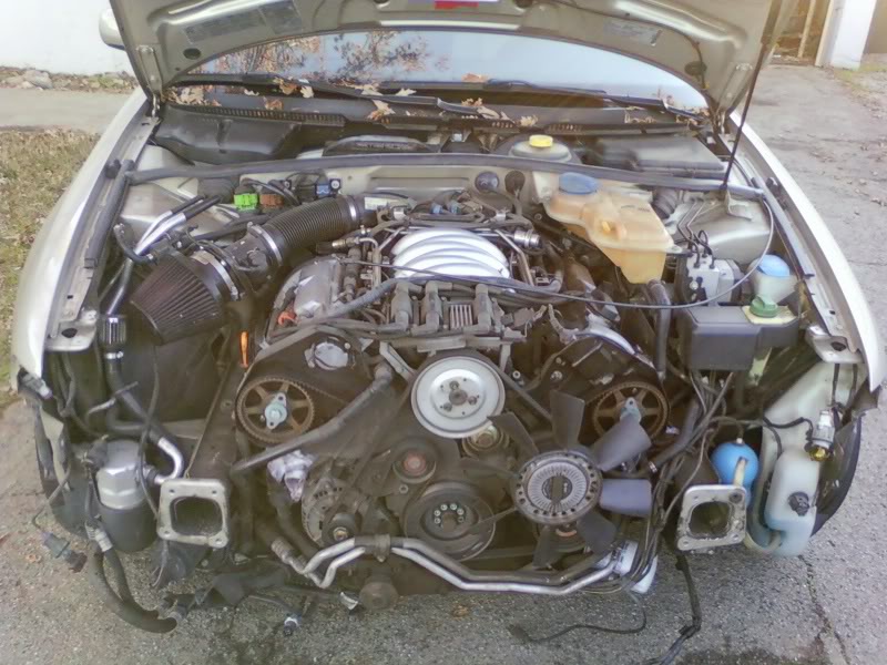

just starting...

radiator core removed

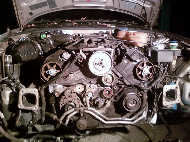

no more timing belt ...

well from what i can see my intake valves dont look bent ..hopefully have heads off tonight or tomorrow

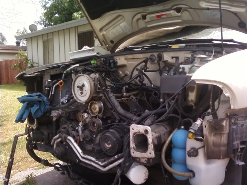

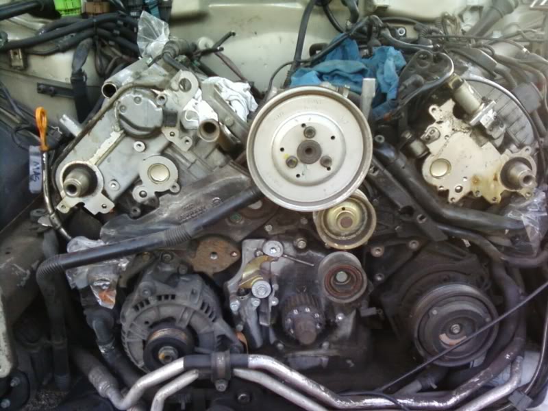

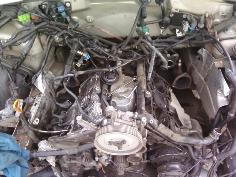

man i havent worked on my ride since jan. thats sad especially since i just found out i didn't bend one valve ...so i guess it is possible to snap a timing belt and not **** your heads ...when it snapped i was doing like 80 or 90 on the freeway but motor was at idle cuz of upcoming traffic so maybe cuz it was at idle i dunno but ill take it ..heres some more pics of my progress and i will do a write up if i can put her back together and start it
heres w/ cam gears removed ..that was one special tool that delayed me .

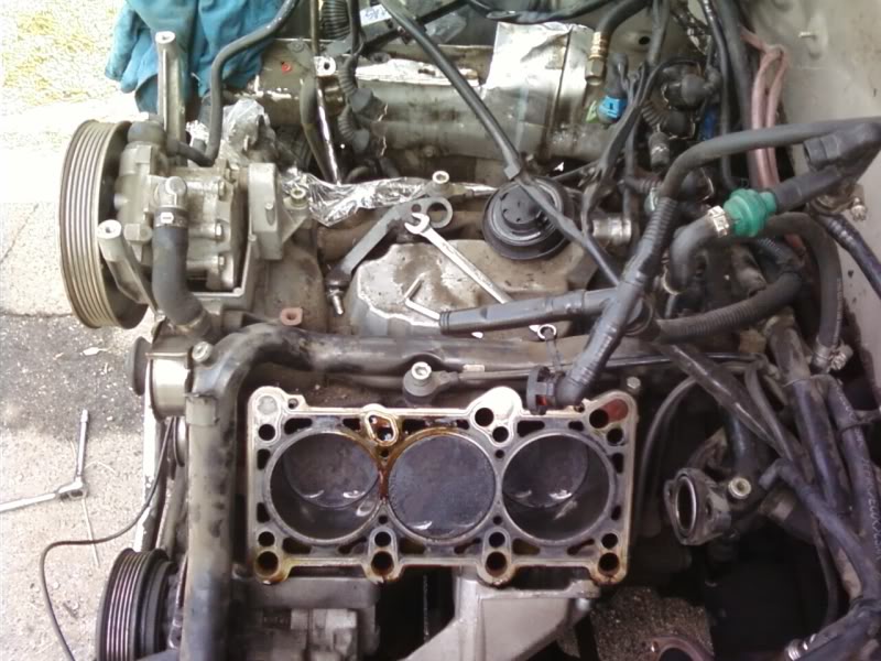

passenger side head removed

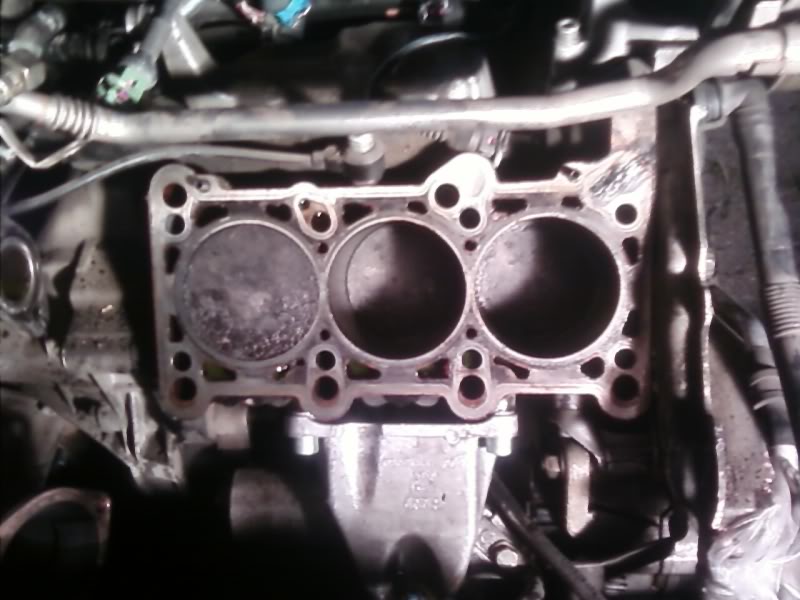

drivers side

how did you not bend valves on the drivers side head? those impact marks on the cylinders are pretty deep, i cant imagine how the valves that hit would still be good. make sure to take some 300 or so grit sand paper and sand down and rough spots on the pistons before throwing it all back together.
