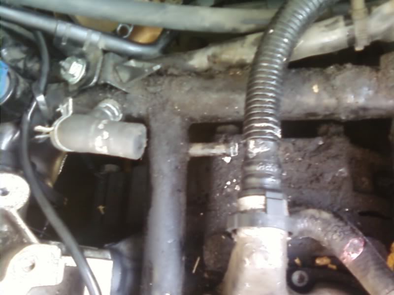

man this is no where in my f-ing bentley manual its not under cooling which it obviously is and its not under the vacuum diagrams the book actuall shows nothing there and the pics i took i already removed so im beyond stumpped
ok so theres the one tube connected to nothing and the one below it coming out the coolant lines ..where the F do these go

Dunno.. ShopKey doesnt show them either..

im not exactly sure where that is under the hood, its been a while since i had a 2.8. where is that in relation to the valve covers? it looks like both of those open ports are coming from that central coolant pipe?

yea theres two cooland lines next to each head on the intake side those 2 lines are coming out but are nowhere in my bentley manual
