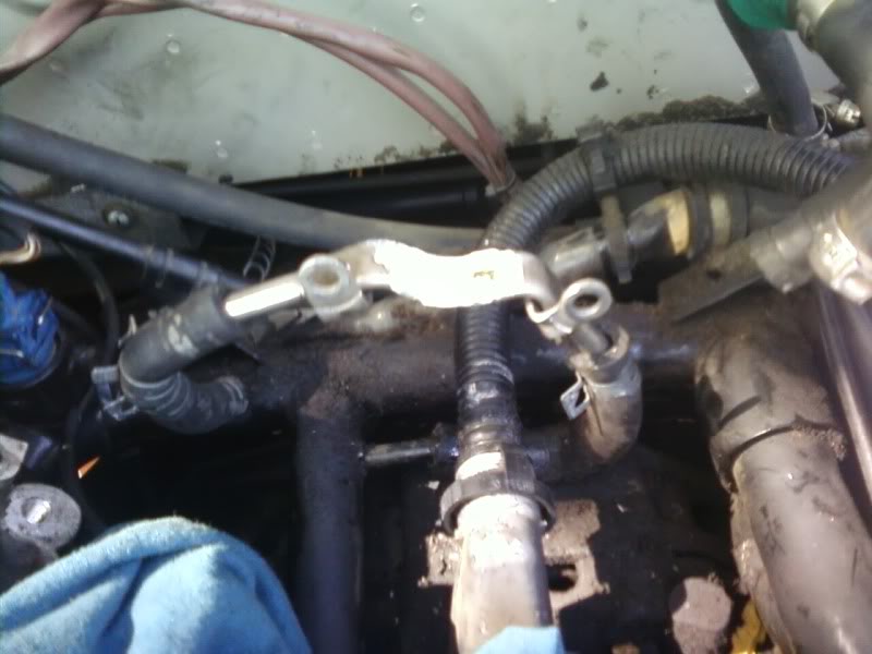

this is all thats stopping me from reassembling ....im tempted to loop them but once i do ill find out were they go
Old May 17, 2009 | 01:20 PM
  #34
imm_audi's Avatar
Joined: Sep 2008
Posts: 26
so it does loop ...lol...f-ing audi i swear wtf is point

Thats the Throttle Body side, no? Bet you 10 its the Throttle Body Heat.. Runs heated coolant to prevent ice. Should have relized... sorry.
Old May 17, 2009 | 09:46 PM
  #36
auditech79's Avatar
Site Moderator
Joined: Feb 2007
Posts: 9,004
From: Nor Cal
Yep, thats the throttle body coolant lines.

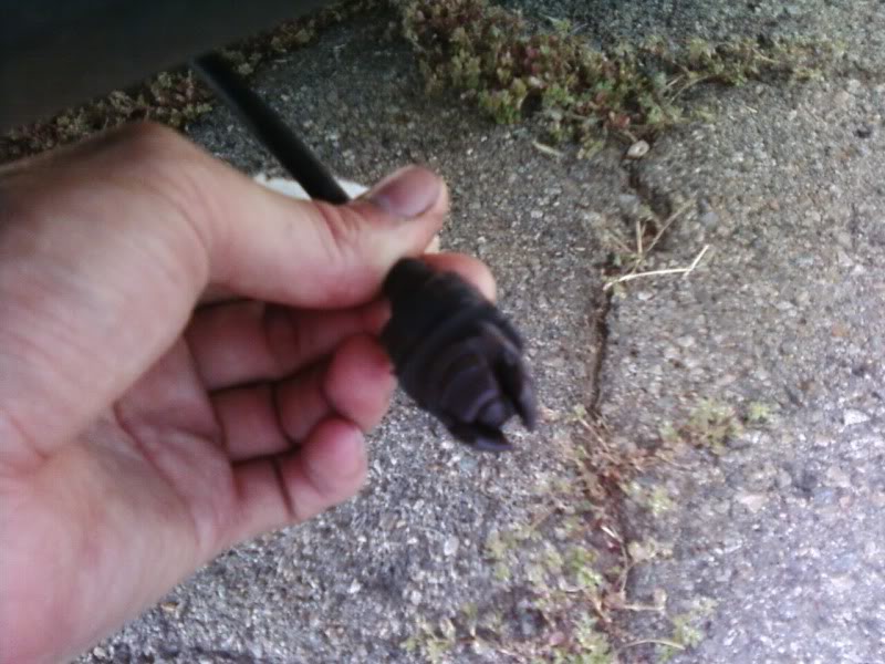

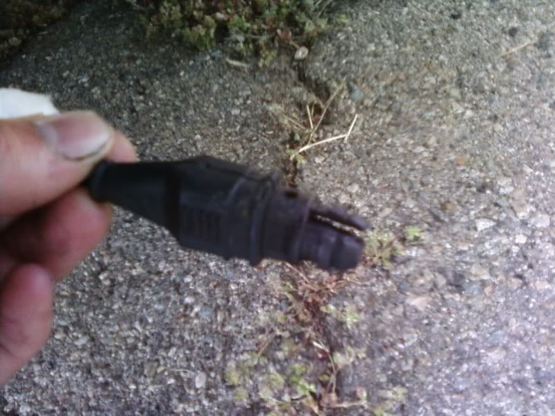

so i've put a 100 miles on her running good needs brakes bled and a few other small things should be my daily driver again real soon i cant figure out where this sensor goes any ideas ?
