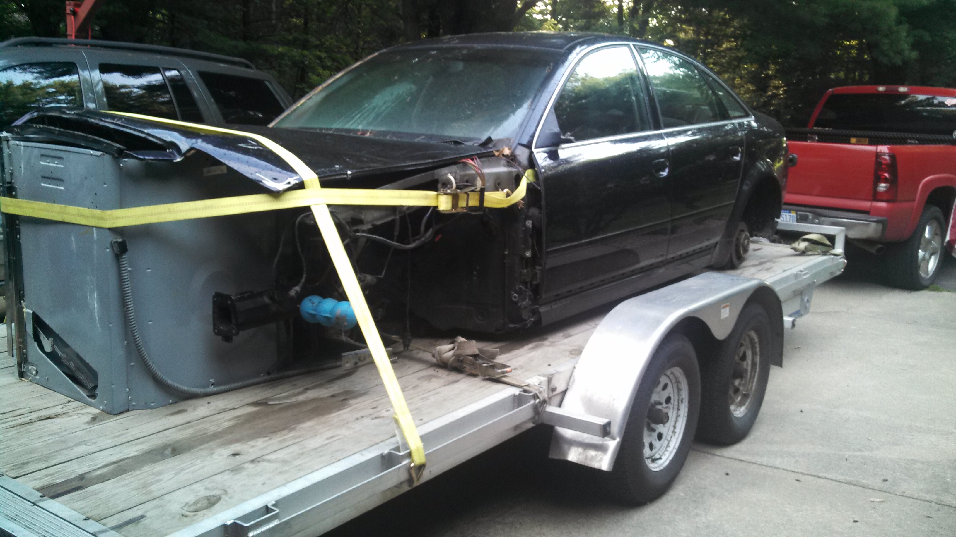

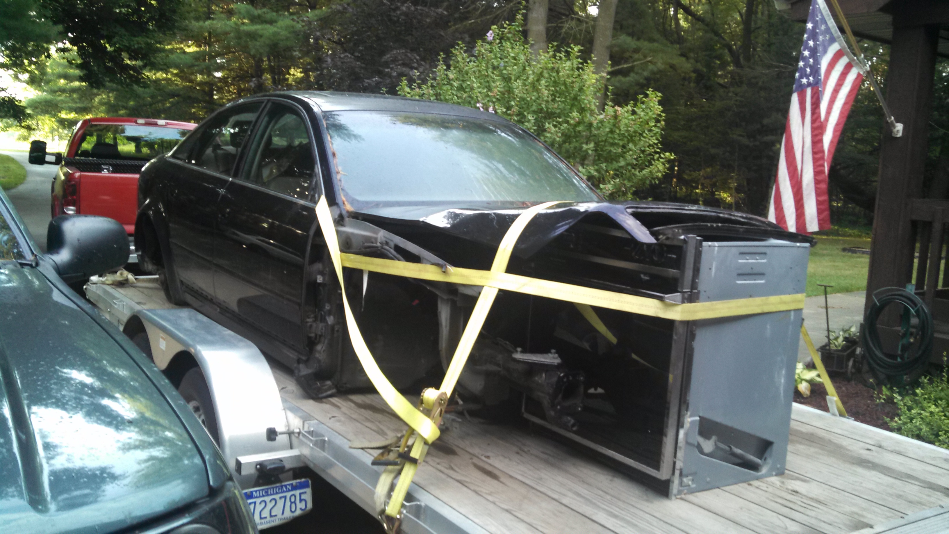

Today started out with removing 2600 lbs of scrap from the driveway. Don't worry we replaced the 4.2l with an oven. 500 degrees on Bake! Also has the self cleaning option.

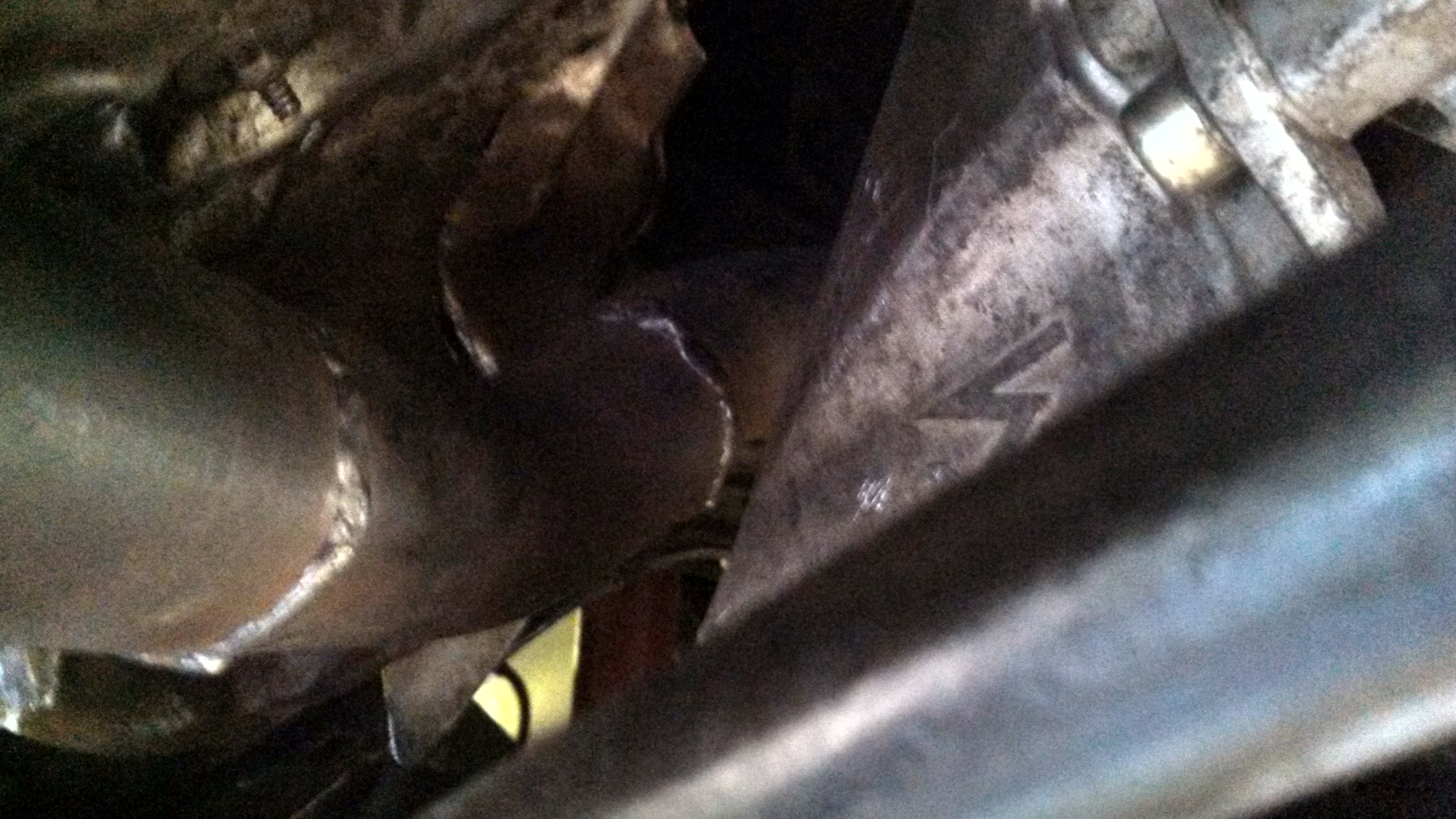

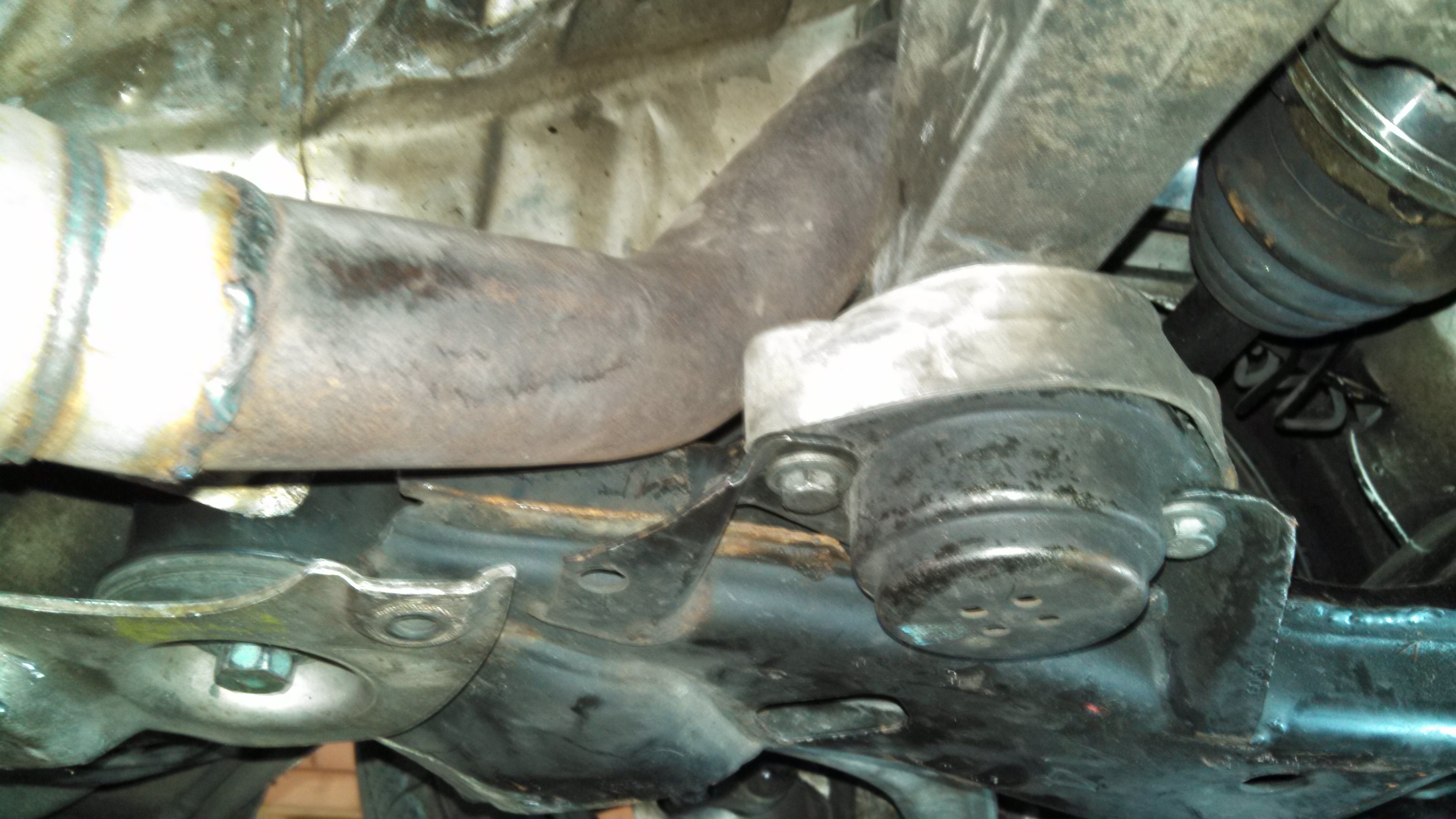

I spent the rest of the day fixing my exhaust. I was informed by previous threads that the 2.8 down pipes would work with the 4.2. They do bolt up, but your cats will be about 1.5" from the ground. The pipes also run extremely close to the transmission mounts.
Before:
IMG_20130723_095258_754_zpsf0ee0cf2.jpg Photo by bshusted | Photobucket

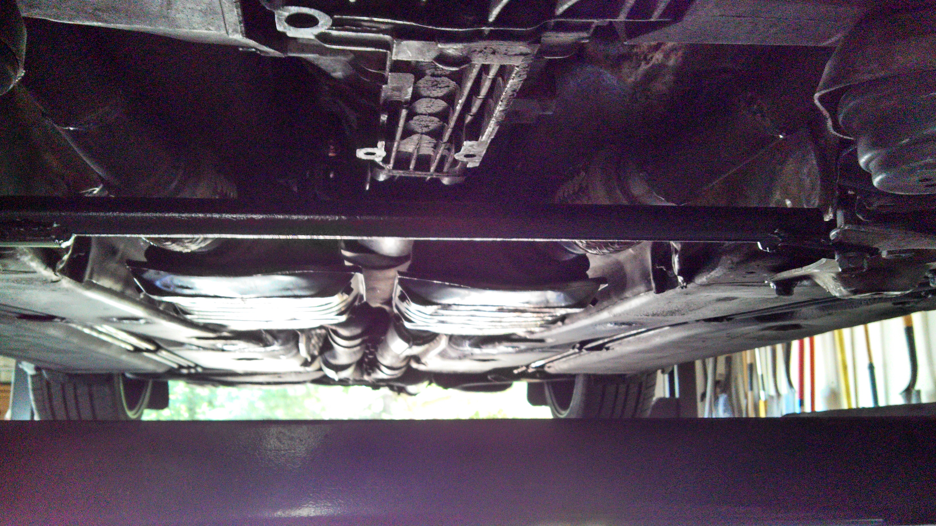

After:
I also welded up a tie bar for the lower subframe mounts. I think the S4 came with such a bar, but I've always wanted to have one on my A4
