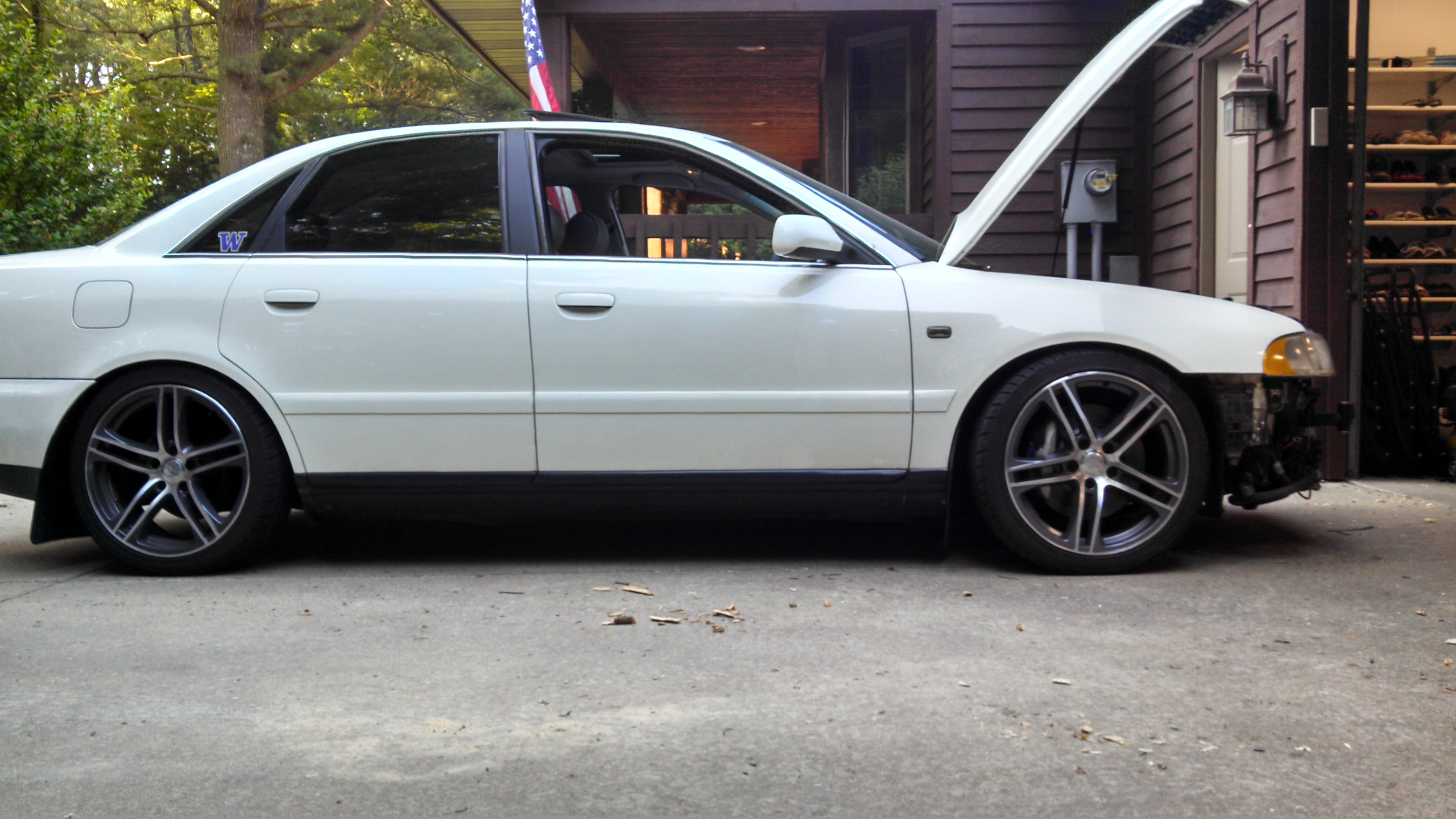

Even though it weighs less, my ride height remains at 25" GTF. I attribute this to the fact that the V8 is longer and therefore hangs further forward of the front axle.
In other news, I drove it approximately 12 miles this morning. Still no fans, but I kept my speed over 40 mph and no issues cooling. Still having trouble with the MAF, but even in limp mode it is a monster.

That sits pretty nicely. I'm guessing this is your only B5, but is it your daily driver, too? Super quick turn around on a swap/build. You're going to have to update your signature again.
Does Washington have any laws you'll have to skirt to pass inspection?

This will be my daily when it is finished. Its shake down run will actually be from MI where I'm doing the swap at a friend's house to WA where I live.
I see no trouble with WA or any other state emission laws. The engine is newer than the chassis that it went into and I retained all original emissions equipment. All that the state of WA does is charge you $15 each year to plug into the OBDII port and the ECU says "It's all good".
Videos will be forthcoming. New MAF is set to arrive today. Even in limp mode with the MAF unplugged, it is WAY faster than the 2.8L 30V it replaced.
