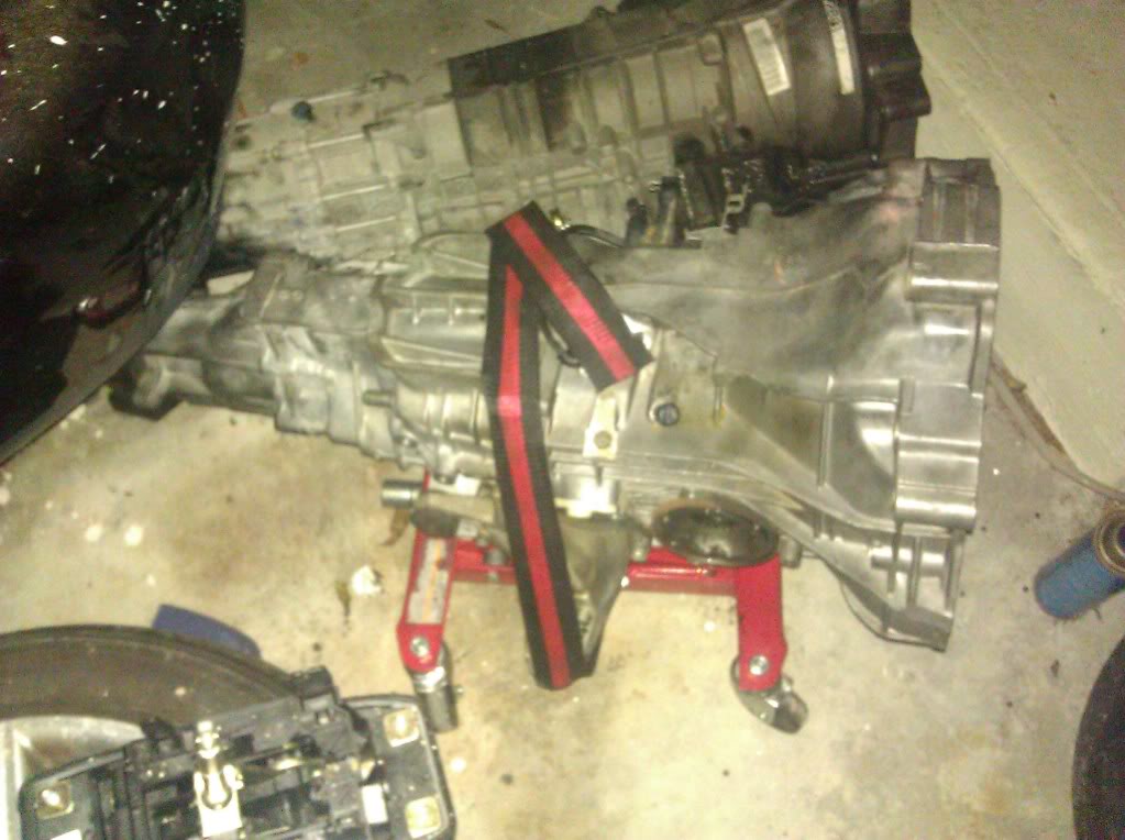

5 Speed swap

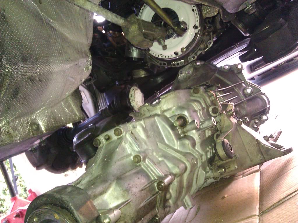

Well I did take the first one back and yup the second one is just as bad. Both axles are like this. I even used aviation spec grease, and there still noisy. They work fine but the tolerances must not be exact. This is the 3rd one on the drivers and the first one on the passenger. you'll see
Thanks

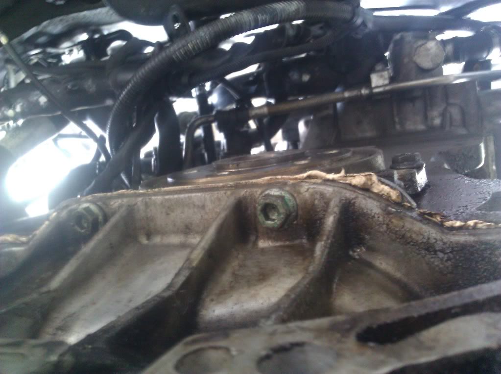

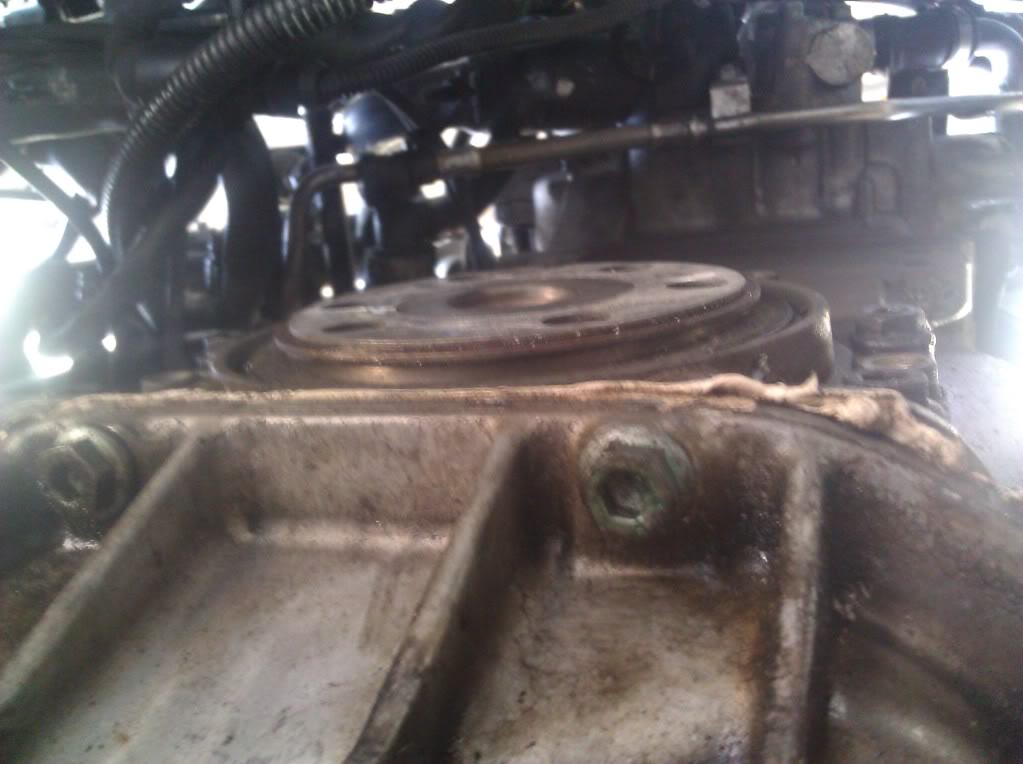

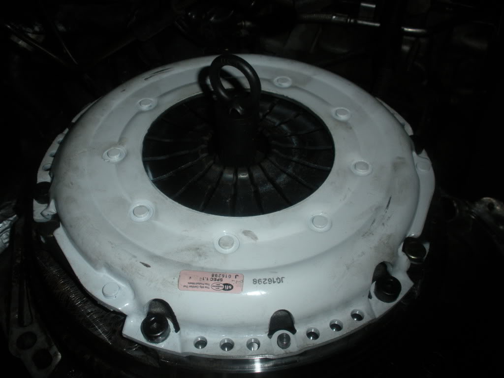

Today was to be the day that I get everything running but due to not getting any pressure plate bolts things were put on hold. Today I did remove the flexplate and shaved the crank. Shaving the crank as shown in Biketsai's thread http://www.audizine.com/forum/showth...ual-Conversion is pretty straight forward. I left the spacers on there (that are already there from the stock flexplate) and just grinded everything down nice and even and inserted my pilot bearing.

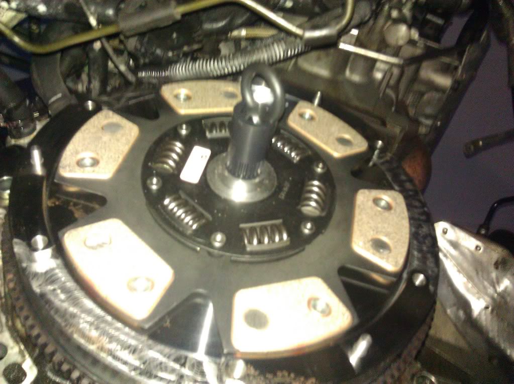

With spacers
Without spacers

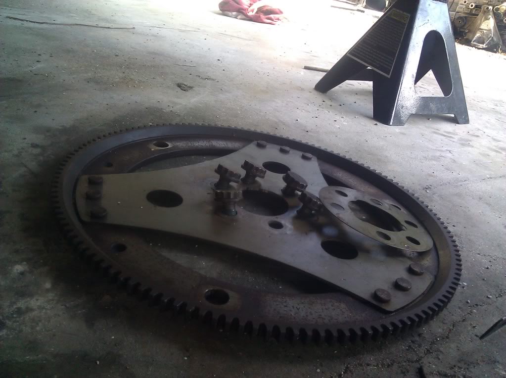

I then proceded to tightening my LWFW. Using a phillips screwdriver I inserted it into one of the holes in the FW so that it wouldn't spin while torquing everything down.
Got everything lined up then no PP bolts

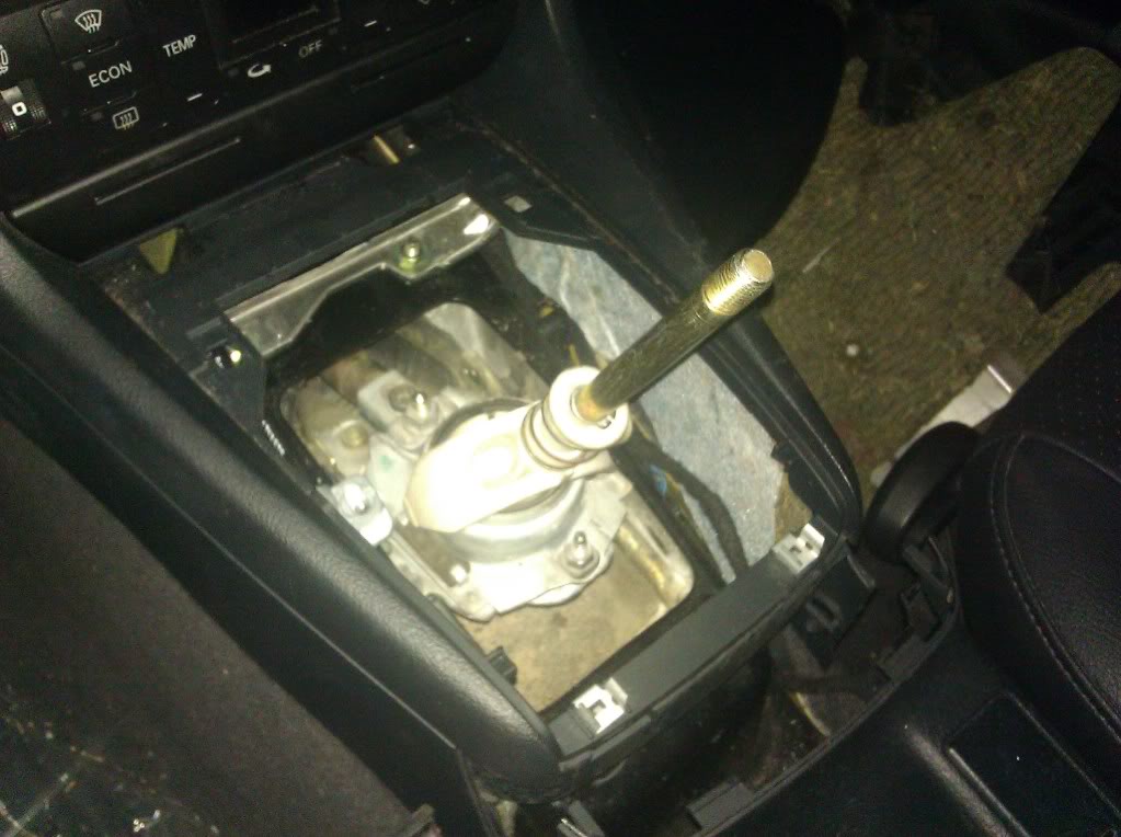

So went inside and installed my shifter box.

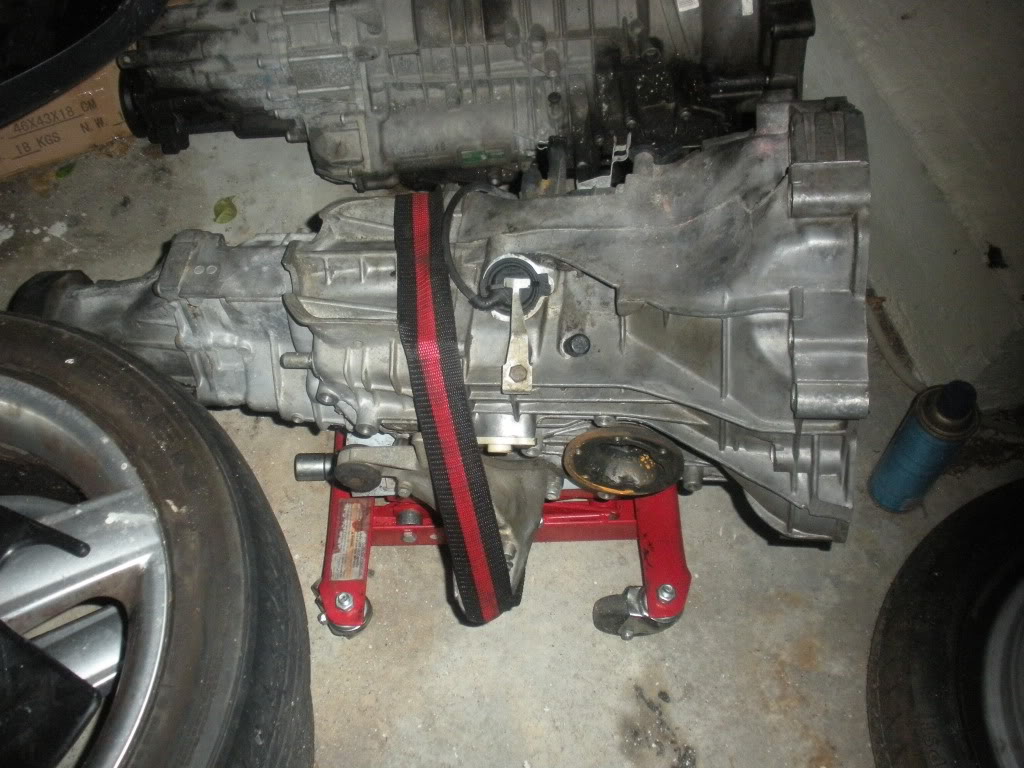

Also super cleaned my tranny (as it was FILTHY) a lot of brake cleaner used here.

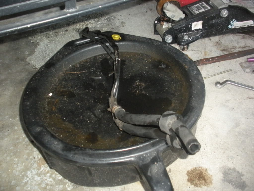

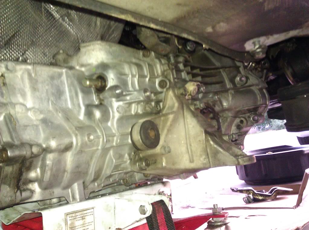

I installed the drivers side 2.8 V6 trans mount and also drained and refilled the transmission. I did not have the special tool for the drain plug so we just tipped it over on its side into my fluid bucket and refilled. Here is the refill plug (on the drivers side)
Installed new pilot bearing and input shaft and output shaft seals.
Hopefully I will have the PP bolts by next weekend so that I can get it all back together. Then I will be installing my ER TIP/TP/Forge DV and doing my TB but at least the 5 speed portion will be done.
With spacers
Without spacers

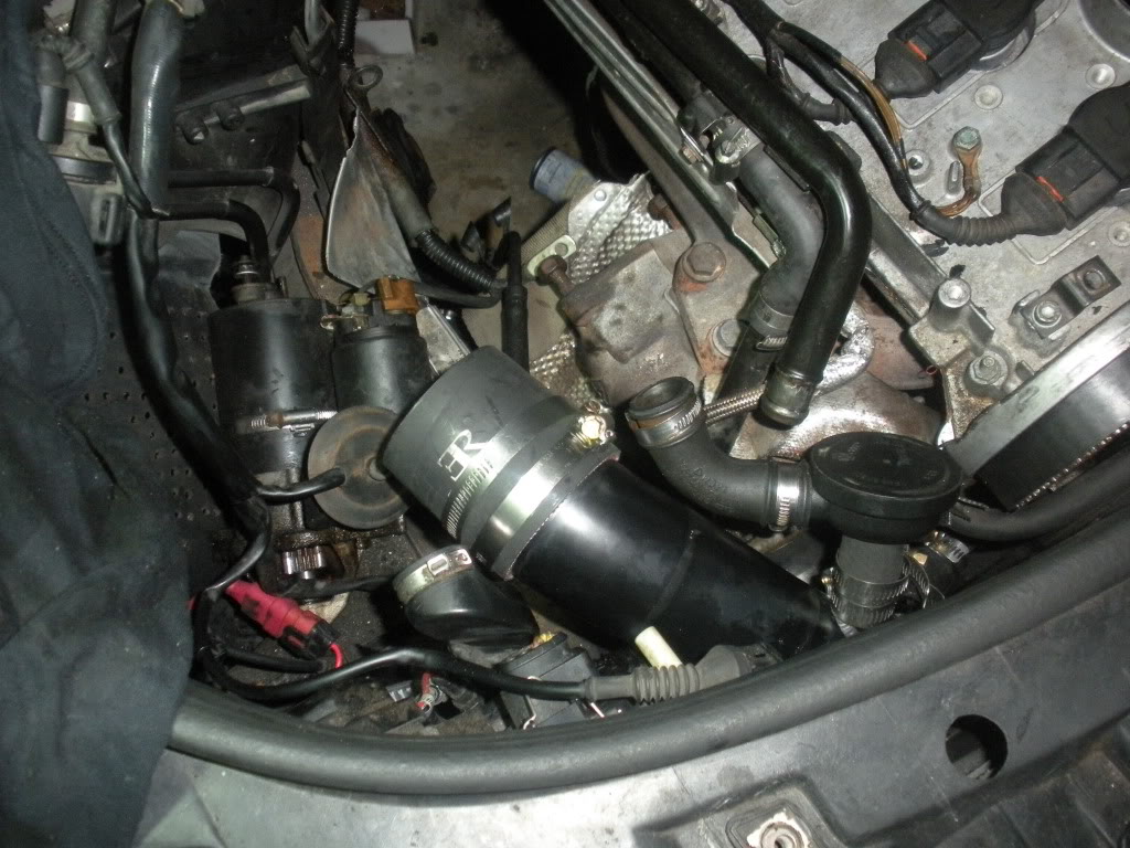

Sorry for the lack of updates got side tracked installing my ER TIP and Forge Splitter (PITA due to all the stock hoses being "cooked" onto all of the stock stuff). Ill update with pics. It's been kind of ugly here weather wise but my plan is to get the trans bolted up and finish it off by Sunday.
Pics
The TIP fits 100x's better w/o the auto tranny cooler lines

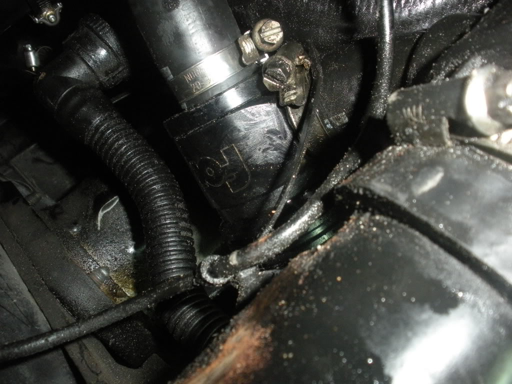

Lined up I ran into an issue where the starter bolts up (seen here) So I used my hacksaw and cut off the metal piece (on the bottom) that is on the motor.

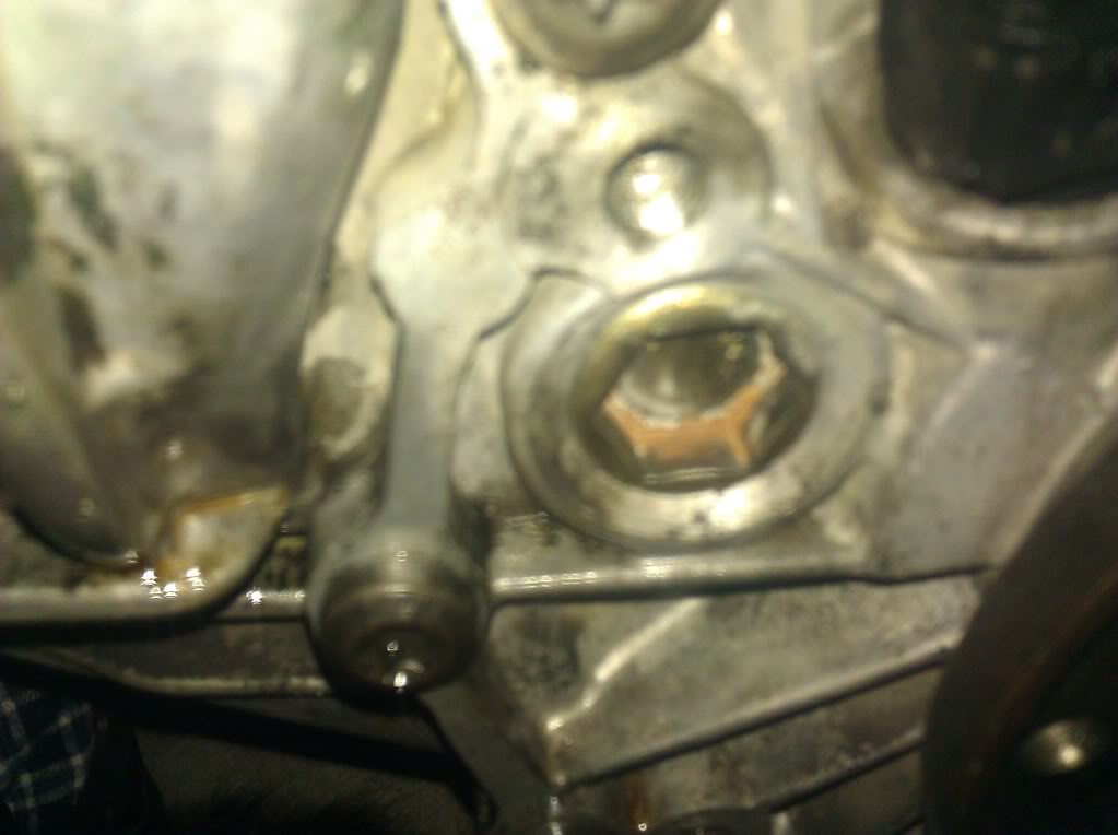

BTW new rear main seal
http://www.flickr.com/photos/49981109@N08/5651474453/http://www.flickr.com/photos/49981109@N08/5651474453/ by http://www.flickr.com/people/49981109@N08/, on Flickr
Old main seal (ouch)
http://www.flickr.com/photos/49981109@N08/5697910188/http://www.flickr.com/photos/49981109@N08/5697910188/ by http://www.flickr.com/people/49981109@N08/, on Flickr

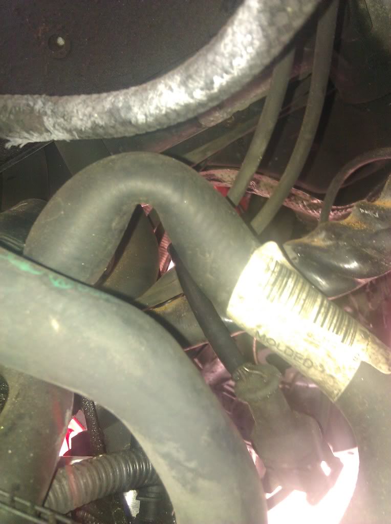

I have been getting rid of all of the unecessary vac lines in the engine bay to clean things up a bit. Had some extra metal laying around so decided to make my own EVAP block off plate
