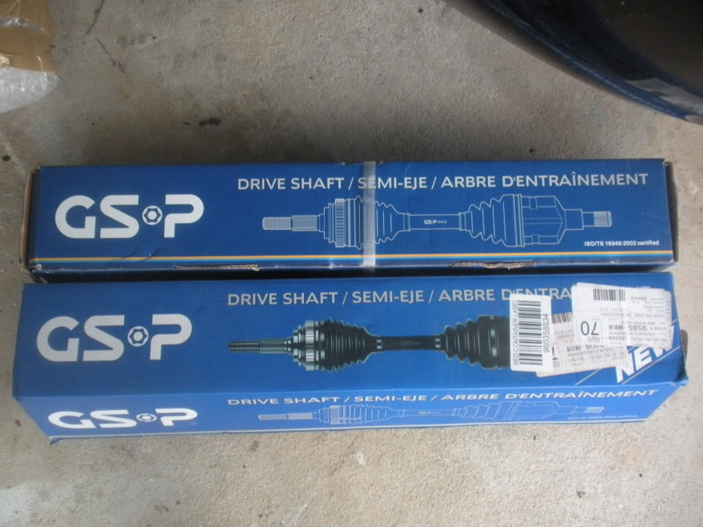

Brand new 5 speed axles (front) I dont think rears are necessary-correct me if I'm wrong.

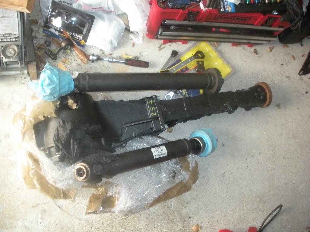

Diff and d/s

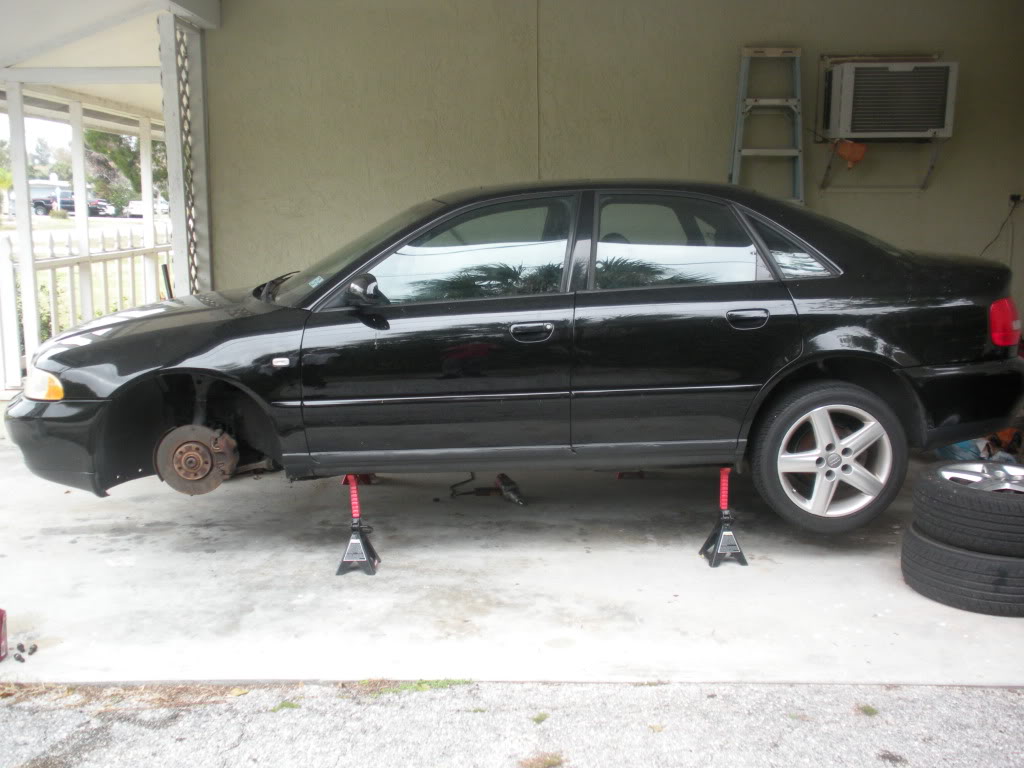

Unplug your battery kind of important lol

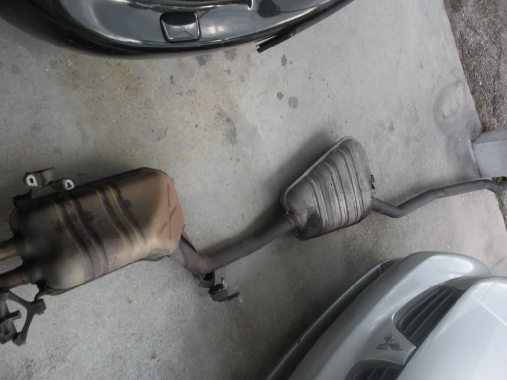

Started off droppping the exhaust like I said pretty self-explanatory.
heres a pic (very heavy piece)

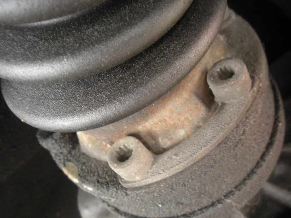

Next with a 12pt triple square tool I unbolte the front axles (I ripped the CV boot being dumb). Also removed the heat shield as seen in pic

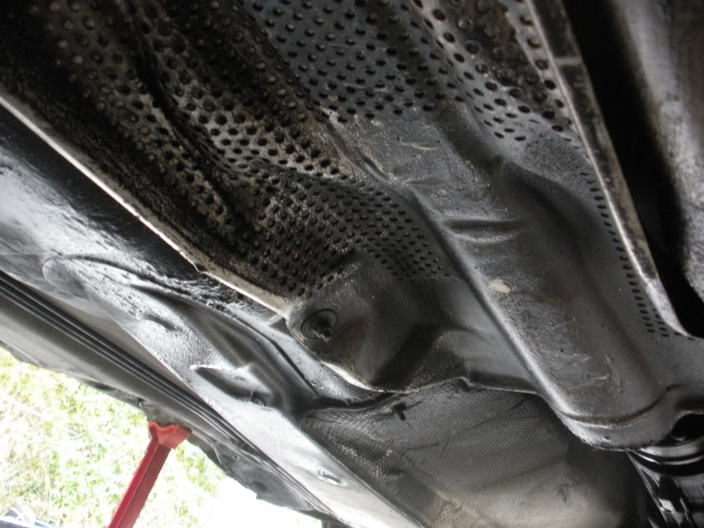

With the exhaust out of the way things should look like this. Remove the heat shield shown in these pics to gain access to the driveshaft.

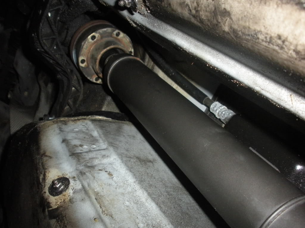

For this step I would recommend a friend (if you don't have any be prepared for a lot of back and forth). Use the ebrake to stop the DS from spinning on you when getting the bolts off
(be VERY careful not to strip these out!!)

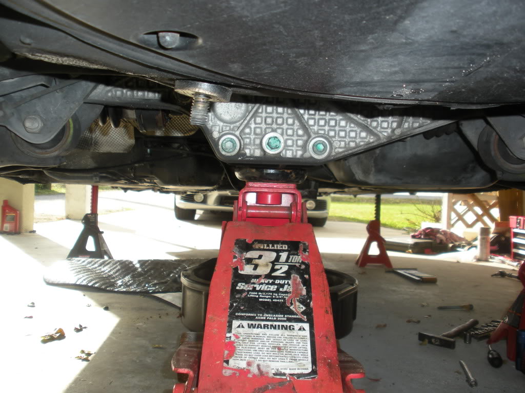

At this time place a jack under the diff

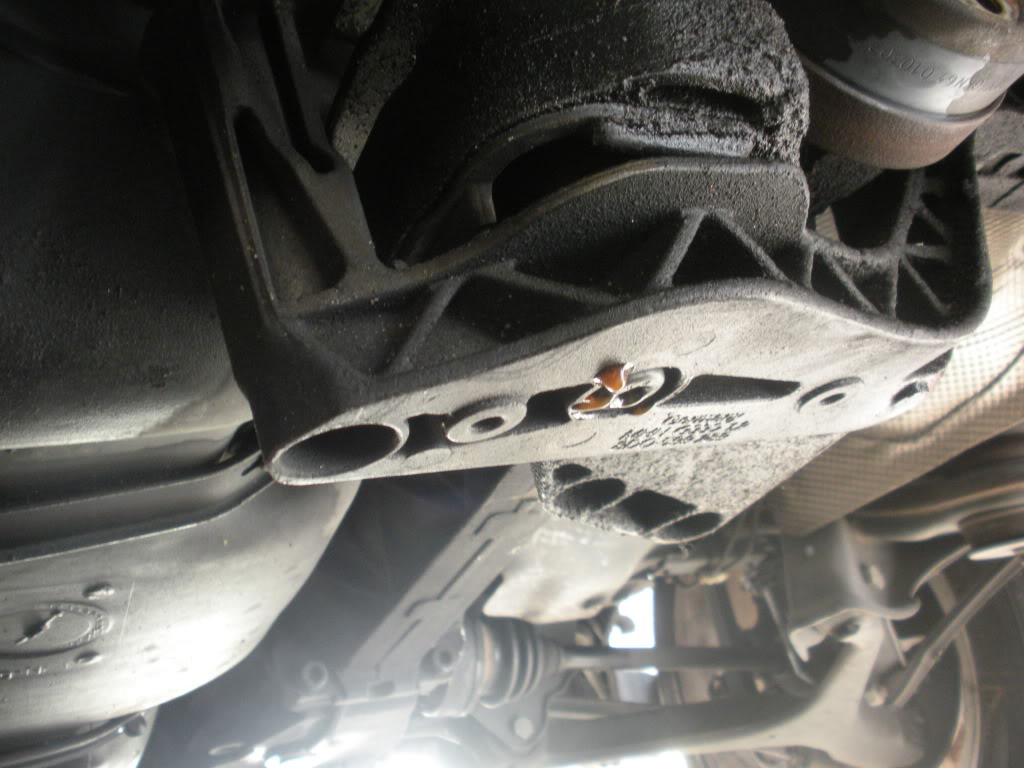

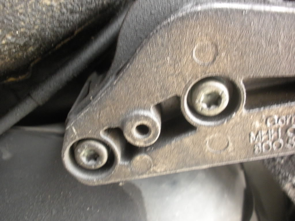

There are a few mounts holding this bad boy in here are a few pics (I think I got all of them pictured)

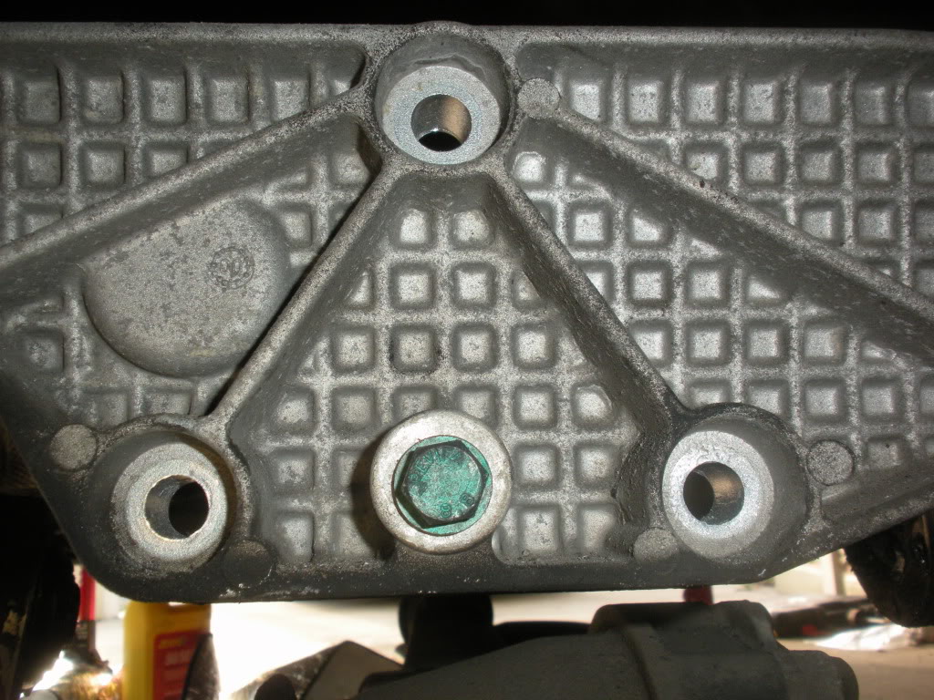

Making sure that the diff is still on the jack start taking out these three bolts (carrier)

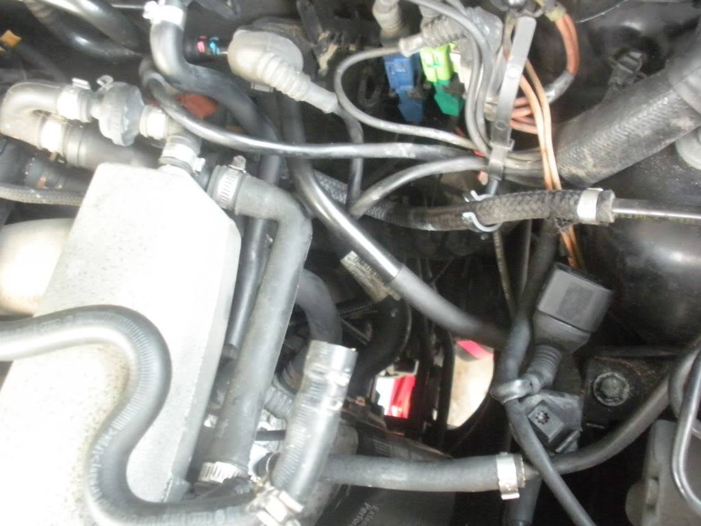

Next you will want to take the downpipe off so that you can get to the tranny to engine bolts
(messy I know) to get here you will need to take out your airbox and move some things around but its pretty straight forward. Also I unplugged my O2 sensors you may want to take them off of the piping up to you.
(O2 plugs are on the drivers side on the firewall follow them from the sensors themselves)
