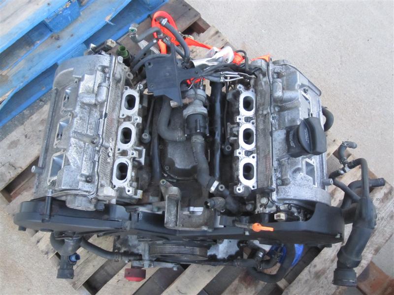

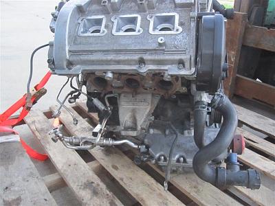

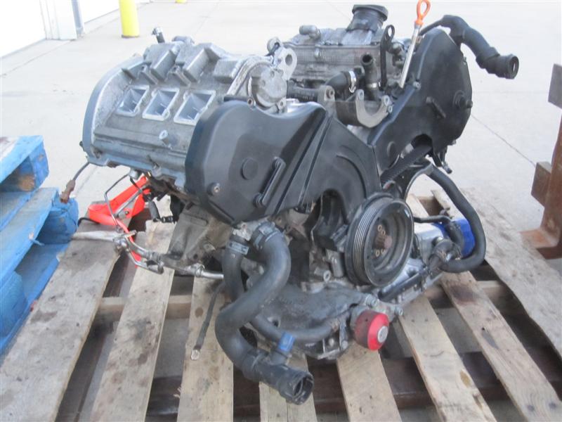

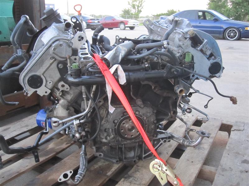

I guess it makes the thread a little more interesting if there are pictures. Here is the motor without turbos, accessories or anything as I purchased it.
The block is completely stripped and out for machining. No clue when it'll be back.
