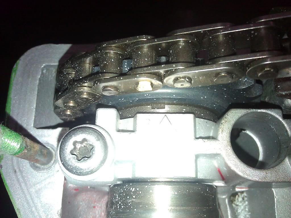

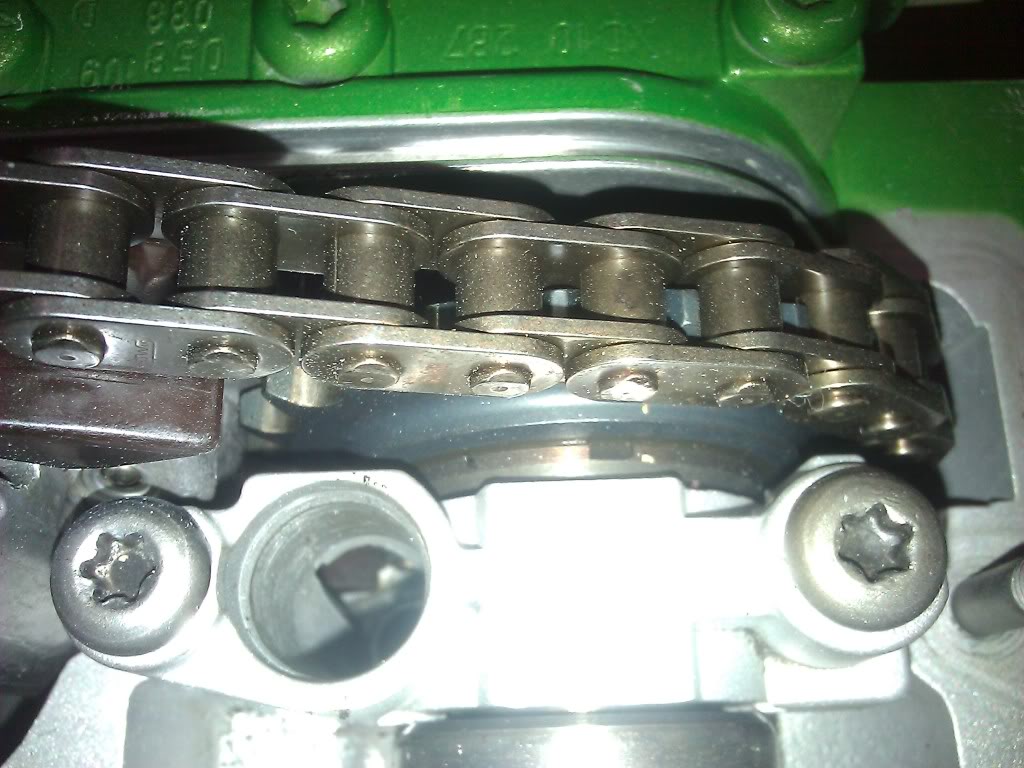

cam marks should look like this. if you are unsure of you cam timing post pics of these marks. disclaimer- my photos are from my enigne which is a 4 cylinfer but the 2.8 is the same damn thing. marks will look the same

I just looked there I kinda seen and red what the picks are that you are showing me now the arrows should be pointed at cam windows and the crank on timing mark then the time is right is that how it gose
