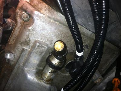

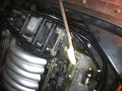

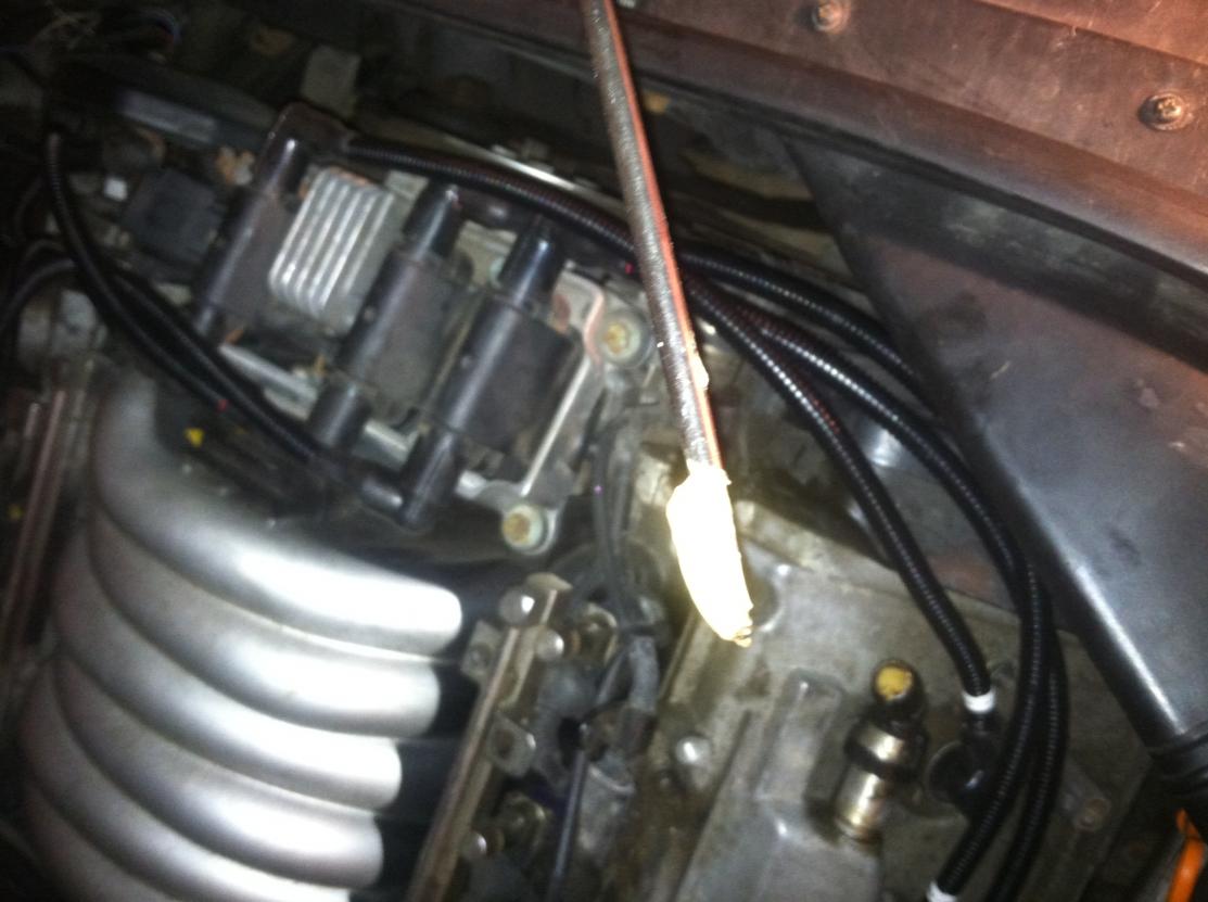

HOLY S*&t that hose is clogged???? What is that stuff in it?? Can't really tell from the pictures....but I'm going to guess it's condensation (oil/water)
The car will have to re-adapt now, don't jump to conclusions about the MAF - yet...it's been running with that damn hose clogged for so long...here's a way to manually reset the throttle body I think, you may need to google it, reset the throttle body:

At least there's a change, not a good one, but it means you're getting closer to fixing it. Really, you are.....

When you look at the MAF, you should actually be able to SEE the little filament in it, you may also see dirt...if you don't see a little filament in it, MAF is definitely broken....
It looks like water/oil (probably condensation). Have you checked the oil? Drained it a little? Is the color the same?
Check your oil filler cap as well, there may be a little there too. You could probably get some oil detergent and run a tank of gas through it, that should help clean it out when you drain your oil for next oil change
You may also have a bunch of water in your SAI pump.....

Markymarc is dead-on in his help so far. I want to add an observation - all your misfires are on the passenger side bank. You need to verify that your physical (mechanical) timing is correct. It's possible that your cam sprocket may not be timed right due to improper install of the timing belt or due to a worn cam chain tensioner.
You make no mention of this but at cold start do you hear a shop-vac whine from the area below the passenger side headlight? You could have a bad SAP.
For the manual reset of the throttle sensor, turn the key on and let it sit a minute. Shut off for five minutes. Repeat 2x more. That'll get your thrlttle sensor about 90% of the way home , and the rest of the adaptation will happen during driving.
