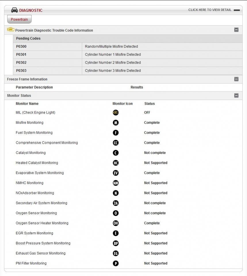

Here is what the INNOVA OBDII Scanner said. I was wondering if VAG-COM might be able to give me more specific info regarding what is wrong or would it pretty much just give me the same codes of misfire?
