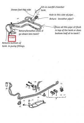

Hi everyone, Im just wondering if anyone could help please and has ever changed a pump in a 1999 Avant 2.5 tdi Quattro. I changed the pump last week and was running ok ish but I now have a few doubts. Im also looking for info on how the fuel tank pipes lay inside the tank. I found a diagram which looks the same as A4 piping but could be of the A6 tank pipes.

Im just wondering if the piping should all sit in the top of the tank flush as best as i can get it, bearing in mind its a nightmare connecting the (return flow) 3 pipe T piece to the underside of the green top sealant cap.
The 2 pipes which run into the otherside of the tank chamber which run parallel with the pipe that draws the fuel out of that side, I was told that the other pipe was a breather but had a long end and i dont know if it should be angled straight down into the tank of fuel or just in mid air.

I shall find out today when the lids off. Ive attached a pic of pipes. Any info appreciated. Sorry for the long post. Maybe ive answered my own questions but I need to get it sorted. I will update here with results. Thanks in advance.
Attached diagram of pipes etc.
