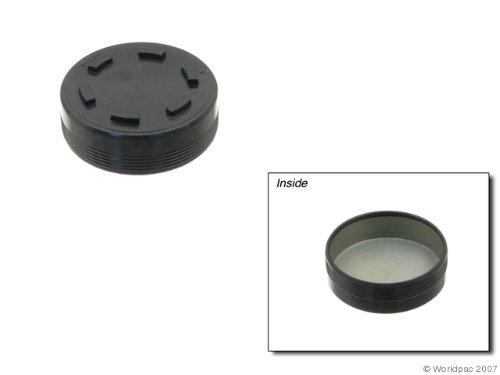

Originally Posted by FishEye
ohhhh ok so basicly u gotta try and pry the old one off or break it or something right? also can i put some sillicone sealant on the new cap? or just put it in dry?
yeah, the cap looks like this
as you can see on the back of the head it sticks out a little bit, just enough to jam something in there to pull it out.
i used some sealant but it turns into a mess quickly so don't stress, take your time, and push the new one back in.
will be a lot easier if you remove the valve covers, just be mindful of any dirt/debris
